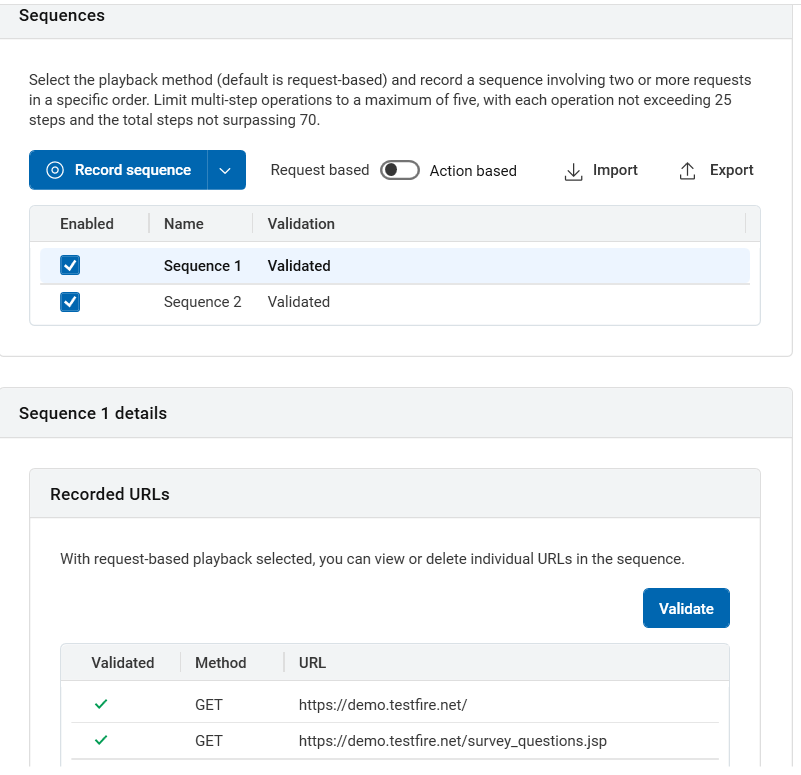

The request based sequence appears in the Sequence pane (upper right). Sequences are automatically named in order: "Sequence 1", "Sequence 2" etc., but you can rename by typing into the name field.
Click Validate.
AppScan replays the sequence, and a green check-mark appears next each request or action that is successfully replayed. If a request or action is not successful a red X appears next to it. Options:
- Remove any unnecessary step by selecting it and clicking
. After doing this click the Validate button, to
check that the sequence still keeps in-session. - Right-click on a step in the sequence and set to Don't Test. The URL will still be included when playing the sequence, but will not be tested individually.
- Right-click on a step that is set to be tested individually, and select Play sequence before testing request > No if it is not necessary to play the previous steps in the sequence each time this URL is tested.
