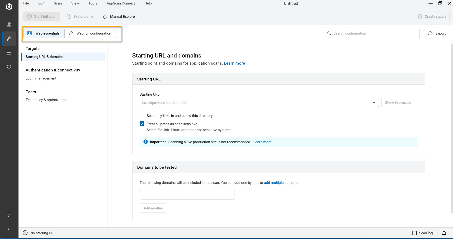

Configuration presets
Presets give you the main configuration views needed for a particular type of scan.
The presets at the top of Configuration view give you access to the most common configuration
options. Based on the scan type selected, the options for configuration are displayed.
Choose from:
