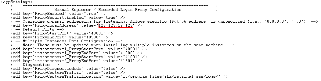

  • By default, the proxy listens on the IP address where the request is received. The proxy IP address might need to be configured in the web.config file of the computer where the Enterprise Console is installed (located at c:/program files/hcl/appscan enterprise/webapp). Use the "ipconfig" command line prompt (through the computer's Start > Run menu) to display all the IP addresses used on the Enterprise Console machine. Specify the proper IP address in the ProxyLocalAddress key as highlighted in the following example:webconfig file
    1. You might need to restart IIS after you have edited the file.
    2. You might need to try all the IP addresses on your computer to see which one works.
