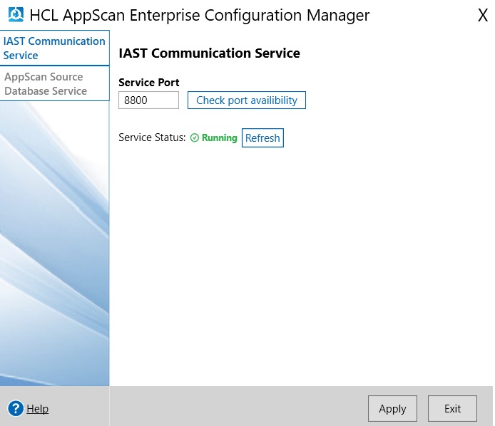

    The HCL AppScan Enterprise Configuration Manager dialog box having the IAST Communication Service section is displayed.

  2. Configure the IAST service properties as described in the following table:
    FieldsAction
    Service Port Enter the port number of the machine where you want to install IAST service.
    Check port availability Click this option to validate whether the port is available for installing the IAST service.
    Depending on the port availability, you can see the following options:
    • Port available - Indicates the port is available for installing the IAST service.
    • Port unavailable - Indicates port is not available. Hence, you must try entering another available port number for IAST service.
    • In use - Indicates a port number that is already utilized by an IAST service.
    Service Status Indicates whether the service installed on this port is Running or Not running.
    Refresh Click Refresh to know the latest status service running on the port.
    Apply Click to apply the configuration changes for running the IAST service and communicate with AppScan Enterprise application.
    Exit Click to exit the configuration manager.
