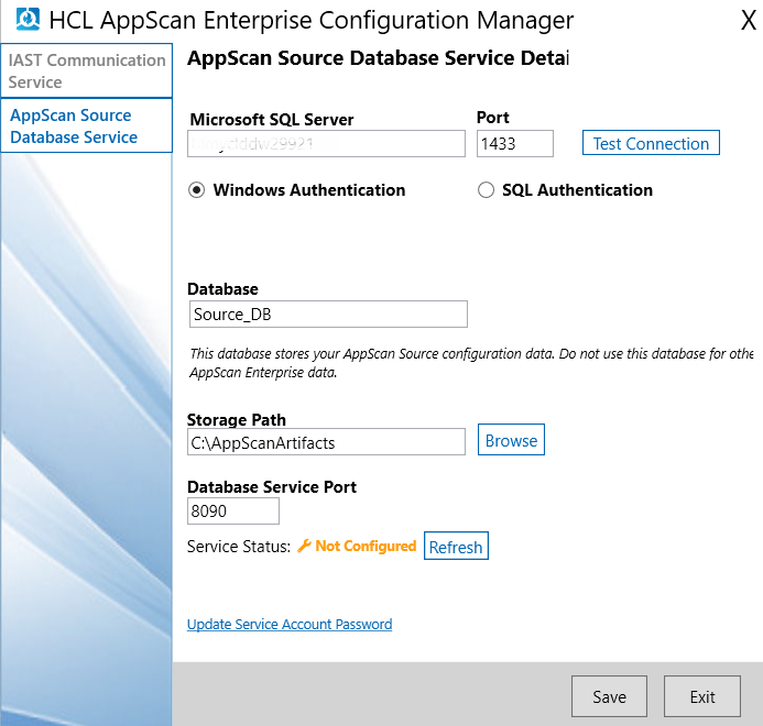

    The HCL AppScan Enterprise Configuration Manager dialog box having the AppScan Source Database Service Details section is displayed.ASoC_DBService_Details
  2. Configure the database service for AppScan Source as described in the following table:
    FieldsAction
    Microsoft SQL Server Enter the Host name or IP address of the Microsoft SQL database server.
    Port Enter the port number of the machine where the Microsoft SQL server is running.
    Test Connections Click to validate the connection response of the Microsoft SQL server you are configuring.
    Authentication for SQL database AppScan Enterprise supports Windows Authentication and SQL authentication to connect to SQL Database. Refer to Microsoft's article on Authentication Mode and choose the authentication mode that fits your requirement. You can change from one authentication mode to another, but make sure to re-run the configuration manager for the changes to reflect.
    Windows Authentication is the default authentication mode to make a trusted connection to SQL Database where the user identity is confirmed by Windows.
    SQL Authentication uses logins created in SQL Server that aren't based on Windows user accounts. Both the username and the password are created by using SQL Server and stored in SQL Server.
    The user must be assigned a sysadmin server role on the SQL server. The user must also have access to the database and must be granted a minimum of db_ddladmin, db_datawriter, and db_datareader rights or the db_owner rights.
    Database
    Enter the database name that is used by AppScan database service. If the database name you are specifying here is not existing, then a new database with the same name is created in the database server.
    The database name you enter must be case sensitive and unique. It should be a different name other than the database used by AppScan Enterprise server.
    Storage Path
    Enter the path where AppScan database service saves the files related to AppScan Source. AppScan Source related files are stored in the database as meta-data, and also in the file-system (actual files).
    You must not modify the storage path which you have entered during the initial setup. If you change the storage path, then the data stored in this path gets corrupted.
    Database Service Port Port number where you run the AppScan Database service. If you change this port number, then you must restart the AppScan Enterprise service to apply changes.
    Service Status
    Indicates the current status of the AppScan Database service. You may see one of the following status scenario:
    • Not Configured - If the service is not yet created or configured.
    • Stopped - If the service is configured, but not running.
    • Running - If the service is configured and running.
    Click Refresh to retrieve and display the latest status of AppScan Database service.
    Update Service Account Password Click to update the Log On password of the AppScan Enterprise service account for the database service.
    Save Click to save the configuration details of the database service and restart the database service to apply the updated configuration for database service.
    Exit Click to exit the configuration manager.
