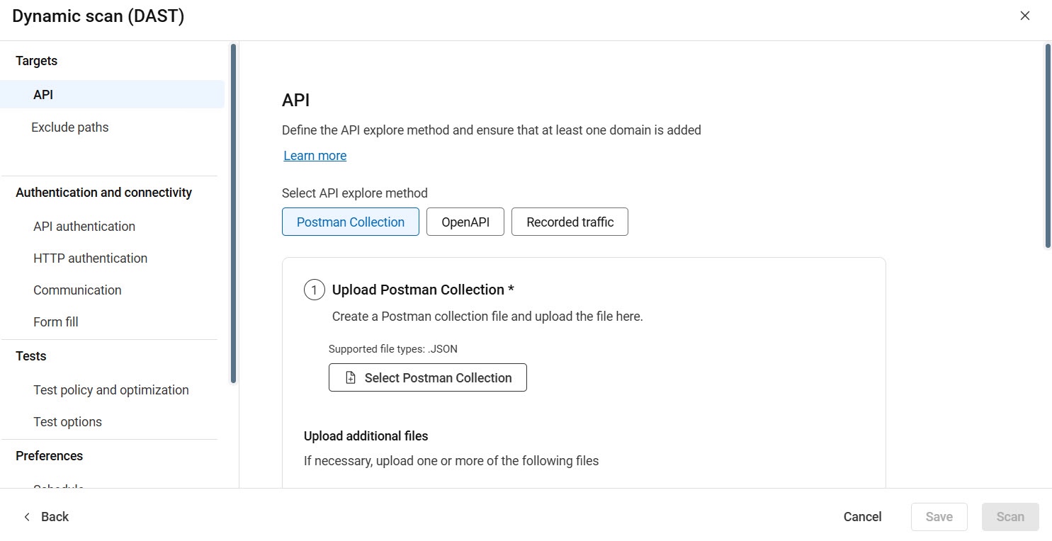

    Select the API explore method: Create scan showing API explore configuration
    Setting
    Options
    Upload Postman collection or OpenAPI or Upload recording
    Using the API explore method, you can upload Postman files, an OpenAPI specification file or URL (including the Base URL), or a traffic recording.
    AppScan 360° limits file uploads to 2GB.

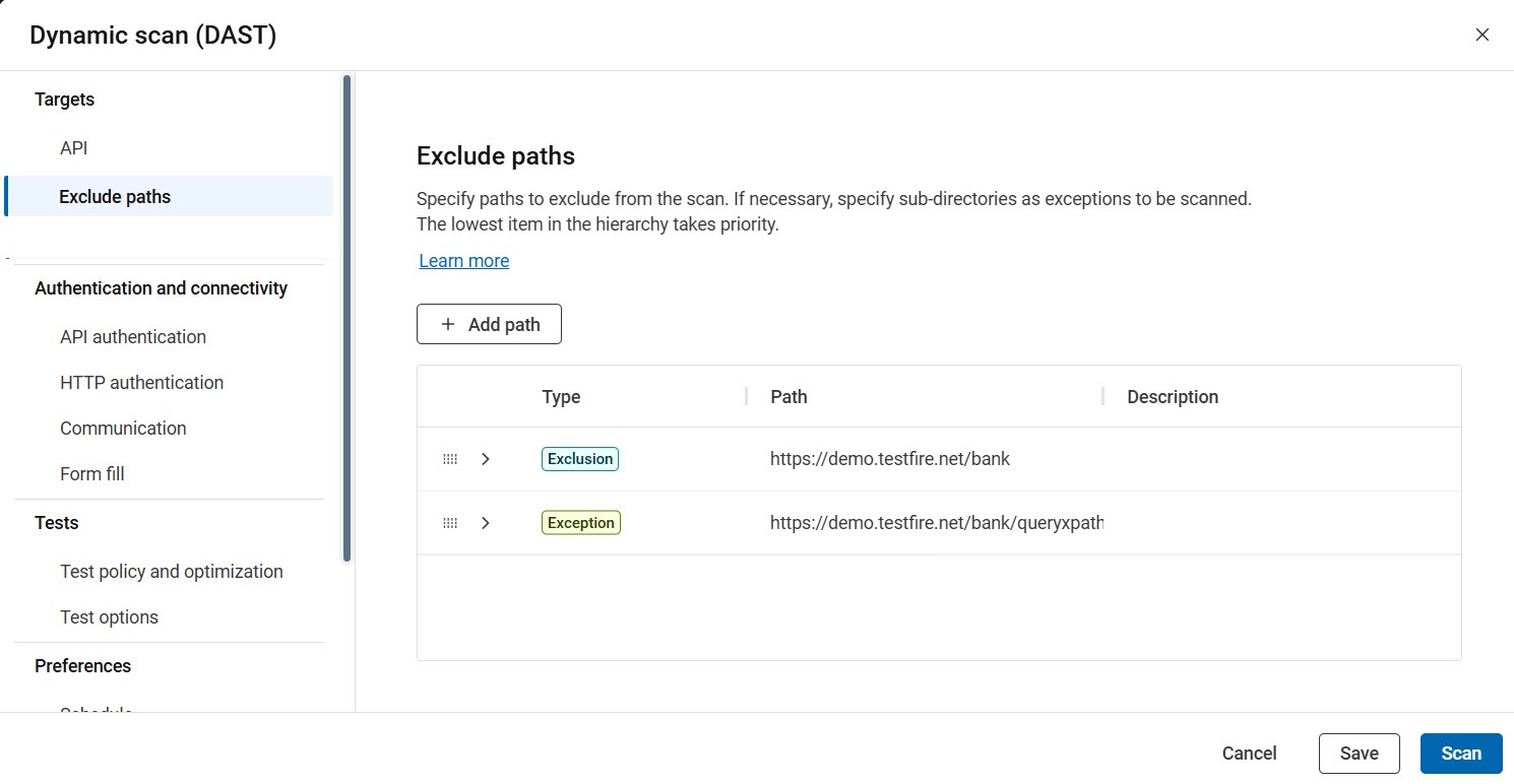

  4. Targets: Exclude paths
    Exclude certain paths in the API from the scan. You can filter the scope of the automatic Explore stage by adding URLs (full paths, which may include queries) or Regular Expressions to the Excluded paths list. Possible reasons for doing this may be:
    • Because they are still under development and you know they are problematic and do not want to scan them right now
    • Because you know they are not problematic and you want to reduce scan time
    • To reduce scan time by restricting the scan to certain parts of the application
    You can also include certain paths to be scanned as an exception to the excluded path.
    API scan configuration showing exclude paths
    Setting
    Options
    + Add path
    Displays options below the list to add a path as an exclusion or exception to the scan.
    Exclusion Listed paths are excluded from the scan. Any link that matches a path configured to be an exclusion is filtered out of the scan.
    • Path: Type a path or regular expression. If the path is a regular expression, select the RegEx toggle button.
    • Description (Optional): Add a description to be displayed in the Exclude Paths list.
    • Exclusion: Select the radio button to add an exclusion and click Add. The listed path and its subdirectories will be excluded from the scan, unless you define any exception.
    Exception Use to include a specific a directory or a file within a path that was excluded higher up in the list.
    • Exception: Select the radio button to add an exception to a specific directory within a path that was excluded higher up in the list and click Add. The listed path will be included in the scan. Note that the Exception must be below the Exclusion to take effect.
    • Use Exception only needed when you want to include a directory or a file that is within a path that you have excluded. For example, if you have excluded: https://demo.testfire.net/bank you could then add https://demo.testfire.net/bank/queryxpath.jsp as an Inclusion, lower down in the list, to include that subdirectory in scans.
    • If you add Exclusions between the Explore and Test stages of scanning, AppScan will not test the excluded paths even though they were explored.
    • Where there is a conflict between two items in the list, the lower item takes priority. Click and drag the item in the list to move them up or down and adjust the order of items as required.

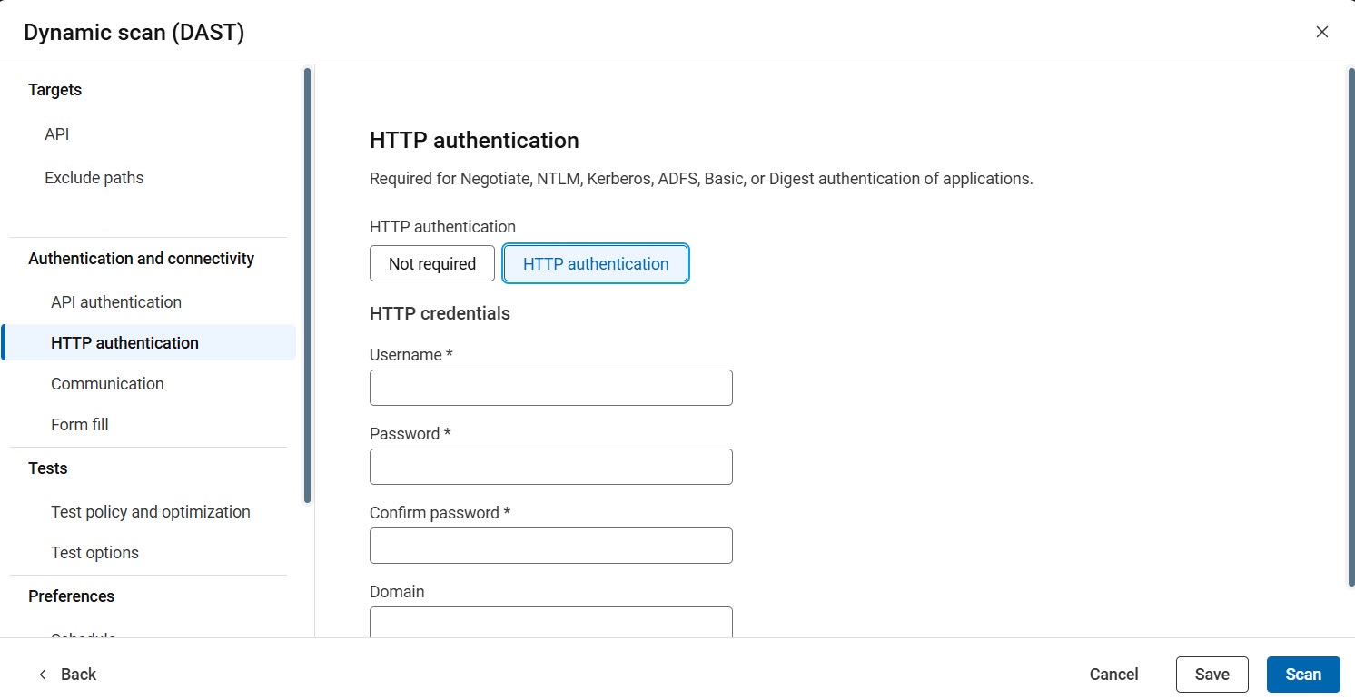

  6. Authentication and connectivity: HTTP authentication
    In addition to the login information, indicate whether the application requires HTTP authentication (Negotiate, NTLM, Kerberos, ADFS, Basic, or Digest). Enter the Username, Password, and Domain (optional) for AppScan 360° to use during the scan.

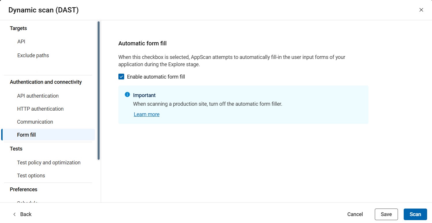

  8. Authentication and connectivity: Form fill
    When enabled, AppScan 360° uses the AppScan Standard default automatic form fill parameters to complete forms automatically during the scan. This cannot be changed using the wizard.API configuration showing enable form fill option
    Setting
    Options
    Automatic form fill
    AppScan 360° uses AppScan Standard's default form fill parameter values to fill and submit forms during the scan.
    Note: If you turn off automatic form fill and scan in AppScan 360°, it will remove all the information filled in the forms except for the login management data. AppScan will not fill in the forms automatically during scanning. When you import this scan into AppScan Standard, automatic form fill is enabled, but the form filling data, except for login management, will be empty.

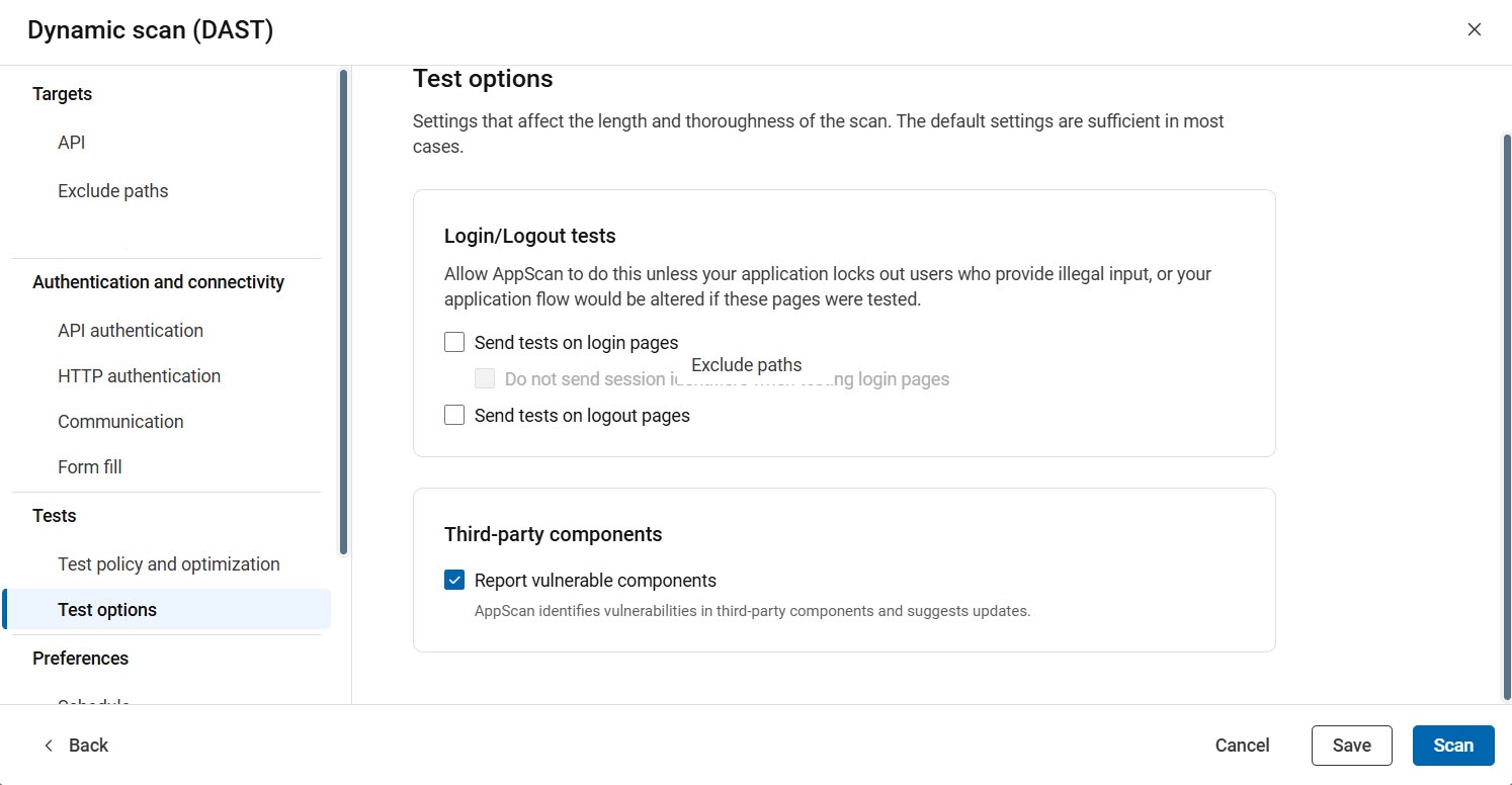

  10. Tests: Test options
    Choose whether to send tests on login and logout pages. If you choose to send tests on login pages, specify whether to send session identifiers.API configuration showing test options
    Setting
    Options
    Login/Logout tests Choose whether to send tests on login and logout pages. If you choose to send tests on login pages, specify whether to send session identifiers.
    Report vulnerable components AppScan finds vulnerabilities in third-party components and recommends updates.

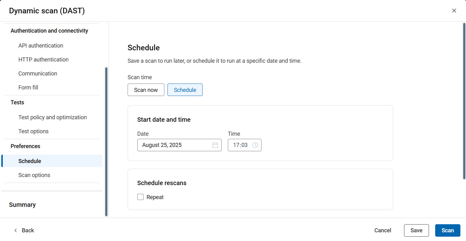

  11. Preferences: Schedule
    Specify when the scan runs: now, later, or on a schedule.API configuration showing the scheduling options
    Setting
    Options
    Scan now
    Your scan runs as soon as setup and review are complete.
    Save for later
    Your configuration is saved when completed. You can run the scan later.
    Schedule
    Your configuration is saved, and one or more scans run as configured:
    1. Select a date and time. Enter these according to the time zone configured on your machine, but note that times will be converted to UTC when displayed in the user interface.
    2. To run the scan more than once, select the Repeat, and then choose:
      • Daily, and select a daily interval (1-30 days)
      • Weekly, and select which day, or
      • Monthly, select a monthly interval, and then select which numerical day of the month, or which weekday of the month (first, second, third, fourth, last).
      Note: If the maximum number of concurrent scans are running when the scheduled time arrives, the scan starts as soon as allowed by your subscription.
    3. Set the End date (the last date a scan will run), or click Remove end date to have the schedule run indefinitely.
