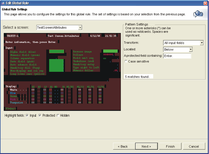

      When you select All input fields for the Transform option, the first input field that matches the criteria determines the scope of the search region for subsequent fields. The example below shows the fields that are considered matches for all input fields below a protected field containing the string Enter.. The Global Rule Settings wizard highlights all of the matching fields. The first match is the field with the caption Alpha field (blue). The start and end columns of this field determine which fields below it are also considered matches. Notice the fields with captions Numeric field (green) and Column separators are not considered matches because they are either longer or shorter than the first matching field. The field with the caption Date field (pink), and the three fields immediately below it, are considered matches because they have the same start and end columns as the first matching field.
      Figure 1. ZIETrans global rule example
