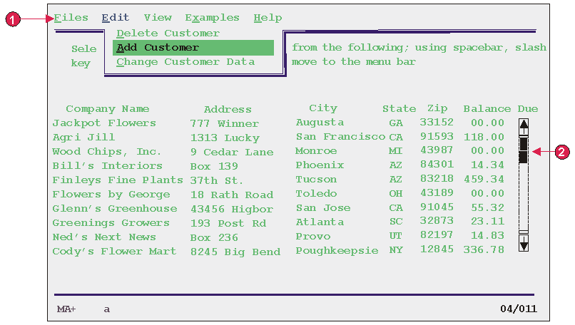

The following figure shows how the ENPTUI components might appear on your host screen:
Figure 1. ENPTUI components example
Example of ENPTUI components
  1. Selection field component
  2. Scrollbar field component
