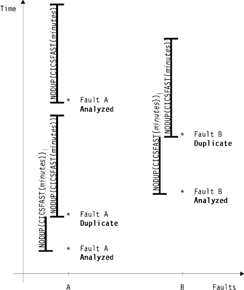

This suboption is used to specify the number of minutes elapse time, since the last occurrence of a fault, during which subsequent invocations of Z Abend Investigator for other faults in the same job step are deemed duplicates of the last fault if they satisfy the appropriate fault characteristics criteria.
- All instances of
fault A
are considered duplicates of each other based on fault characteristics alone - All instances of
fault B
are considered duplicates of each other based on fault characteristics alone - The
fault A
characteristics do not match those offault B
This option is currently used under CICS® to prevent multiple identical transaction abends that occur within a short period of time from all being analyzed by Z Abend Investigator with subsequent risk of exhausting system resources.
The valid range of minutes is 0 - 10080 (10080 is equivalent to one week). Specification of 0 minutes means that "CICSFAST" duplicate faults are not detected.
The default elapse time is 5 minutes.

When a fault is deemed a duplicate of another based on the fault characteristics and the
NoDup(CICSFAST(…)) option in effect, the writing of the history file entry is
suppressed, the duplicate count associated with the last fault is incremented by one, and message
HFZ0066I is issued. This type of fault suppression is referred to as
CICS fast duplicate fault suppression
