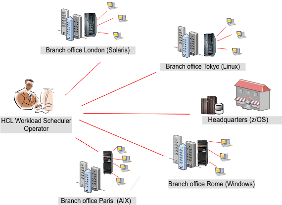

Business scenario
In this scenario, an insurance company, named Starbank, consists of a headquarters where its central office accounting department is located, and multiple branch offices located all over the world, where several administrative departments perform accounting activities.
The central office is in charge of the company's entire accounting workload. Therefore, the HCL Workload Automation operator must verify that all the workload processing for the Starbank company proceeds smoothly and without errors and needs a comprehensive workload management solution.
To achieve this goal, the operator needs to create a task that he can run every day to monitor all the administrative jobs, detecting in real time any possible failures.
However, although the sales department of the company runs its jobs in a z/OS environment, the single business units run their jobs in distributed environments. The operator needs a single console panel, from which he can control all the jobs, both z/OS and distributed, at the same time.
Mixed environment
The operator creates a task to monitor jobs that run on multiple engines, including both the environments. He does this by creating and running a task to on multiple engines.
