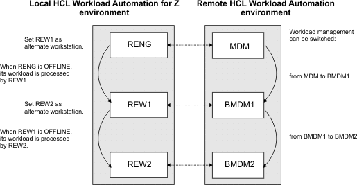

For example, in your z/OS scheduling environment you have defined a distributed remote engine workstation RENG that points to the master domain manager MDM on the distributed HCL Workload Automation. You have also defined the remote engine workstations REW1 and REW2, respectively pointing to the backup master domain managers BMDM1 and BMDM2. If the master domain manager is switched to a backup master domain manager, to prevent the bind process from failing, define REW1 as the alternative workstation for RENG, and REW2 as the alternative workstation for REW1.
Figure 1. Cascading remote engine workstation definitions for the switch management scenario
The graphic shows the cascading remote engine workstation definitions for the switch management scenario
