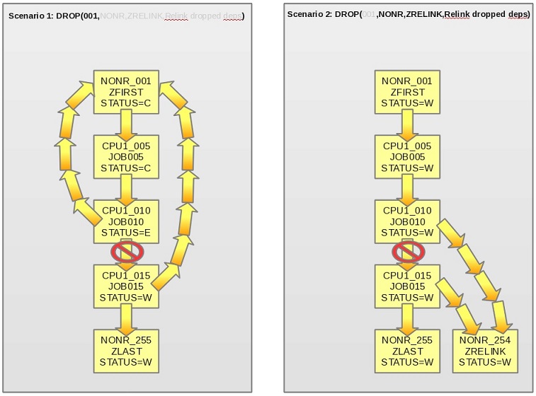

- Scenario 1
- When the dependency between operations 010 and 015 is dropped,
the
<predop>operation 001 that was set byOPTIONS DROPis in status C. This allows it to be connected as a predecessor to operations 010 and 015, preventing an occurrence split. - Scenario 2
the
<predop>operation 001 that was set withOPTIONS DROPis in status W. This prevents the relink processing to occur, therefore the operation 254 is added using the<succws>and<succjob>keywords ofOPTIONS DROP. This makes operation 254 a successor to operations 010 and 015, preventing in this way an occurrence split.
