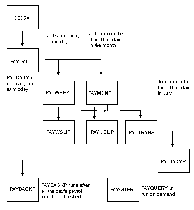

To help you understand HCL Workload Automation for Z and plan the definition of your systems to HCL Workload Automation for Z, this book bases its examples on a fictional corporation, Paymore Incorporated, that has a system running z/OS, and is converting its applications to run under the control of HCL Workload Automation for Z. It first converts the payroll system.
Figure 1. Example of payroll jobs at paymore incorporated
Flow chart shows the dependencies between the sample payroll jobs
The payroll analyst describes the process for the HCL Workload Automation for Z scheduler:
  1. CICSA runs 24 hours a day, but the payroll transactions are closed before PAYDAILY is started.
  2. On each working day, payroll clerks enter information about hours worked, new employees, and so on, into a CICS® system, CICSA.
  3. Payroll closes the CICSA payroll data set and asks the job preparation team to schedule the daily PAYDAILY job.
  4. The weekly job is PAYWEEK, which runs every Thursday or on the closest work day before Thursday if Thursday is a holiday. The weekly job must run after the daily PAYDAILY job.
    PAYWEEK calculates deductions, such as tax and insurance, and updates the bank-transfer data set. This is for people who choose to be paid by monthly bank transfer into their bank accounts. This job must run before the monthly bank-transfer job PAYTRANS, which runs on the third Thursday in the month.
  5. When PAYWEEK completes successfully, the job PAYWSLIP runs to print pay slips. It includes these programs:
    1. PAY14 writes pay slips to a data set, and creates a management report.
    2. PAY15 prints the pay slips.
  6. After the weekly payroll jobs:
    1. Job Preparation decollates the pay slips.
    2. Payroll checks the pay slips.
    3. The cash office takes the pay slips and prepares pay packets. This depends on the delivery of cash by security van.
  7. Monthly jobs, including PAYTRANS, have similar gross-to-net and print programs for monthly-paid employees. These jobs run on the third Thursday of each month, after the weekly payroll run. But if Thursday is a holiday, they run the day before.
  8. After the payroll run for the day, the job preparation team runs the backup job PAYBACKP and reopens the CICSA data set.
  9. If updates fail, the PAYRECOV job is run before the update job is rerun.
