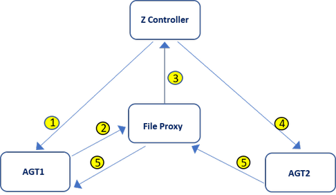

A user scenario
From the Dynamic Workload Console you create a File Transfer job whose connection protocol is Workstation to Workstation. In the job definition, you specify the following information:
  • Name of the File Transfer job (in this example, MYFILE)
  • Agent submitting the file transfer request (in this example, AGT1)
  • Destination agent where to transfer the file (in this example, AGT2)
When you save the job MYFILE, its job definition is stored in the Z controller JOBLIB.
On the Z controller, you define the operation related to the job MYFILE.
The occurrence is then added to the current plan and submitted as required.
The communication between the submitting agent, destination agent, and Z controller is always established through a proxy, as shown in Managed File Transfer communication flow.
Figure 1. Managed File Transfer communication flow
Where:
Arrow 1
The Z controller schedules the job MYFILE on AGT1.
Arrows 2 and 3
AGT1 sends a command request to AGT2 and asks for command verification to the Z controller through the File Proxy.
Arrow 4
The Z controller authorizes the command request towards AGT2.
Arrow 5
AGT2 sends the command data to AGT1 through the File Proxy. Communication between the agents is always performed through the proxy.
