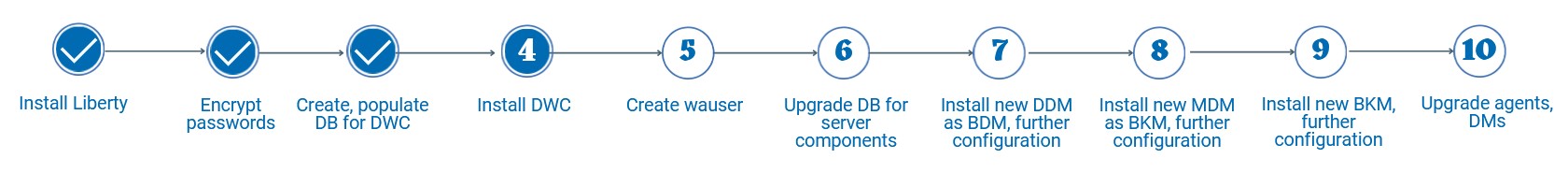

Procedure for installing two Dynamic Workload Console servers on two separate nodes.
Figure 1. Install fresh Dynamic Workload Console
The procedure to perform a fresh installation is demonstrated through a typical scenario where two Dynamic Workload Console servers are installed on separate workstations, sharing the same remote database.
