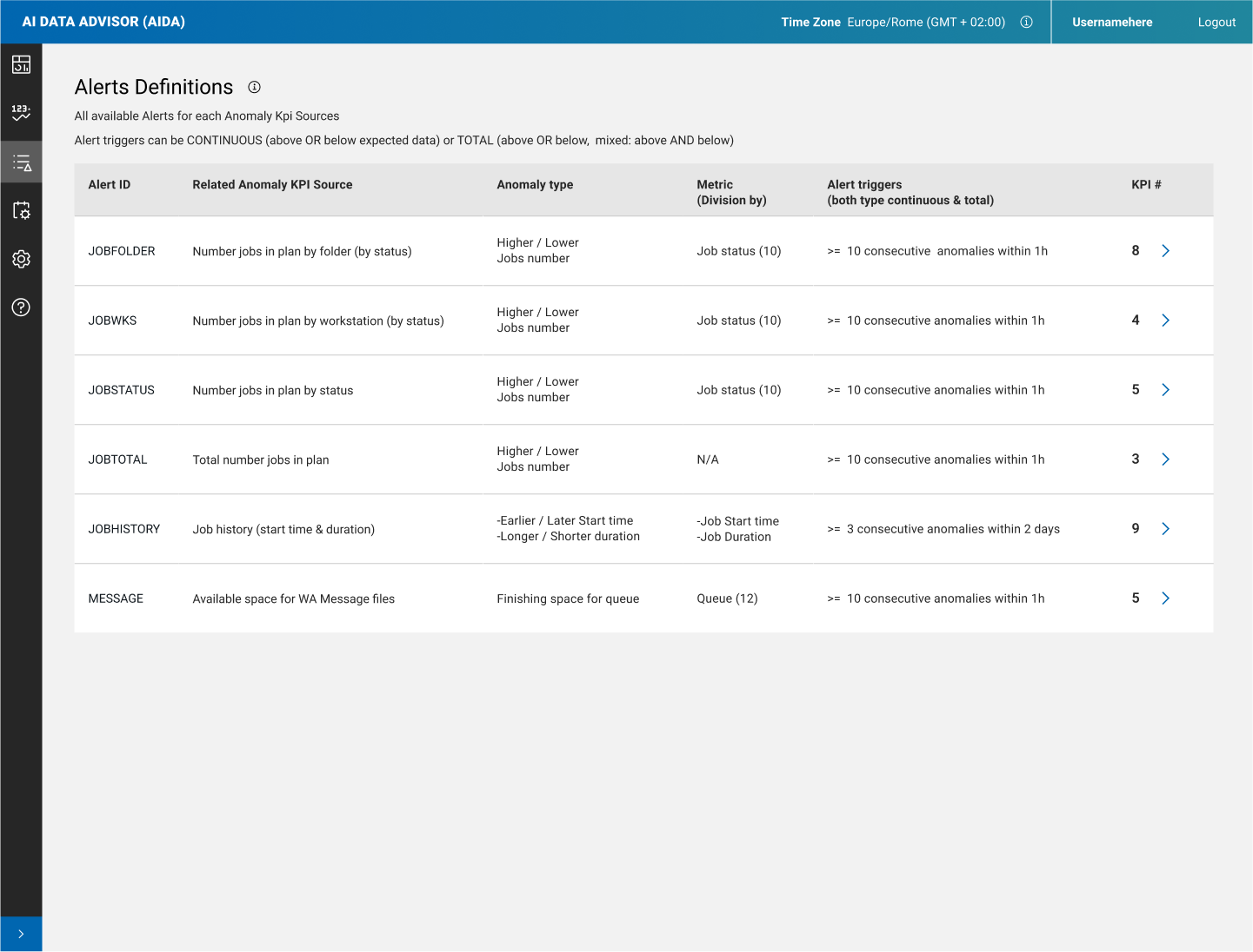

From AIDA
left-hand sidebar, select Alert Definitions.
In this page you can view the full list of alert definitions in table format.
- Alert ID
- The ID of the alert definition.
- Anomaly Source KPI
- The KPIs that contribute to generate the alert.
- Anamoly type
- The type of anomaly that generates the alert (for example: a higher or lower amount of job than expected).
- Metric
- The sub-division criteria of the alert instances. Depending on the KPI, it can be job status, star time/duration or queue.
- Alert Trigger
- Set of conditions defining the alert. For example: Over 3 anomalies within 1 hour.
- KPI
- The number of KPIs defined by this alert definition.

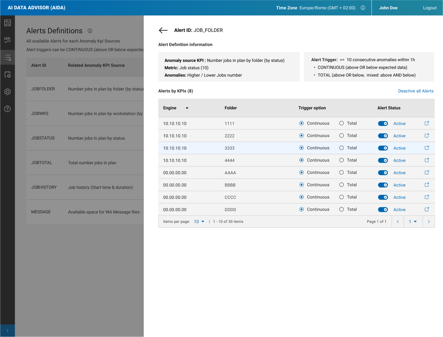

Click on an alert definition row (or the icon on the right) to open a side panel displaying detailed information and a tabular list of all alerts organized by the KPIs specified in the alert definition.
For each alert, you can modify the trigger type and activate or deactivate alert generation. A global option,Deactivate All Alerts, is also available to disable alert generation for all alerts in the list. Click the action icon on the right side of each row to access the Alert detail page, where you can view alert information, open alert instances, and the history for the past 12 months.
