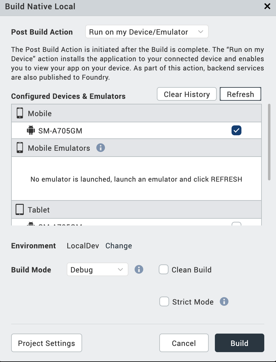

Run on my device
The Run on my Device action installs the application to your connected device and enables you to view your app on your device.
Establish a USB connection between the computer that built the app, and your device.
Important: USB Tethering for iOS devices on Windows Machine:
Prerequisites - Ensure that the latest version of iTunes is installed on the Windows machine. Before you start viewing the app on your iOS device by using the USB feature on Volt MX App, open iTunes on your Windows machine.
If you connect your device to the system after selecting the post build action, use the Refresh option to refresh the list of available devices that are connected to the system.
Use the Clear History option to clear out old entries of devices that are not connected to the system.
Once this action is completed, by default Android devices launch the app. Whereas, for iOS devices you need to explicitly launch the app by tapping on the app icon.

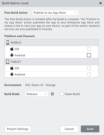

  1. On your Volt MX Iris, from the main menu, select Build.
  2. From the context menu, select Build Native Local.
  3. Select the platforms and channels for which you want to build the application.
  4. From the Post Build Action drop-down menu, select the desired Post Build Action. For more details about the Post Build Action, click here.
  5. You can choose to change the cloud environment on which your app is to be published. To do so, click Change beside the Environment option. By default, the Environment displayed is the one that was last selected.
  6. From the Build Mode drop-down list, select your desired build mode.
    • Debug mode - To help you identify and fix errors, Volt MX Iris emits the complete symbolic debug information . To lessen the amount of time necessary to complete the build, the build is not optimized for code execution, so it may tend to execute slower than a build optimized for release. Also, the inclusion of the symbolic debug information causes the final executable to be larger than a release build.
    • Release mode - Volt MX Iris optimizes the build for execution, requiring more time to generate the build. It also does not emit the complete symbolic debug information, making the final executable smaller than a debug build.
    • Protected Mode - Applications built in Volt MX Iris can use the additional security enhancements by building the application in the Protected Mode. Volt MX IrisPlatform code for iOS and Android is equipped with mechanisms that can protect your application by detecting attacks like tampering, swizzling, debugging, jail breaking (iOS), rooting (Android), and information disclosure. Additional security mechanisms are provided through the use of White Box Cryptography to protect application business logic and source code. Application reacts to the attack by exiting upon detecting attacks to prevent further attempts. If you choose to build an application in Protected mode, then setting the public and private keys is mandatory. To do so, go to Project Settings > Protected Mode. For more details on how to generate public and private keys, click here.
    • Test Mode - To help you identify and fix errors, Volt MX Iris provides the ability to Test the application on the device or an emulator. When you build an app using the Test Mode, you can leverage the Jasmine testing framework of Volt MX Iris to thoroughly test your app and ensure your application is errors free. You can run jasmine test cases, test suites and test plans by building an app using the Test mode.
  7. If you do not want to use the SHA1, MD2, MD4, and MD5 hashing algorithms in your application, check Strict Mode. If you do use any of those algorithms, leave Strict Mode unchecked. Otherwise, you will receive an "Unsupported algorithm" error message.
  8. Click Build. The build generation begins.
    You can check the status of your build in the Build tab. It undergoes various actions, like Project compression, uploading the compressed project to the cloud, and then the actual build begins. This process may take some time.
    If there are any errors, they appear in the Build tab.

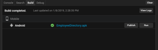

  9. From the Build tab, click View logs to open the build logs for the build service on your system.
    Note: The app generated using the Build Native Local option cannot be viewed on the Volt MX VoltMX app.
Post Successful Build
Once the build is completed, the details of the generated binaries are provided in the Build tab.
  • Click on the binaries to open the path of the binaries in your local machine.
  • Click Run to run the app on your local device. If your post build action is already selected as Run on my Device, then the Run option is not enabled and there is no need to explicitly run the app again.
  • Click Publish to publish the App on Enterprise App Store. If your post build action is already selected as Publish to my App Store, then the Publish option is not enabled and there is no need to explicitly publish the app again.
  • Click View Logs to view the build related logs.
Note: When an application is built for the Windows platform, the Publish and Run options are inactive.
