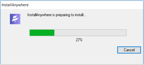

  2. Double-click VoltMXFoundryInstaller-x.x.x.x.GA.exe to launch the installer.
    The InstallAnywhere dialog appears. The InstallAnyWhere dialog displays information about the progress of the software installation at run time.

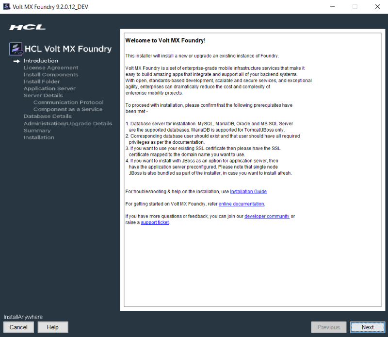

  3. The Welcome To Volt MX Foundry windows appears.
    Read the instructions carefully before installing Volt MX Foundry Console.
  4. Read the instructions carefully, and click Next.

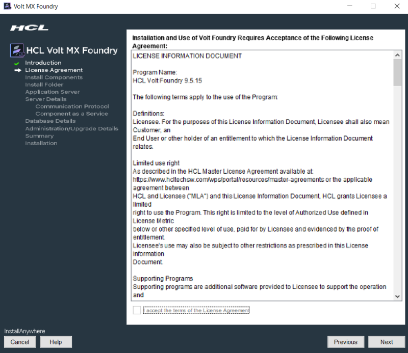

    The LICENSE AGREEMENT window appears.
  5. Scroll down and select the "I accept the terms of the License Agreement" option.
    Note: To activate the License Agreement option, read carefully the entire text.

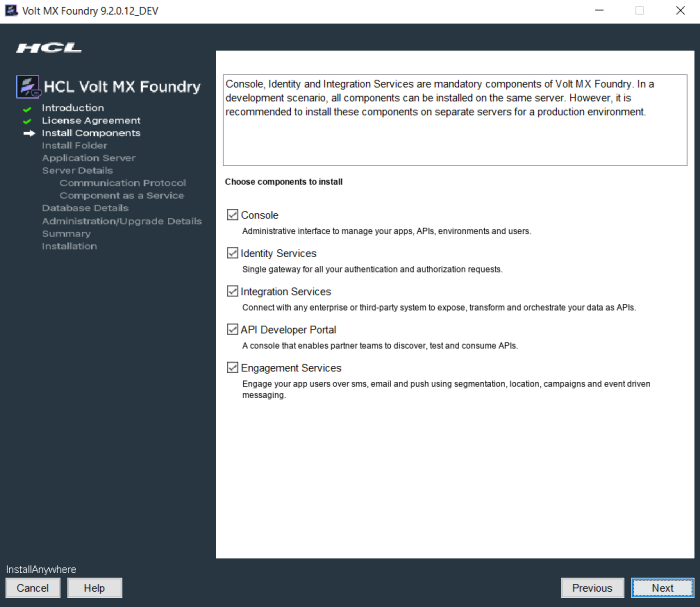

  9. Click Next. The Choose components to install window appears.
  10. Select one or more check boxes for the supported components. By default, the Console, Identity Services, Integration Services, and Engagement Services check boxes are selected.
    • Console - To install Volt MX Foundry Console, select the Console check box.
      The system creates the following databases: <prefix>mfconsoledb<suffix>, <prefix>mfaccountsdb<suffix>, and  <prefix>mfreportsdb<suffix>.
    • Identity Services - To install Volt MX Identity Services, select the Identity Services check box.
      The system creates the following database: <prefix>idconfigdb<suffix>.
    • Integration Services - To install Volt MX Foundry Integration Services, select the Integration Services check box.
      The system creates the following databases: voltmxadmindb  and  mfreportsdb.
    • API Developer Portal - To install developer portal, select the API Developer Portal check box.
      Note: During installation if you have selected API Developer Portal, the API Developer Portal is created. You can directly access your VoltMX Developer Portal in Volt MX Foundry Console.
    • Engagement Services - To install Volt MX Foundry Engagement Services, select the Engagement Services check box.
      The system creates the following database: <prefix>kpnsdb<suffix>.

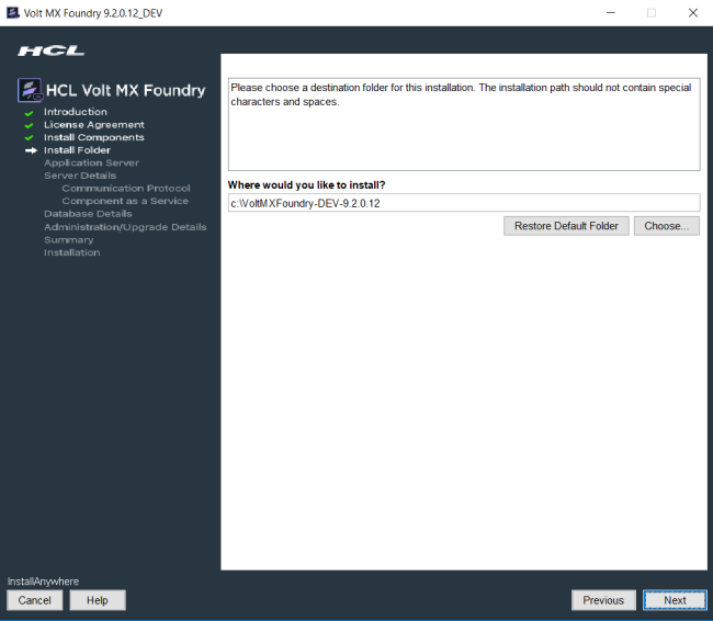

  11. Click Next. The Install Folder window appears. The selected path appears in the Where would you like to install field.
  12. Click Choose to browse the required folder from your system.

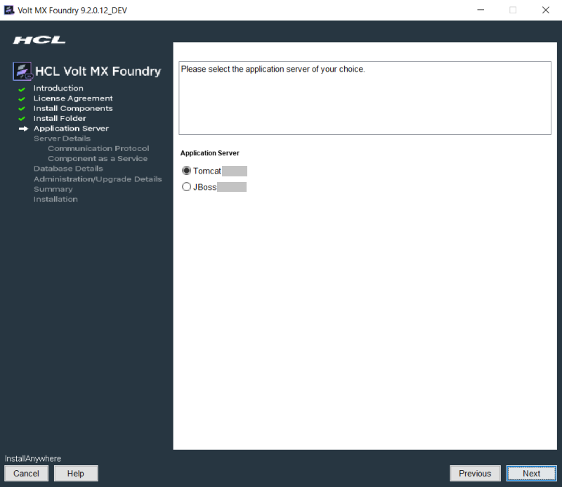

  13. Click Next. The Application Server window appears asking you to choose the application server. By default, the Application Sever is set to Tomcat.
  14. In the Application Server window, click JBoss, and then click Next.

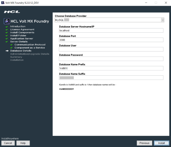

  19. Click Next. The Database Details window appears. From the Database Choice drop-down, choose one of the databases to display database details. By default, this option is set to MySQL.
    • Enter the following database details for MySQL.
      MySQL Cluster - Group Replication is a new replication type supported from MySQL 5.7 onwards. In case your Foundry setup consists of a MySQL Cluster with Group Replication, please select the same from the list of Database Type Providers instead of the default MySQL option.
      • Database Server Hostname/IP: Enter the DB server Hostname/IP to be used to create a database of selected components of Volt MX Foundry. By default, the server Hostname/IP is set as localhost.
      • Database Port: Enter the database port of the MySQL Server. By default, this field is set to 3306 for MySQL.
      • Database User: Enter the user name used while creating the database user - for example, dbclient.
      • Database Password: Enter the user password used while creating the database user.
      • Database Name Prefix: Enter valid prefix databases - for example, jboss.
        For example, the following databases are created for all components: jbossglobaldb54, jbossconfigdb54, jbossconsoledb54, jbossaccountsdb54, jbossmfreportsdb54, jbossadmindb54 and jbossmfreportsdb54
      • Database Name Suffix: Enter valid suffix for all databases - for example, 54

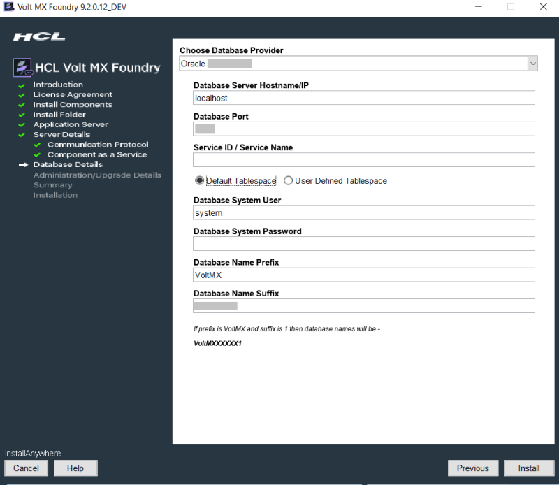

        • Enter the following database details for Oracle.
      • Database Port: Enter the database port of the Oracle Server. By default, this field is set to 1521 for oracle.
      • Service ID / Service Name: Enter Oracle service ID or service name. Service ID is unique alias given to an instance name of Oracle DB.
      • Select the tablespace for Oracle database:
      Important:  If tablespaces were already created, the DBA must grant quota (permissions) on these tablespaces to installer with admin option.
      The DBA also must include grant quota on the schemas from installer login.
      • Default Tablespace: If selected, the database schema and SQL scripts migration happens automatically to the default tablespace for example, USERS
        • User Defined Tablespace: If selected, enter the tablespaces for the following:
          • Data Tablespace:
            Enter the name for Data tablespace.

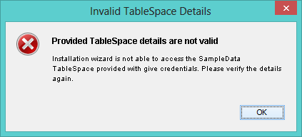

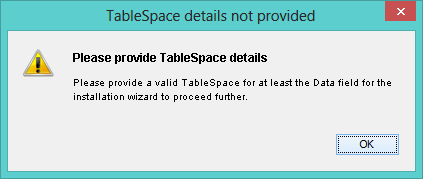

            This is a mandatory field. If the Data tablespace field empty, the installers displays the error message:
            If the Data tablespace (for example, SampleData) does not exist, the installers displays the error message:
          • Index Tablespace: Enter the name for Index tablespace.
            If input for Index Tablespace is not provided, then the value will be set to the provided Datatable space value.
          • LOB Tablespace: Enter the name for LOB tablespace.
            If input for LOB Tablespace is not provided, then the value will be set to the provided Datatable space value. * Database System User: Enter the user name used while creating the database user - for example, dbclient. * Database System Password: Enter the user password used while creating the database user. * Database Name Prefix: Enter valid prefix databases - for example, Volt MX. * Database Name Suffix: Enter valid suffix for all databases - for example, 1.

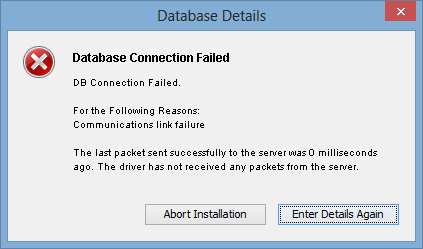

      If a database faces connection issues, the system displays an error message. For example:

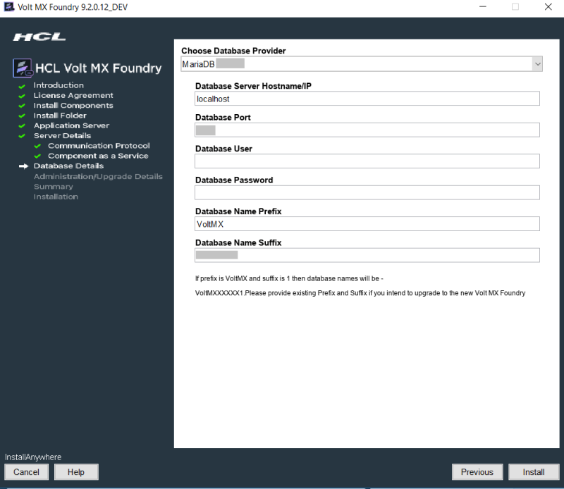

    • Enter the following database details for MariaDB.
    • Database Port: Enter the database port of the MariaDB. By default, this field is set to 3306 for MariaDB.
    • Database User: Enter the user name used while creating the database user.
    Important: The Reports Database Name filed appears only if you have selected the Console, Identity, and Integration during Install Components.
    • Database Name Prefix: Enter the valid prefix databases - for example, jboss.
    • Database Name Suffix: Enter the valid suffix for all databases - for example, 54.
    • After entering database server details, click Next.

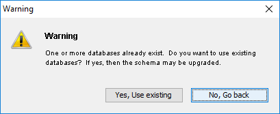

    If a database exists, the system displays the warning message: One or more databases already exist. Do you want to use existing databases? If yes, then the schema may be upgraded. shown below:

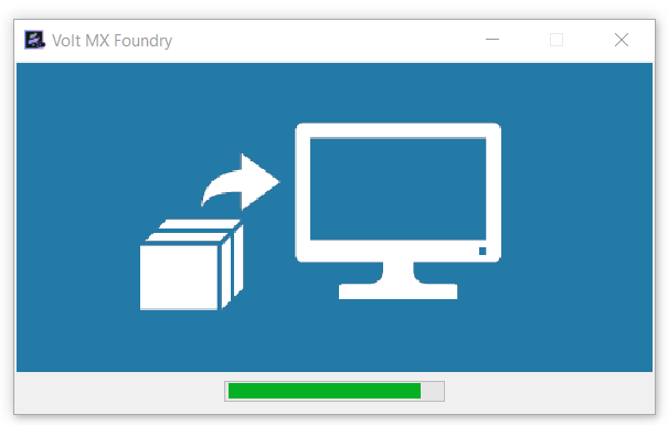

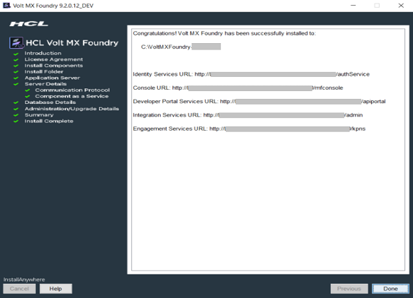

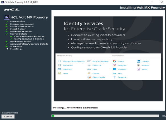

  23. Click Install. The Installing Volt MX Foundry Console window appears.
    Once the installation completes, the Install Complete window appears with the confirmation message.
  24. Click Done to close the window.

    Note: You can now access Volt MX Foundry Console by using the URLs. For more details, refer to Accessing Volt MX Foundry Console - On-premises.
    During installation if you have configured your super administrator account, you can directly log in to Volt MX Foundry Console by using the Console URL.
