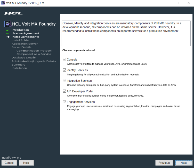

Click Next. The Choose components to install window appears.
Select one or more check boxes for the supported components. By default, the Console, Identity Services, Integration Services, Developer Portal, and Engagement Services check boxes are selected:
- Console - To install Volt MX Foundry Console, select the Console check box.

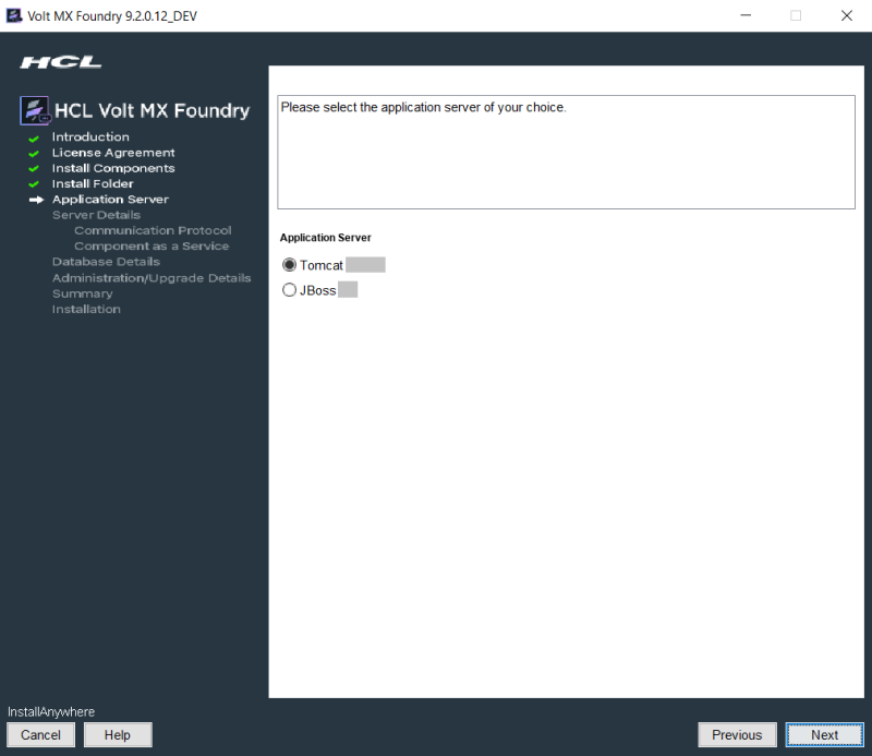

Click Next. The Application Server window appears asking you to choose the application server. By default, the Application Sever is set to Tomcat.
In the Application Server window, click Tomcat.

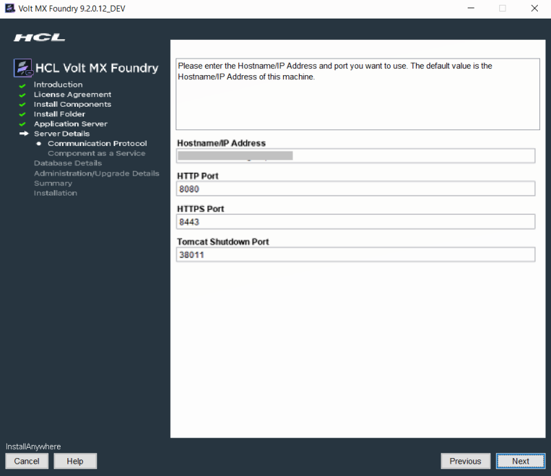

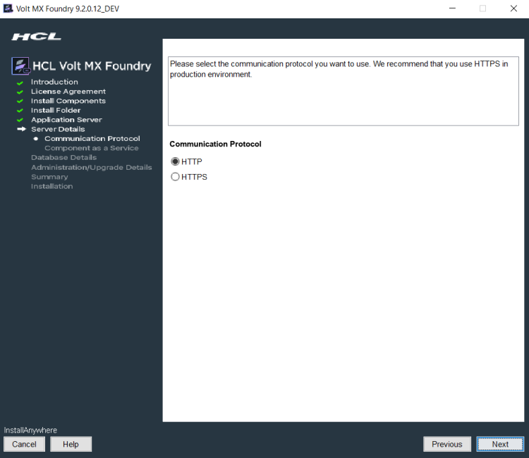

The HTTP or HTTPS window appears asking you to choose the HTTP or HTTPS. By default, this option is set to HTTP.
a) Between HTTP and HTTPS, if you select HTTP, the following window appears. Enter the Hostname/IP Address, HTTP Port, and Tomcat Shutdown Port. Click Next.
b) Between HTTP and HTTPS, if you select HTTPS, the following window appears. Enter the Hostname/IP Address HTTP Port HTTPS Port and Tomcat Shutdown Port Click Next.

If any input goes wrong among the inputs provided in the previous steps: HTTP or HTTPS > a or HTTP or HTTPS > b, one of the following error messages will appear:

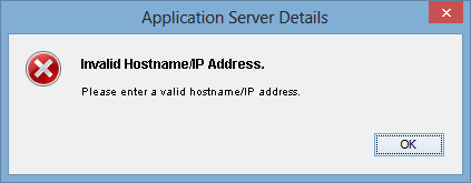

- If you provide an invalid hostname/IP address, the following alert is displayed:

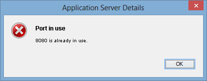

- If a port is in use, the following alert is displayed:

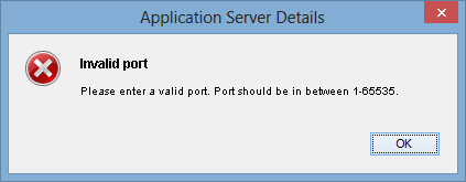

- If you provide an invalid Port, the following alert is displayed:

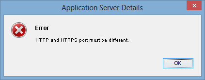

- If you provide the same port numbers for HTTP and HTTPS, the following alert is displayed:

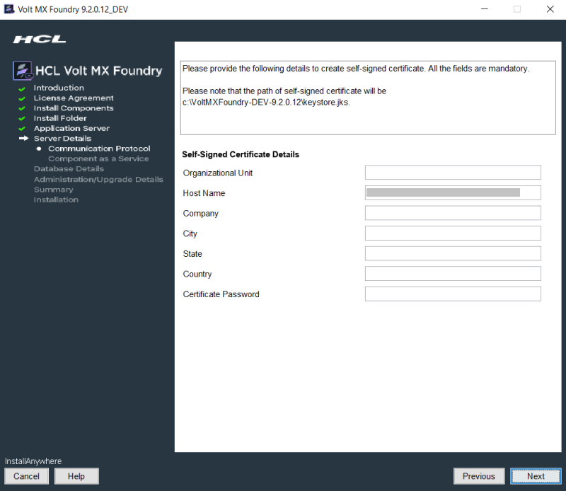

To generate a self-signed certificate, click Generate a self-signed certificate, and click Next. The Details for self-signed SSL Certificate window appears.
Important: To add an existing SSL certificate to a cacerts file, refer to How to Add Your Existing SSL Certificate.
Note: The path for a self-signed certificate is in this location:
<install folder>\keystore.jks-
Enter details for the following fields:
Organization Unit: Enter your business unit name.
- Host Name: Enter your domain name - for example, hcl.net
- Company: Enter your company name.
- City: Enter your city name.
- State: Enter your state name.
- Country: Enter your country name.

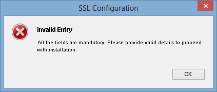

Certificate Password: Enter the password for the .jks file that the installer will generate.

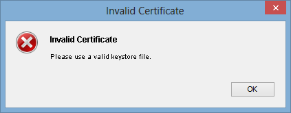

If you enter invalid details, the following error message is displayed:

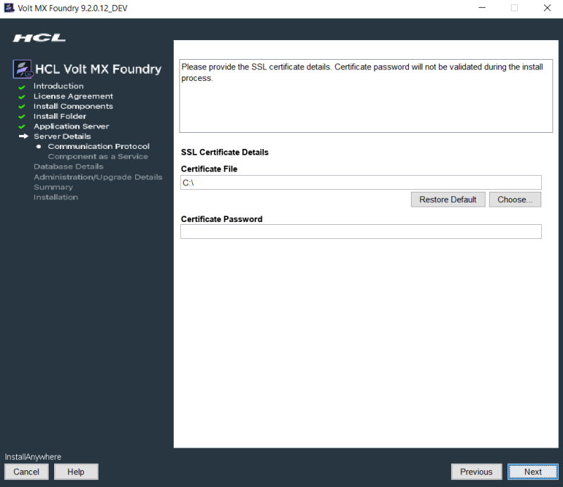

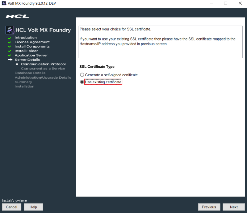

To use an existing SSL certificate, click Use existing certificate, and click Next. The SSL Certificate window appears.
Note: Provide path for .jks file as input.
In the SSL Configuration window, enter the file path for keystore file and password details. * If you enter invalid certificate details, the following error message is displayed:

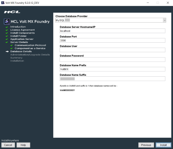

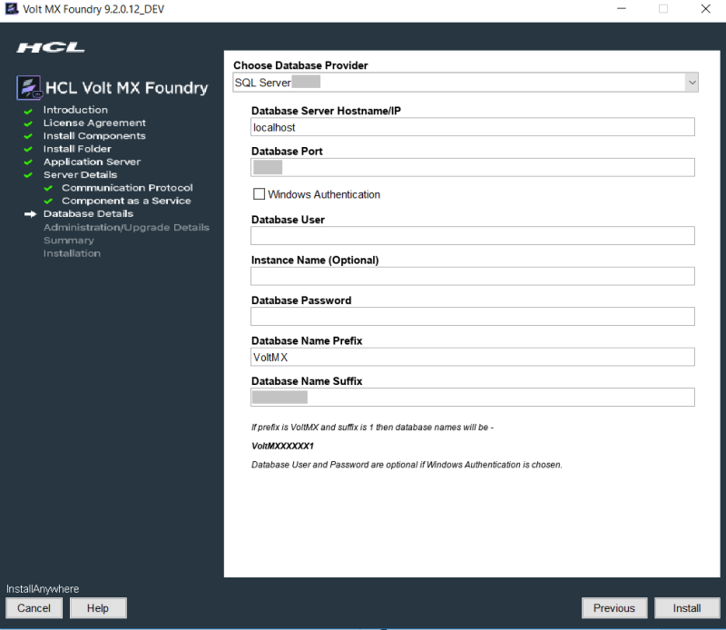

Click Next. The Database Details window appears. From the Choose Database Provider drop-down, select one of the databases to display database details and fill the details. By default, this option is set to MySQL.
Enter the following database details for MySQL.
MySQL Cluster - Group Replication is a new replication type supported from MySQL 5.7 onwards. In case your Foundry setup consists of a MySQL Cluster with Group Replication, please select the same from the list of Database Type Providers instead of the default MySQL option.
- Database Server Hostname/IP: Enter the DB server Hostname/IP to be used to create a database of selected components of Volt MX Foundry. By default, the server Hostname/IP is set as localhost.
- Database Port: Enter the database port of the MySQL Server. By default, this field is set to 3306 for MySQL.
- Database User: Enter the user name used while creating the database user - for example, dbclient.
- Database Password: Enter the user password used while creating the database user.
- Database Name Prefix: Enter the valid prefix databases - for example, Volt MX.
- Database Name Suffix: Enter the valid suffix for all databases - for example, 1.
- Encrypted Rotational Key: Enter the rotational key that you received from the encryption utility. This is applicable only if you are using an encrypted database password. For more information, refer to How to encrypt the database password.
After entering database server details, click Next.
If a database exists, the system displays the warning message:
One or more databases already exist. Do you want to use existing databases? If yes, then the schema may be upgraded.Shown as follows:

Enter the databases details, and click Next. The Pre-Installation Summary window appears.
