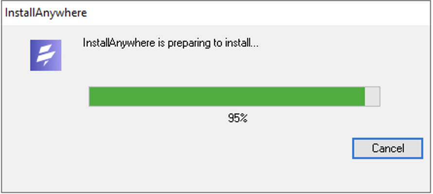

  2. Double-click VoltFoundryPatchInstaller-9.5.x.QA.exe to launch the installer.
    The InstallAnywhere dialog appears and displays the progress of the launching the installer.

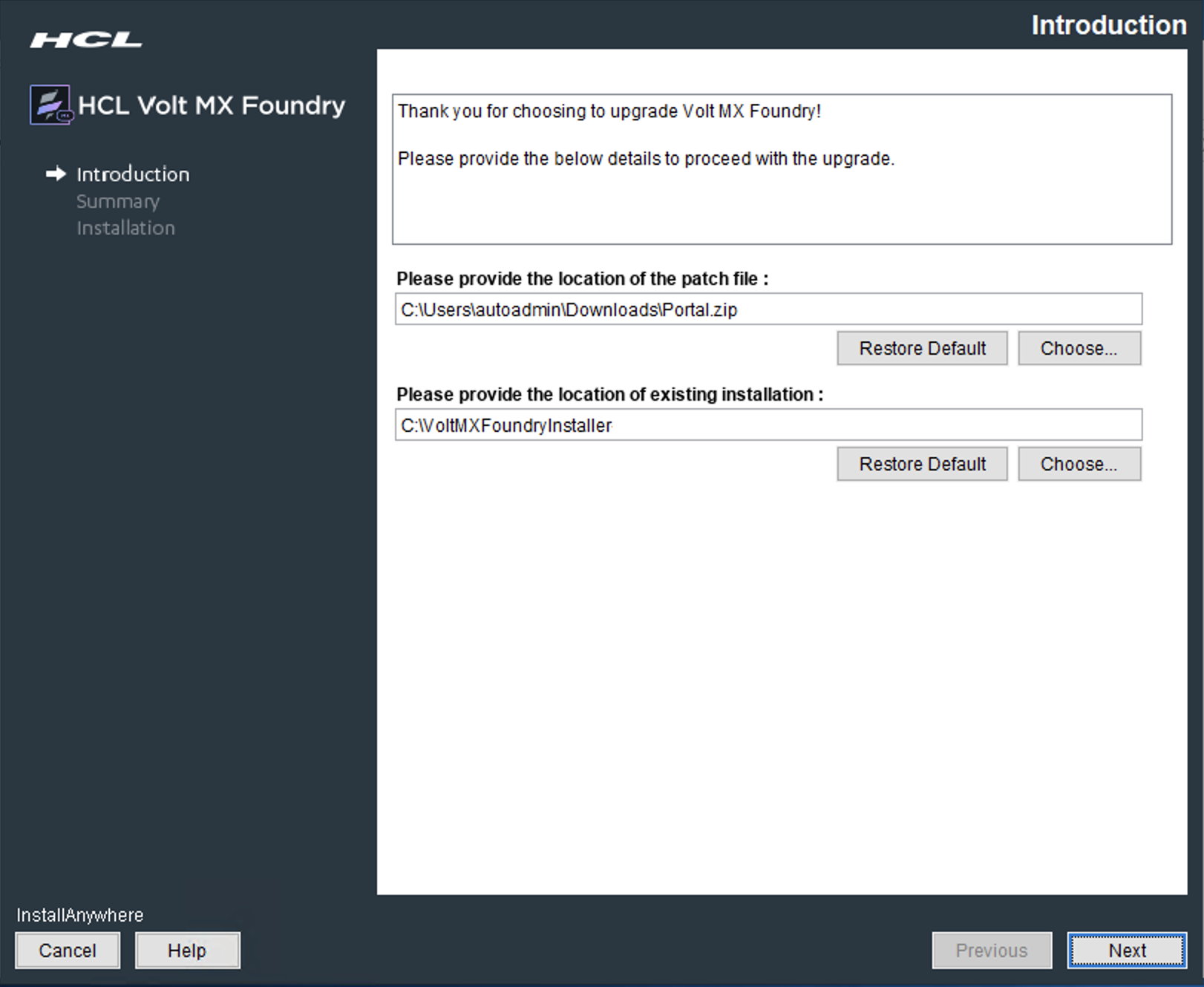

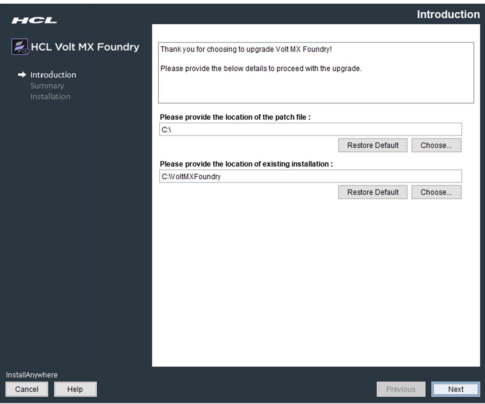

  1. Next, the Introduction window appears asking for following details: Enter the details to proceed with the upgrade:
  • Please provide the location of the patch file: Provide the patch file location of the Volt Foundry component that you wish to install to current version. For example, middleware.zip. For information about creating a patch file, refer to Creating a patch file for Foundry components.
  • Please provide the location of existing installation. The default install location appears in this field. Provide the location of existing Volt Foundry installation that you wish to upgrade with the selected patch version.

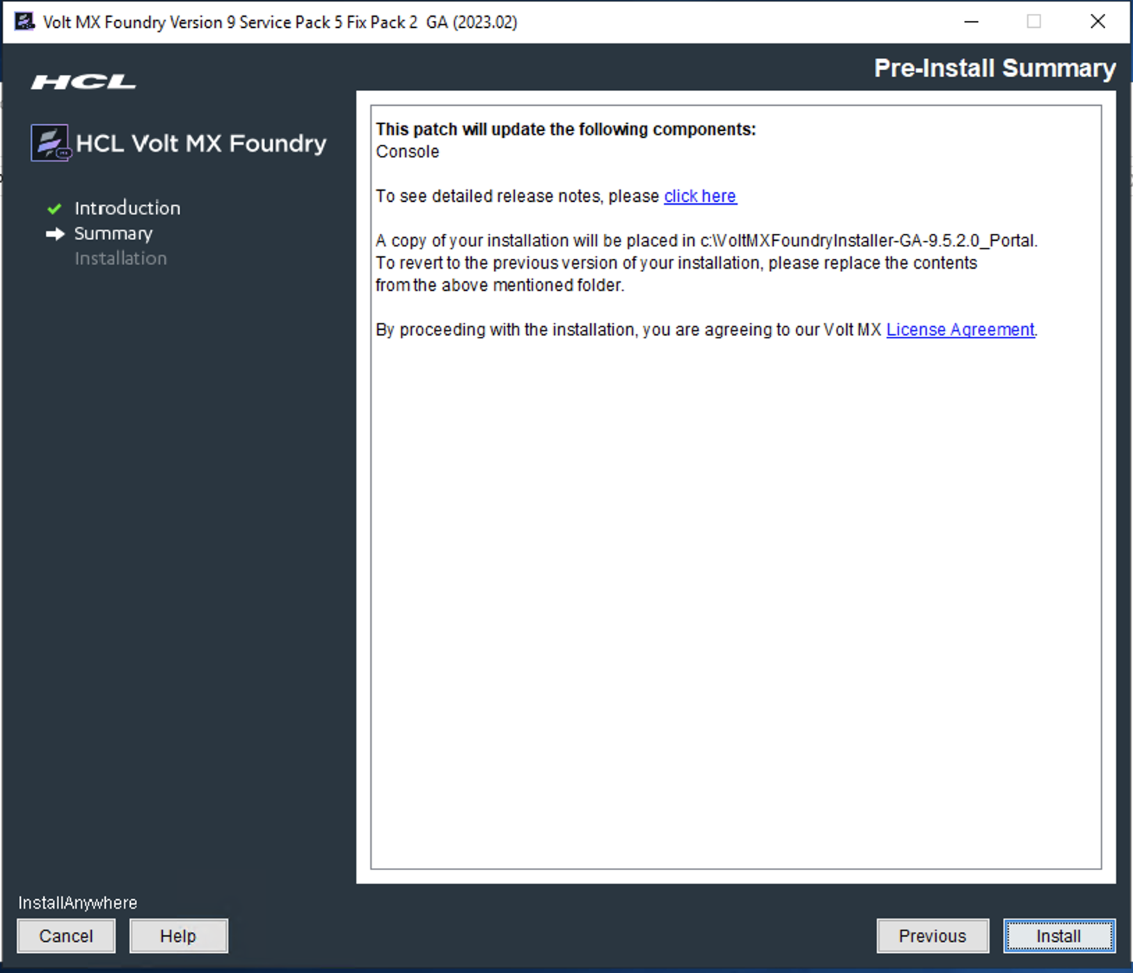

  1. Click Next. The Pre-Installation Summary window appears.
The installer takes backup of the current install folder. The backup folder will have a suffix of _{Patch_File_Name}. For example, if the hotfix name is VPNS.XXX, then the suffix of the backup folder will be _VPNS.XXX.
IMPORTANT: The Installer does not support automatic backups of database and other artifacts. The Installer does not support rollback in case of a failure during the upgrade.
- You must take backup of your database and other artifacts before upgrading.
- After the upgrade, republish your Volt Foundry applications.

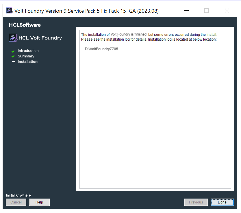

Once the installation completes, the Installation window appears with the confirmation message.
The installation of Volt Foundry is finished. In case of any errors during the installation, refer to the installation log for details. Installation log is located at below location: For example, C:\VoltMXFoundry900\
  1. Click Done to complete the installation. After the installation is completed, the installer creates logs in the install folder.
