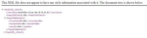

Test the Setup
Use the following Healthcheck URLs post-deployment to check the status of a Volt MX Foundry component on each node:
For Volt MX Foundry console: http://<domain_name>:<port>/mfconsole/health_check/all
For Middleware: http://<domain_name>:<port>/services/healthcheck
For Auth Service: http://<domain_name>:<port>/authService/v1/manage/checkhealth
For Sync: http://<domain_name>:<port>/syncconsole/healthcheck
For Messaging: http://<domain_name>:<port>:53409/vpns/service/healthcheck/json
