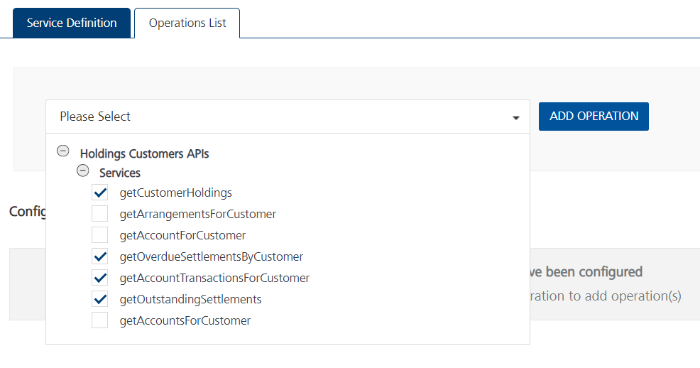

  1. From the Service Definition page, switch to the Operations List tab.
    Alternatively, click the plus (+) icon on the left pane, and then click Add New Operation.
  2. On the Operations List tab, from the drop-down list, select the operations that you want to add to the service.
    When you select a path (operation), all the corresponding fields of the operation are populated.

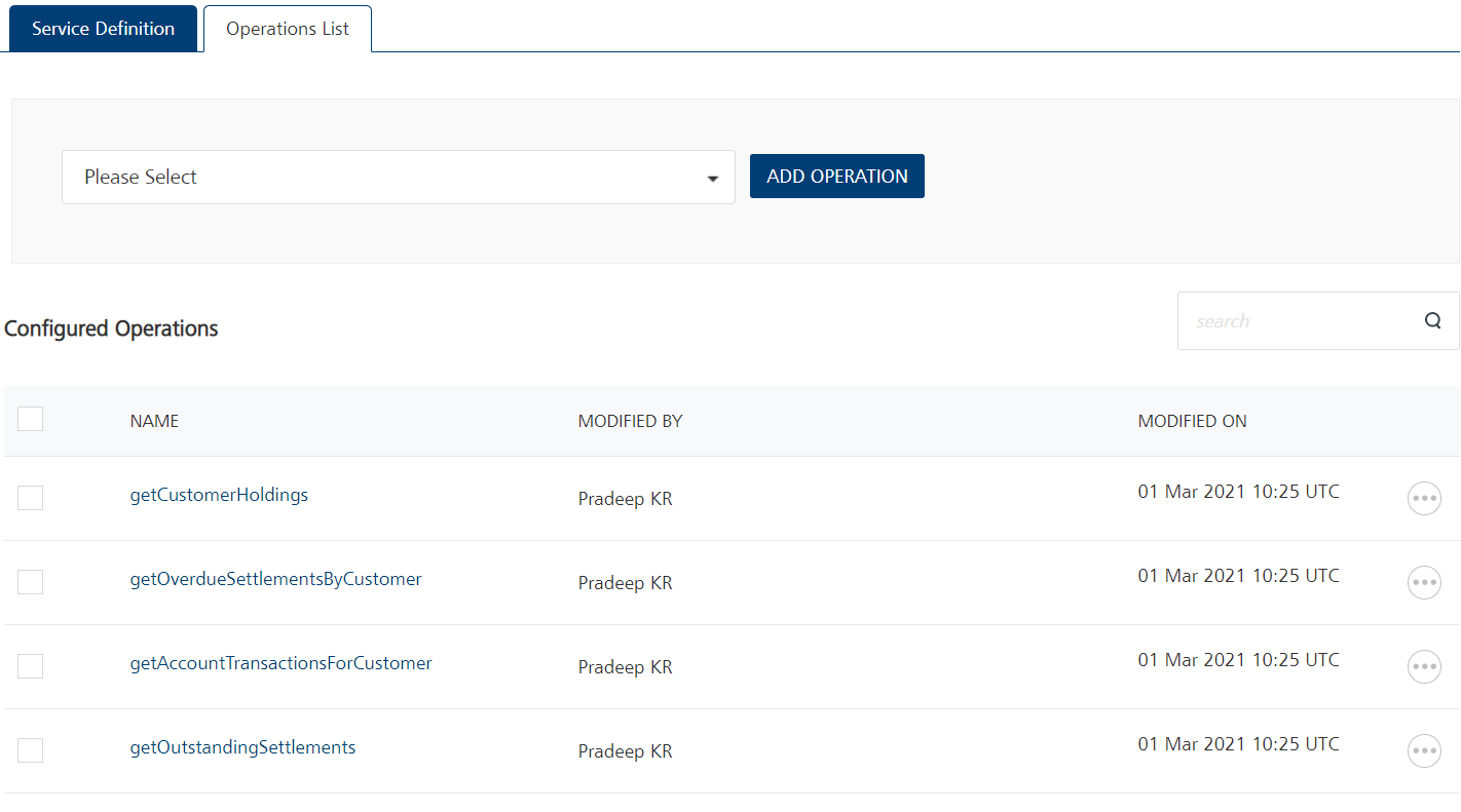

  3. After you select the operations, click ADD OPERATION. Foundry adds the selected operations to the Operations List tab.

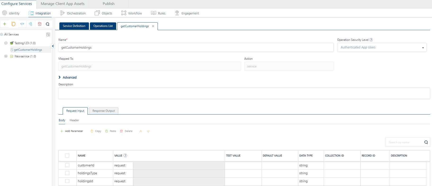

  4. Under Configured Operations, click an operation to view the details of the operation.
  5. Foundry displays the selected operation in the edit mode. You can configure the parameters to update the operation. For more information, refer to the following table.
    Field Description
    Name Specifies the name that Foundry uses to identify the operation on the console.
    Operation Security Level Specifies the authentication that is required to invoke the operation. Contains the following options: Authenticated App User – It restricts the access to clients who have successfully authenticated using an Identity Service associated with the app. Anonymous App User – It allows the access from trusted clients that have the required App Key and App Secret. Authentication through an Identity Service is not required. Public – It allows any client to invoke this operation without any authentication. This setting does not provide any security to invoke this operation and you should avoid this authentication type if possible. Private - It blocks the access to this operation from any external client. It allows invocation either from an Orchestration/Object Service, or from the custom code in the same run-time environment.
    Description Specifies the description of the service that is displayed on the console.
  6. Configure the parameters in the Advanced section based on your requirement. For more information, refer to the following table.
    Advanced
    Custom Code InvocationYou can add pre and post processing logic to services to modify the request inputs. When you test, the services details of various stages in the service execution are presented to you for better debugging. All options in the Advanced section are optional. For more details, refer to Preprocessor and Postprocessor.
    Additional Configuration PropertiesAdditional Configuration Properties allows you to configure service call time out cache response. For information on different types of configuration properties, refer Properties.
    Front-end APIFront-end API allows you map your endpoint ](or) backend URL of an operation to a front-end URL. For detailed information, refer Custom Front-end URL.
    Server EventsUsing Server Events you can configure this service to trigger or process server side events. For detailed information, refer Server Events.
  7. After you configure the required parameters, click SAVE.
