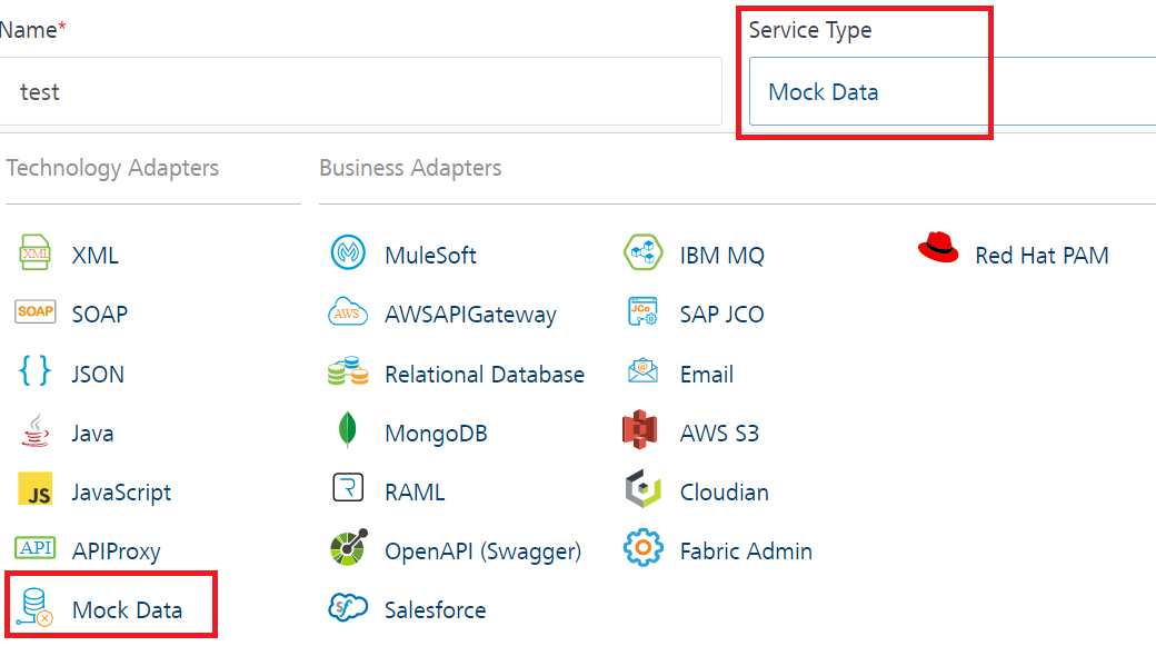

To configure your Mock Data Adapter, provide the following details:
  1. In the Name field, provide a unique name for your service.
  2. From the Service Type list, select Mock Data.
  3. For additional configuration of your service definition, provide the following details in the Advanced section:

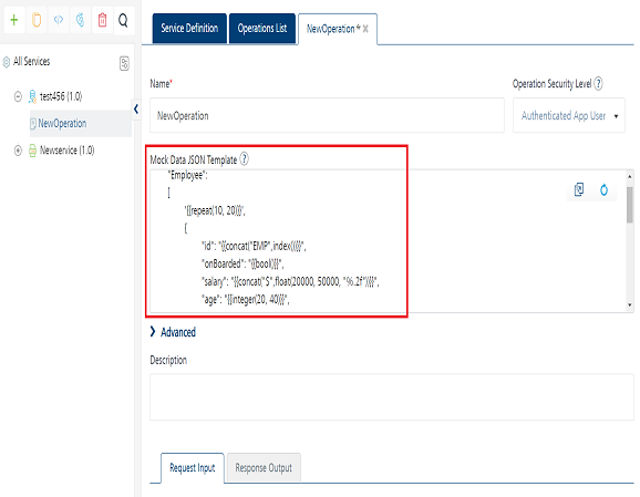

  1. Configure your Mock data template in the Mock Data JSON Template text field. By default this field is enabled with a sample mock response template.
    Note: For more information on Pre-built functions supported in Mock Data template, refer Mock Data Template and Supported Pre-built functions in Mock Data
