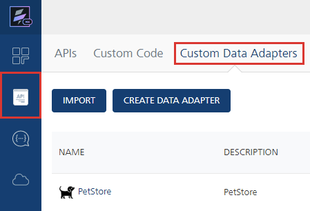

You can configure Custom Data Adapters from the API Management section, under the Custom Data Adapters tab.

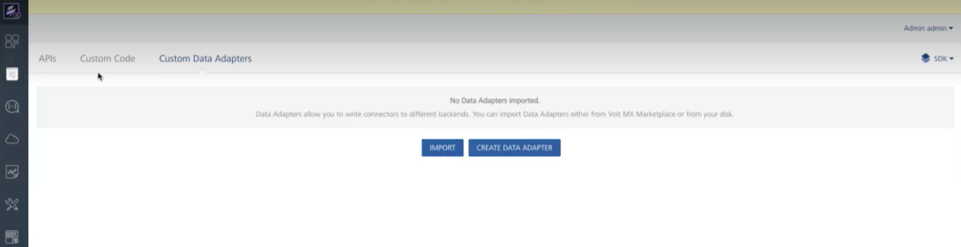

  1. Navigate to the Custom Data Adapters tab in your API Management section.

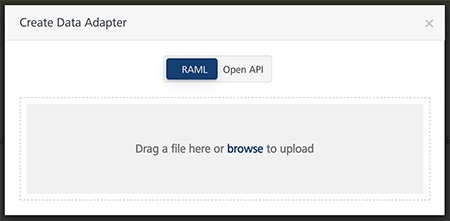

  2. Click on the CREATE CUSTOM DATA ADAPTER button. The Create Data Adapter dialog appears.
  3. Select the type of file you want to upload to Volt MX Foundry.
    • Select RAML if you want to upload a RAML file.
    • Select Open API if you want to upload a Swagger file.
  4. Drag and Drop a file into the upload window.
    Alternatively, you can browse for a file on your system.

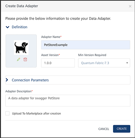

  5. Enter the details for the Custom Data Adapter such as Adapter Name, Asset Version, and Description.
    • Adapter Name[Mandatory] - Name that Volt MX Foundry displays on the console.
    • Asset Version[Mandatory] - Version number that Volt MX Foundry displays on the console. The version number follows the X.X.XX format.
    • Min Version Required - Minimum version of Volt MX Foundry that can run the Custom Data Adapter.
    • Image - Image that Volt MX Foundry displays for the Custom Data Adapter's icon.
    • Adapter Description[Mandatory] - Description that Volt MX Foundry displays on the console.
    • Upload to Marketplace after creation - Select this check box if you want to upload your Custom Data Adapter to the Volt MX Marketplace.

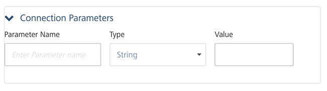

    Note: Connection Parameters - You can configure dynamic connection parameters that you want to pass to the Custom Data Adapter.
    These parameters show up when you select the Custom Data Adapter as a service type for your Integration service.
  6. Click CREATE.

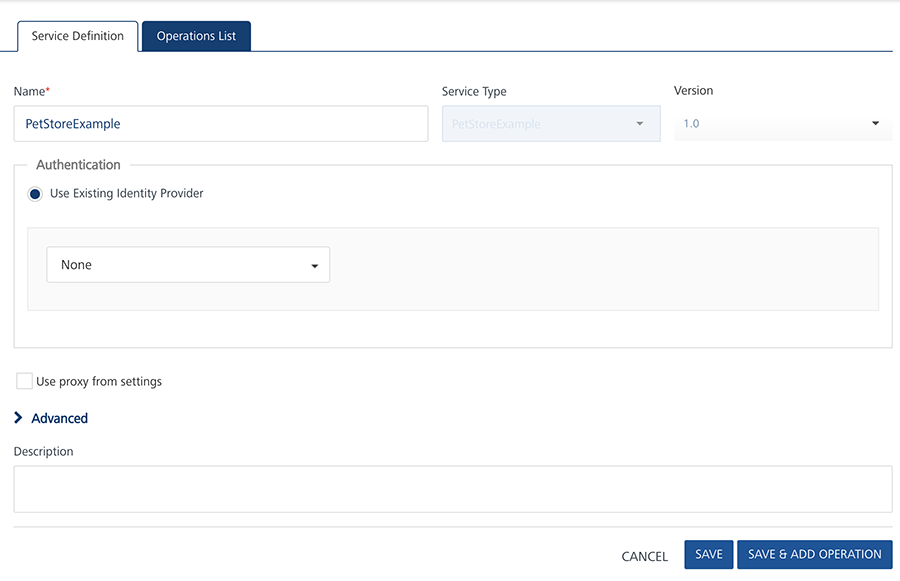

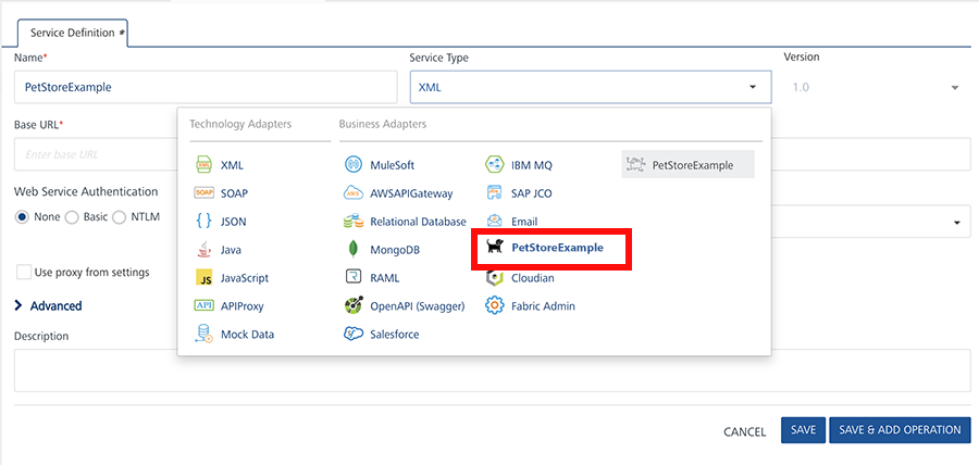

  2. Create an Integration Service in your Volt MX Foundry application. Select your Custom Data Adapter in the Service Type list and click Save.
    As we named our adapter PetStoreExample, click on PetStoreExample to use it in your service.

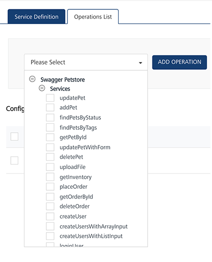

  3. Click on ADD OPERATION.
Note: You can configure the Authentication details if you want to enable Enhanced Identity Filters for your Service.
You can also configure the features in the Advanced tab if you want to add a custom code or enable throttling for your Service. For more information, you can refer to the Integration section of the Volt MX Foundry User Guide.

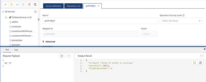

  1. Add Operations based on your requirements.
You can then make service calls to the Swagger PetStore from Volt MX Foundry.
  2. Click on the IMPORT button.

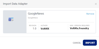

    Note: You can also import Custom Data Adapters from the VoltMX Marketplace by clicking the IMPORT FROM VoltMX MARKETPLACE button.
  4. Click IMPORT on the next window. This window also shows the metadata that you configured for your Custom Data Adapter.
You can then use this Custom Data Adapter to create services and operations in your Volt MX Foundry Apps.

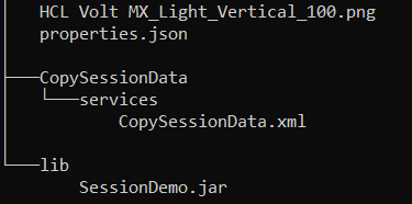

Custom Data Adapter using Java Integration Services
Java services based custom data adapter is similar to foundry app based custom data adapter with a difference of Java service library which will get added to lib folder
Example
Java service custom data adapter folder structure
Custom data adapter based on java services available here customAdapter.zip
Note: Multiple jars are not supported in lib folder of custom Data Adapter

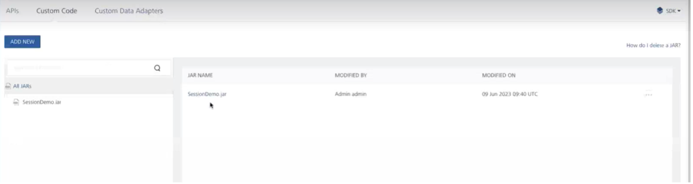

  2. Notice the Custom Code section that is uploaded with the new jar file.
    Note: Here the lib folder is processed, jar file is extracted and it is uploaded in Custom Code section.

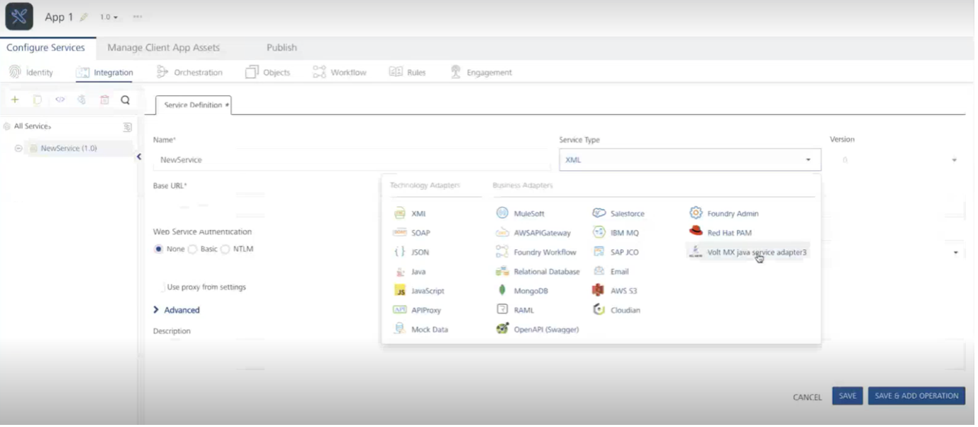

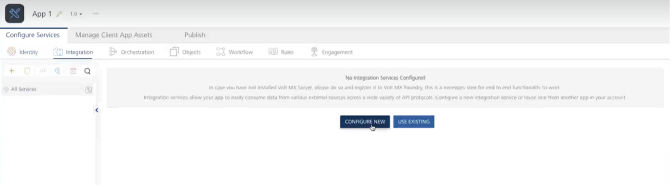

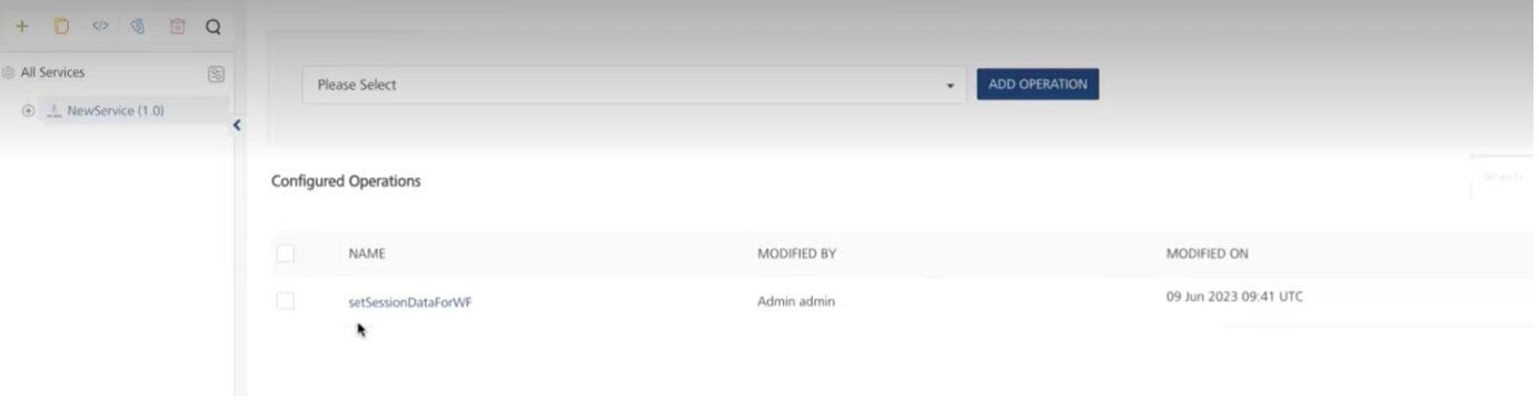

  3. Create a new integration service using this custom data adapter. Save this integration services.
  4. Click Configure New, select Service Type value with that custom data adapter Save the integration service.

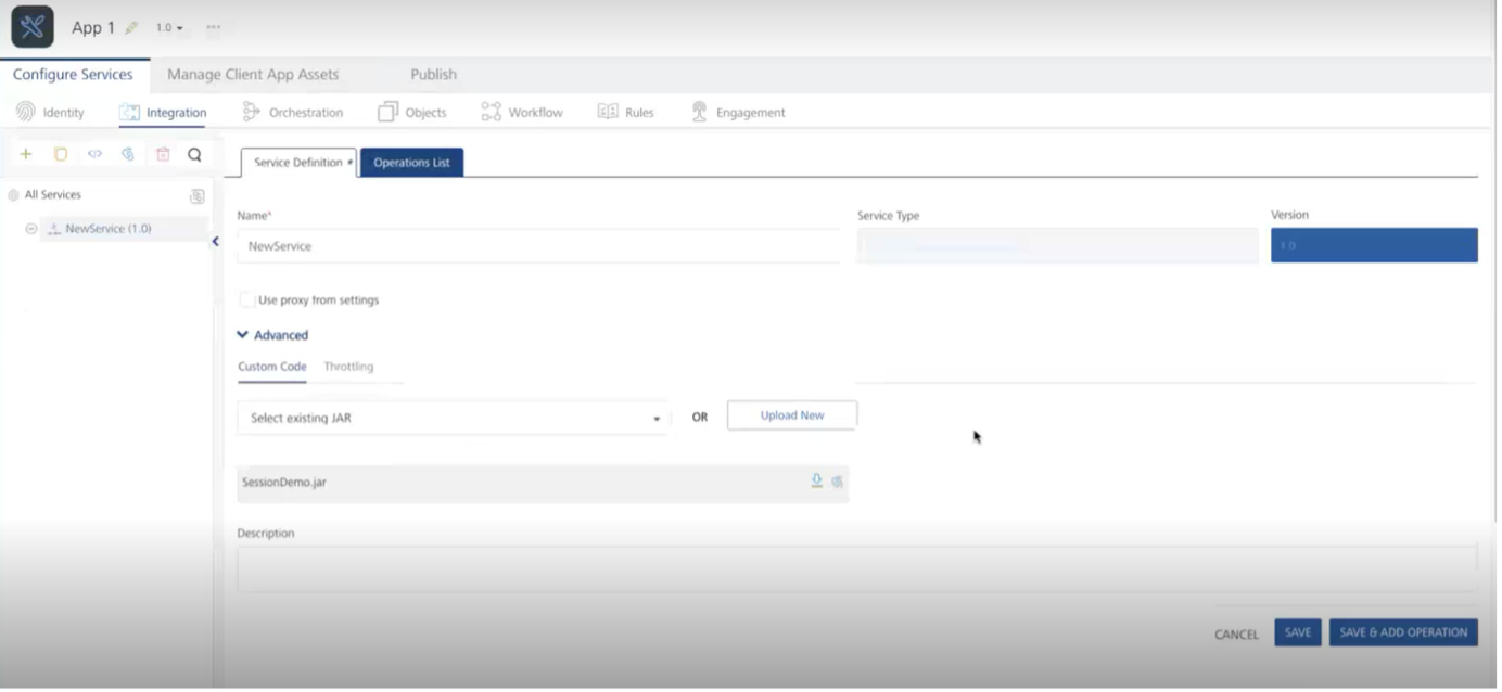

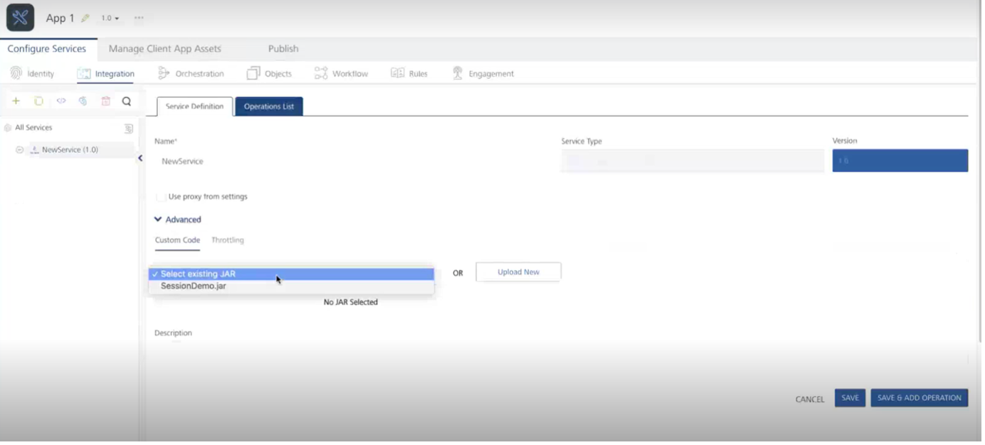

  5. Select the imported jar file and attach it as below:

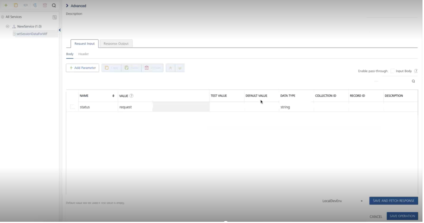

  6. Click Save and Add Operation > select the Services as below > and click on Add Operation.
  7. Select the Configured Operations.
  8. Click on Save and Fetch Response.
  9. Note the Output result.
        "opstatus": 0;
        "httpStatusCode": "0"

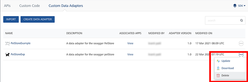

Managing Custom Data Adapters
You can manage your Custom Data Adapters from the API Management section under the Custom Data Adapters tab.
The Custom Data Adapters page on the console has a list of all the existing Custom Data Adapters and their metadata. You can view all the apps associated with any of the Custom Data Adapters. You can also view the Modified On and Modified By details on this page.
You have some additional options available under the ellipsis menu, that is the three dots menu on the right side, for every Custom Data Adapter.
  • Upload to Marketplace - Publish the Custom Data Adapter to the VoltMX Marketplace.
  • Update - Update the existing Custom Data Adapter. Clicking on this option will open a window to import a Custom Data Adapter.
  • Download - Download the Custom Data Adapter as a zip file. The downloaded archive follows the structure mentioned in the Custom Data Adapter Zip Structure section of this document.
  • Delete - Delete the Custom Data Adapter.
