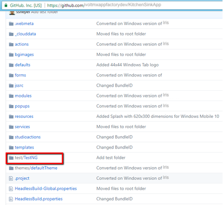

  • Make sure that the Iris project contains the Appium test files at the following location:
    <Project-Root>/test/TestNG/

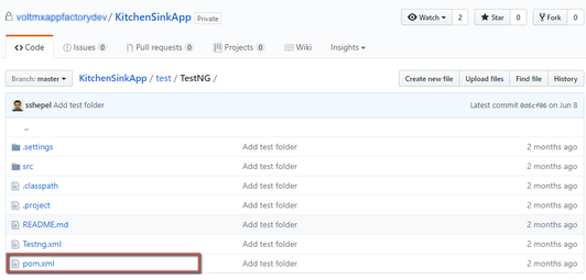

  • Tests must be compiled by using a Maven configuration file (pom.xml) that is available in the Tests root folder (<Project-Root>/test/TestNG)

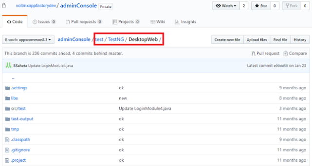

  • Make sure that the Iris project contains the Selenium test files at the following location:
    <Project-Root>/test/TestNG/DesktopWeb/

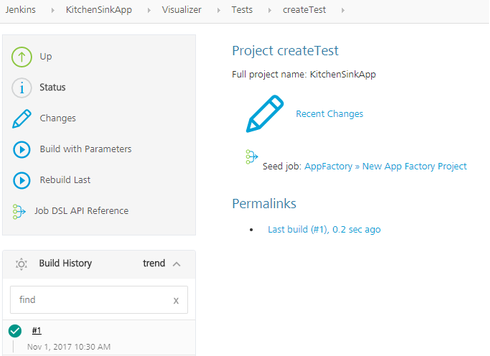

To build and run a test, follow these steps:

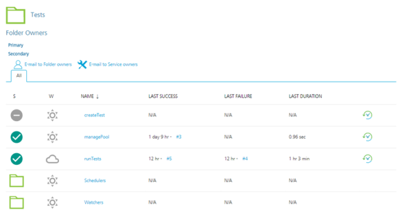

  1. From the Iris folder of your project, navigate to the Tests sub-folder.
  2. For the runTest job, click the Build with Parameters icon on the right side of the row.
    Alternatively, select the runTest job, and then from the left panel of the details page, select Build with Parameters.
  3. Configure the build parameters for the runTest job. For more information about the parameters, refer to the following sections.

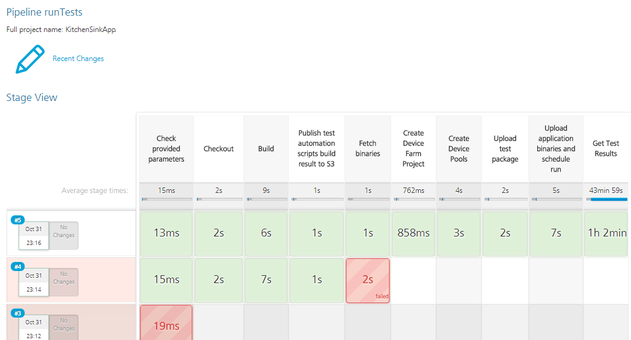

Standard Test Environment Run
The test run process consists of the following steps:
  1. Checkout of test project if GIT_BRANCH and GIT_CREDENTIALS are selected.
  2. Build the test project
  3. Publish test binaries at S3 based on the <S3 bucket>/<project name>/Tests/runTests/<build number>/KitchenSinkApp_TestApp.zip. For example: https://s3-eu-west-1.amazonaws.com/ voltmxdemo/KitchenSinkApp/Tests/runTests/4/KitchenSinkApp_TestApp.zip
  4. Fetch binaries to run them in AWS Device Farm
  5. Create a project in AWS Device Farm
  6. Create a device pool at AWS Device Farm, taking a device list selected from the configuration
  7. Upload test binaries to the Device Farm
  8. Upload application binaries to the Device Farm and schedule a run.
  9. Retrieve the test results.
Usually, the test run process takes around 20 minutes per each device in the device pool. Only the devices that are available in the Device Farm are used for testing. All unknown devices are skipped. If a particular application binary is missing, the devices for that channel are skipped from the test run.

    Note: Ensure that pom.xml is present in the required directory.

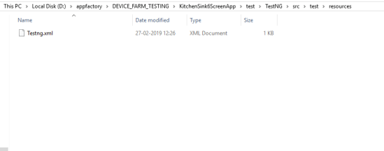

  • Write the required TestNG XML and place it at <root_test_folder>/src/test/resources location.

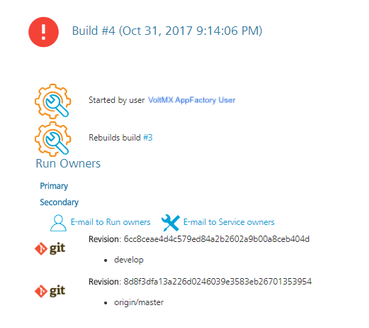

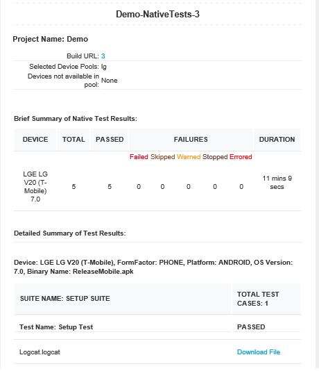

When the project test build is complete and the test results are published at S3, e-mail notifications are sent to recipients:
On unsuccessful build for the tests run, the following e-mail is sent to the recipients:
In the final stage, the consolidated test run status is notified via e-mail. Refer the following screenshots for the sample email for consolidated status.
Sample email for Native tests
To download test data fetched from AWS Device Farm, click Download File link. Data is stored at S3 and available for review without time limitations.

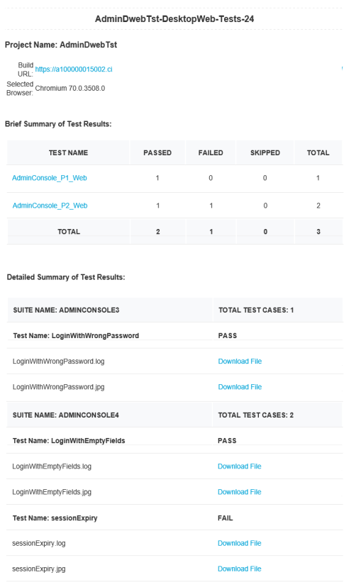

Desktop Web Test Results
Sample email for DesktopWeb tests
The summary of the test results are shown based on the tests executed on specified browser that includes passed, failed, skipped. Usually the tests are skipped when the driver initialization fails.
You can click the respective links in Brief Summary table to view the test summary.
To download the log files for each test case, click the respective Download File link. If you have any test failures, you can use these files to debug them.

SKIPPED: Following are the scenarios where a test case can be skipped while testing, and the status of the test result can be SKIPPED.
  • AWS Issue: AWS skips the test cases yet to run when the duration of the test run exceeds 150 minutes (AWS Device Farm default time limit) resulting in the SKIPPED status. This is applicable only for Native test results.
  • TestNG issue: There are various scenarios where TestNG can skip the test cases during a test run. The most common scenario is, if a parent test case fails for any reason, TestNG will skip all the related child test cases, and the status of the test result is SKIPPED.
WARNED: The status of the test result is WARNED when the device farm returns any warning due to the issues from AWS.
STOPPED: The status of the test result is STOPPED when you abort the test case forcefully.
ERRORED: The status of the test result is ERRORED when the device farm returns any error due to the technical issue on AWS.
Note: WARNED, STOPPED, and ERRORED statuses are not applicable for DesktopWeb tests.

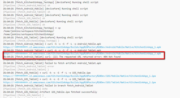

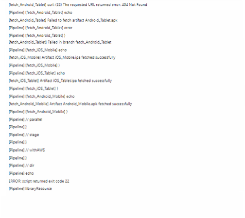

The builds that failed during the test can be tracked for the issues that caused the failure. For example, consider build #4 from the following screenshots of runTests job. To troubleshoot the issue, follow these steps.
  1. From your project folder, navigate to Iris > Tests.
  1. Select the runTests job, and then find the failed build.
    For example, find and click the link for build #4.

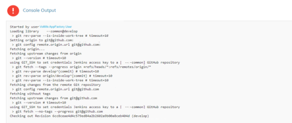

  1. From the details page of the failed build, select the Console Output on the left panel. The Console Output Log opens in the right pane.
  1. Scroll to find errors in the log that caused the build to fail. For example, you can trace an error that is related to invalid Android Tablet URL.
  1. Check if the ANDROID_TABLET_NATIVE_BINARY_URL parameter is valid.

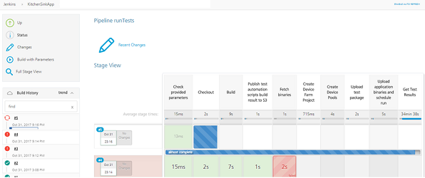

Alternatively you can troubleshoot the issue from the stages of Manual Testing.
To troubleshoot the issue from the Stage View, follow these steps:

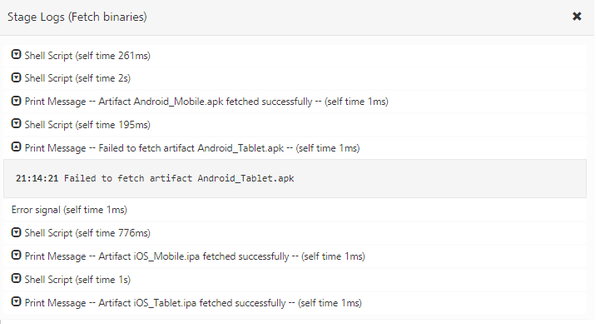

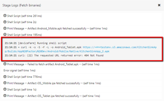

  1. From the Stage View, point to the failed stage, and then click Logs.
  2. From log messages in the Stage Logs window, identify the error message that corresponds to the failure of the build.
  1. Check whether the ANDROID_TABLET_NATIVE_BINARY_URL parameter is valid.

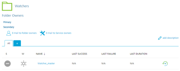

Auto Triggering Tests

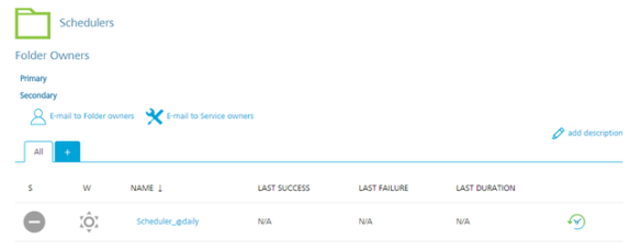

Currently, there are two types of auto-triggered test jobs: scm-triggered (Watchers) and cron-triggered (Schedulers). Every project structure has folder called "Tests" in "Iris" sub-folder, that contains job for creation of auto-triggered jobs (createTrigger) and two sub-folders where created jobs are stored.
To setup auto-triggered job, perform the following steps:
  1. Go to Tests folder under project's root folder.
  2. Click on createTest job.
  3. Provide all required parameters (they are the same as in "Facade" job).
    Important: Please note, that there is one additional parameter, which is called "CRON_SCHEDULE". If "CRON_SCHEDULE" parameter is given, then a cron-triggered job is created and stored in "Schedulers" sub-folder. If the parameter is not provided, a scm-triggered job is created and stored in "Watchers" sub-folder.
  4. Check that the createTest job is complete.
    Important: Every Scheduler that is created, will have cron string in job's name to simplify the job search. Refer the image below.
    Important: Every Watcher that is created contains the branch name in the job name to simplify job search.
