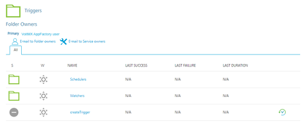

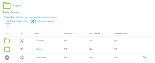

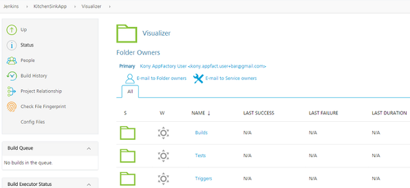

Every project contains a sub-folder called Triggers in the Iris folder. The Triggers folder contains a job called createTrigger (to create auto-triggered jobs), and two sub-folders called watchers and schedulers (to store the created jobs).

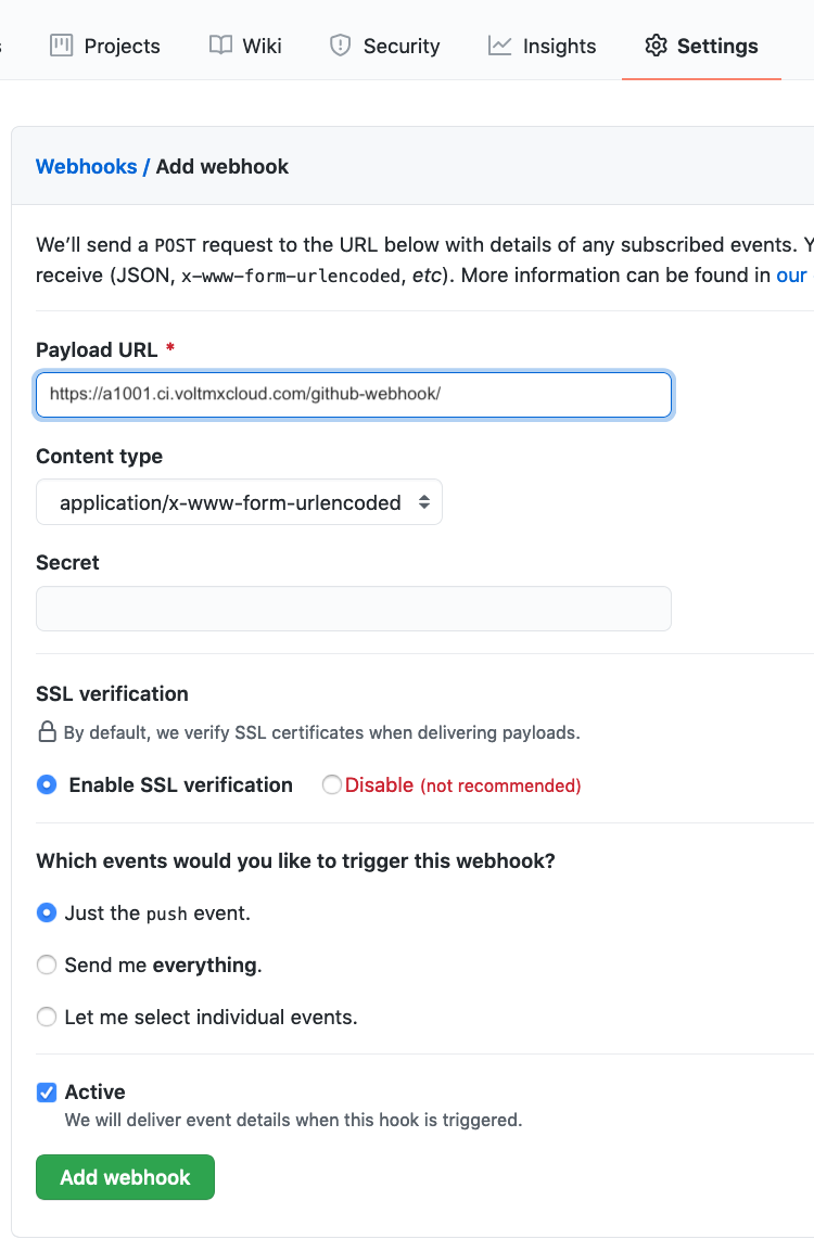

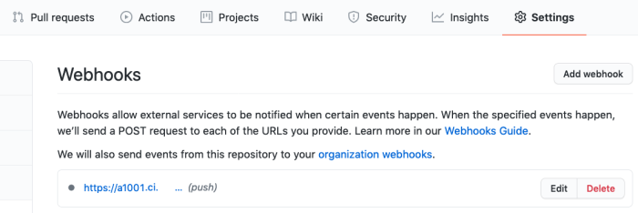

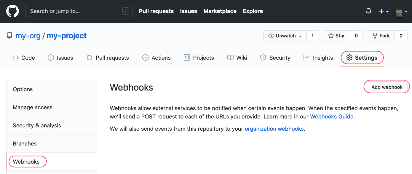

  1. Open your GitHub repository in a web browser, navigate to Settings → Webhooks, and then click Add webhook.
    The Add webhook page opens.

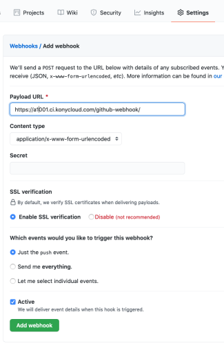

  2. Configure the following parameters in the Add webhook page:
    • Set the Payload URL to: https://<App Factory domain>/github-webhook/
      For example: https://a1001.ci.voltmxcloud.com/github-webhook/
      For more information, refer to Payload URL Format.
      Note: The last forward slash in the Payload URL is mandatory.
    • Content type must be application/x-www-form-urlencoded
    • Jenkins verification does not require a Secret. Leave the field empty.

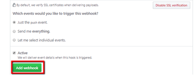

    • Select the Just the push event option. Only pushes of code to a specific branch trigger the Flyway job.
    • The Active option should be marked by default.
  3. After you configure the necessary parameters, click Add Webhook.
    The webhook is created.

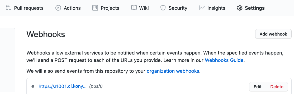

  1. You can Edit or Delete a Webhook by clicking the respective button. For more information about Webhooks, refer to the GitHub Webhook Documentation.

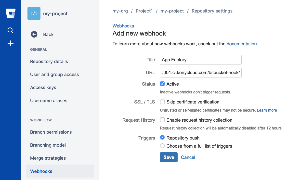

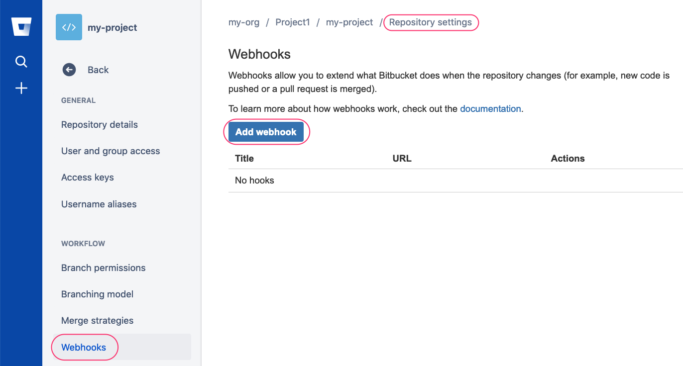

  1. Open your BitBucket repository in a web browser, navigate to Repository Settings → Webhooks, and then click Add webhook.

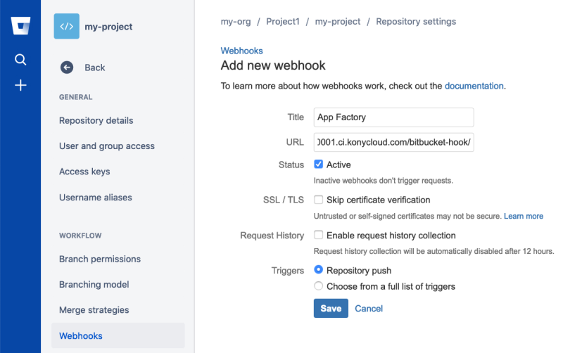

  2. On the Add new webhook page, configure the following parameters:
    • Set the title to App Factory
    • Set the URL to: https://<App Factory domain>/github-webhook/
    • Leave the status set to Active
    • Select the Triggers option for Repository push
  3. After configuring all parameters, click Save.

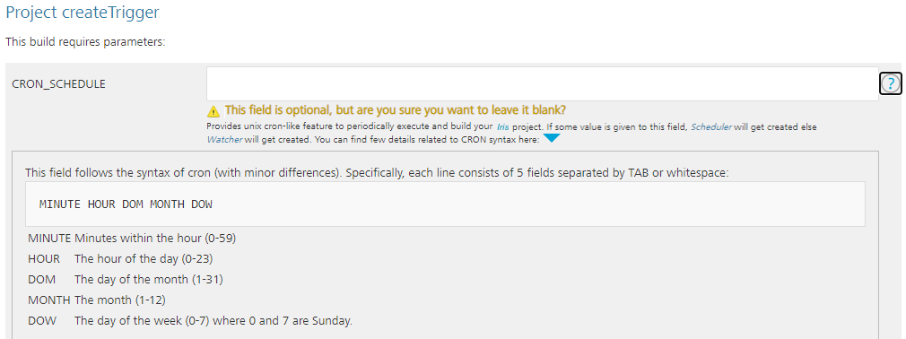

  1. From the folder of your project, navigate to the Triggers sub-folder.
  2. In the Triggers folder, click the build icon for the createTrigger job.
    Alternatively, select the createTrigger job, and then select the Build with Parameters option from the left panel.
  3. For the CRON_SCHEDULE parameter, make sure that the field is blank.
  4. Configure the remaining parameters, which are the same as the buildIris job.

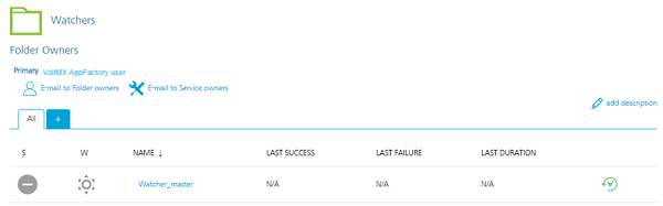

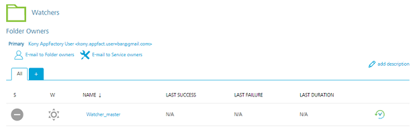

    Jobs that are triggered by a push to the SCM are stored in the watchers folder. Every Watcher has a branch name in the name of Job to simplify job search.
