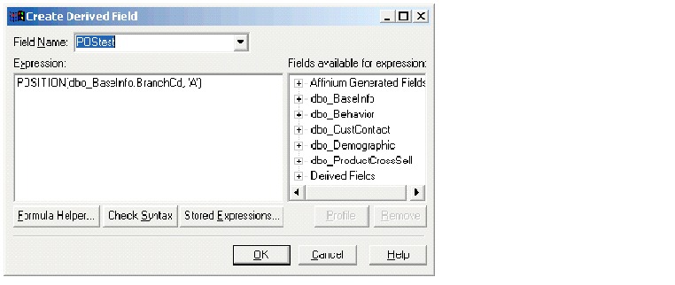

Examples
A
', within the value
of the column, dbo_BaseInfo.BranchCd
, and assigning
the returned value to a derived filed POStest
The following example shows a few rows from the table
with the values from dbo_BaseInfo.BranchCd
and POStest
shown
side-by-side.
