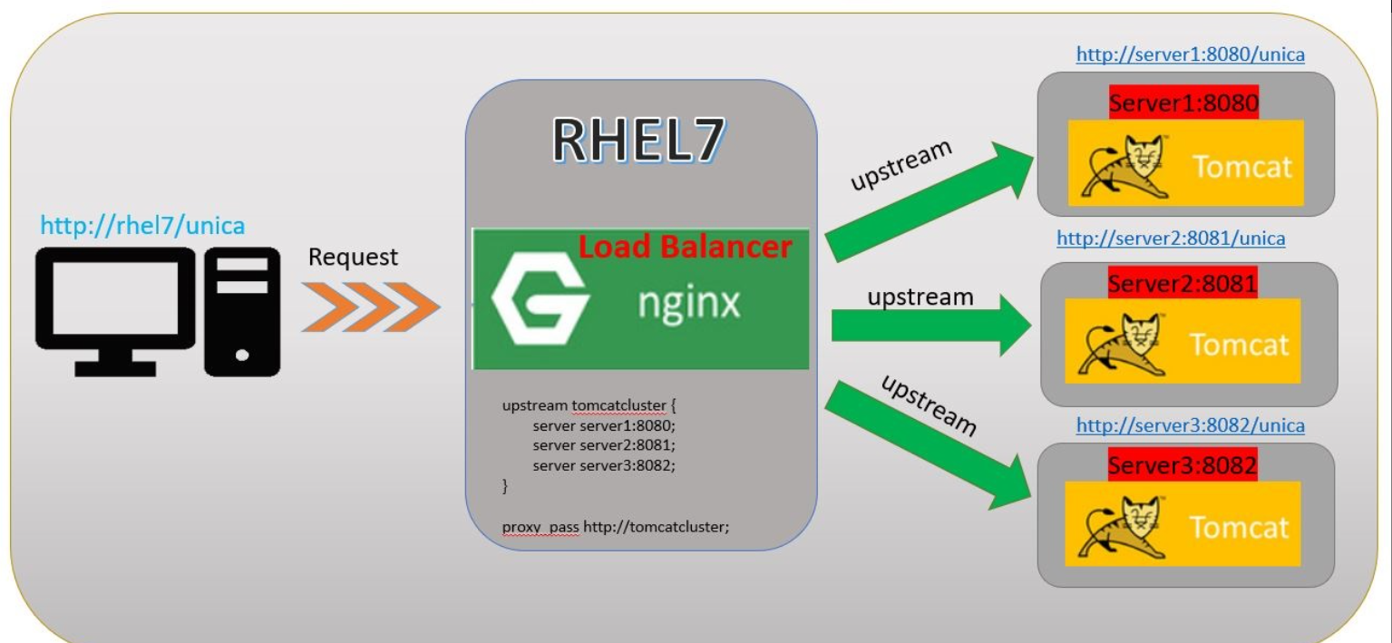

Architecture
Steps to Follow
  1. Tomcat Installation - server1
    Download and install Tomcat server and listen on 8080
  2. Tomcat Installation - server2
    Download and install Tomcat server and listen on 8081
  3. Tomcat Installation - server3
    Download and install Tomcat server and listen on 8082
  4. Tomcat server1:8080
    Install and deploy both HCL Unica Platform and Campaign and make it work with 8080 port.
  5. Tomcat server2:8081
    Install and deploy HCL Unica Platform only and make it work with 8081 port.
  6. Tomcat server3:8082
    Install and deploy HCL Unica Platform only and make it work with 8082 port.

         Upstream tomcatcluster
                  Server server1:8080 weight 3;
                  Server server2:8081;
                  Server server4:8082;
