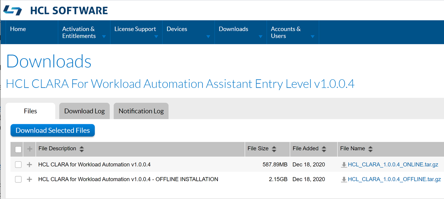

From HCL License Portal download the appropriate Clara installation package. Depending on your license type, you have two different options:
HCL CLARA for Workload Automation Assistant Standard Level v1.0.0.4
HCL CLARA for Workload Automation Assistant Entry Level v1.0.0.4

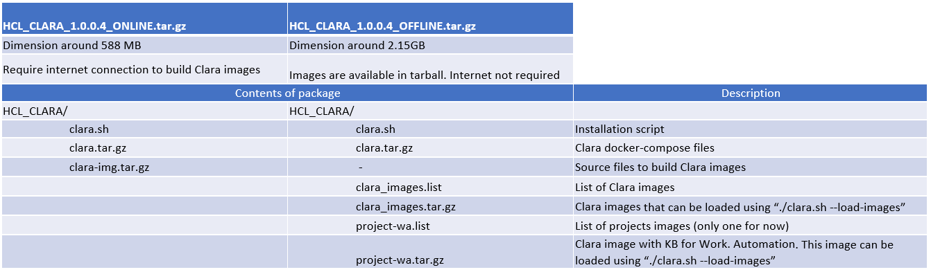

Each option is available with 2 different types of installation packages: online and offline.
Use the online installation package to build Clara images directly on your machines. This type of package requires a working Internet connection.
Use the offline installation package if the machine does not have an Internet connection or if you do not want to build Clara.
The following table summarizes the content of the 2 different types of packages:
