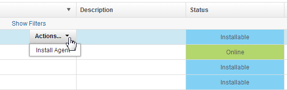

    • If you know the target host, click Install New Agent.
    • To install an agent that was discovered with the agent discovery feature, click the Install Agent action for the agent. Discovered agents have the Installable status.
    For information about the agent discovery feature, see Discovering agents automatically.Install Agent action for an agent with the Installable status
