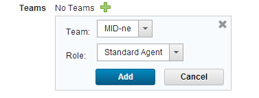

  6. Optional: Check Assign Team to assign the agent to a team.
    The parameters that are used to assign an agent to a team
    1. Click Add .
    2. Select the team to which you want to assign the agent from the Team list.
    3. Select the agent role from the Role list.
      For information about teams, see Assigning teams directly to items
