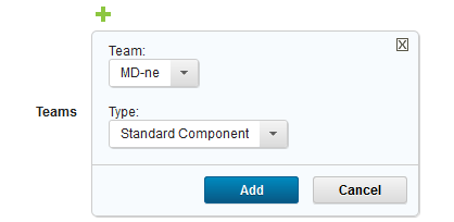

In the following figure, the Teams field is displayed in the Create Component window.
Click the plus-sign
, and then select a team from the Teams list.
- Select a security type for the object from the Type list. The type defines the set of object permissions that are available to the team. Security types for the current object type are available. Initially, a type of object, such as components, has a single type that is defined for it, the standard type. For information about security types, see Security types.
- Click Add. More than one team can

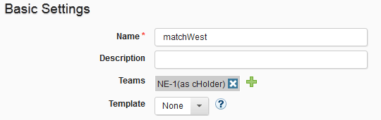

be added to an item.The selected team or teams can interact with the object immediately. Teams and their security type are listed on the Configuration page that is associated with the object. In the following figure, the NE-1 team with the cHolder security type is assigned to a component.
- To remove a team from an object, click the cancel icon
