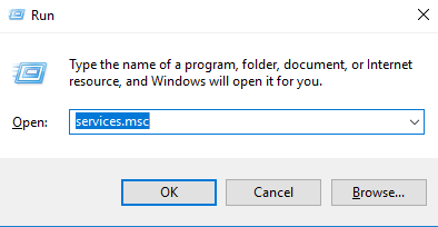

  1. Press Windows+R, type services.msc and press Enter.
    Figure 1. MongoDB Installation - Enterprise Version (HA) (Cont.)

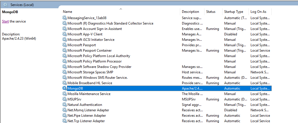

  2. Search for MongoDB service, then click on it and click Start the service on the Left pane.
    Figure 2. MongoDB Installation - Enterprise Version (HA) (Cont.)
    A screenshot of a computer Description automatically generated
    These above steps must be performed on all the servers that are part of the replica set.
