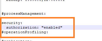

  4. Make the following changes in mongod.cfg. Refer the screenshot below:
    Uncomment the security section, which can be found around line 24, and add the following configuration as shown below:
    security:
    authorization: “enabled”
    Make sure to maintain proper indentation.
