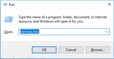

  1. If root cause is ‘Not able to reach the component’ then check if the EmailService service is up or not. For that, go to the server where services are installed. Open ‘services’ by pressing win+R, type ‘services.msc’.

    1. Click Win+R. Type services.msc and click OK.

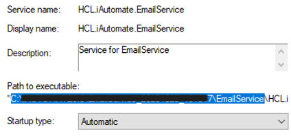

    2. Locate HCL.iAutomate.EmailService. Right Click on service (HCL.iAutomate.EmailService), and click on Properties. Copy Path to Executable as shown below.
      Figure 4. EmailService: Scenario 2
    3. Open the selected folder. Locate HCL.iAutomate.EmailService.Service.Host.exe.config file.
    4. Open this config file in Notepad and search for key ‘ServiceHostURL’. The value corresponding to this key is the heartbeat URL.

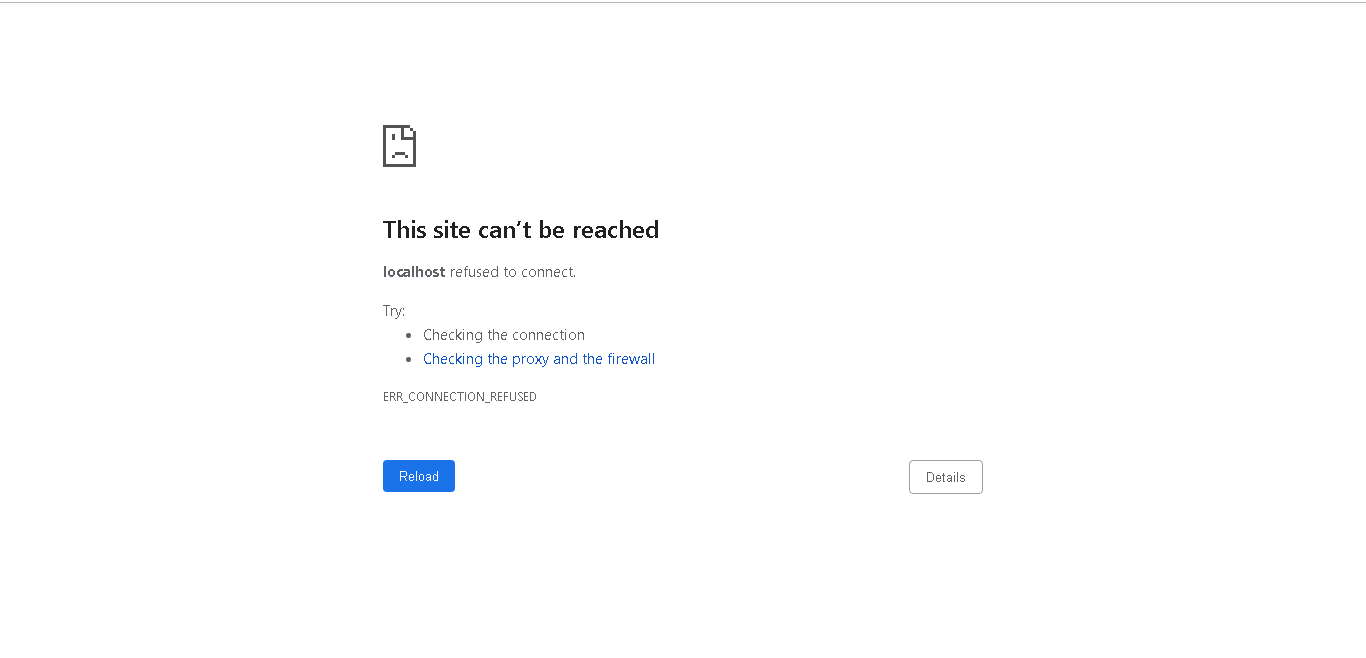

  5. Paste the URL on the browser. If the following page appears, it means the service is not running or there is some issue with EmailService.
    Figure 5. EmailService: Scenario 2

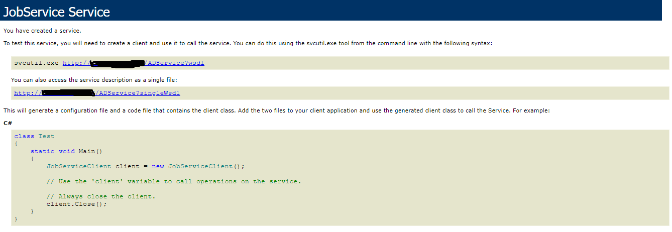

  6. If the following WSDL gets loaded, it means that the service is running as expected.
    Figure 6. EmailService: Scenario 2
