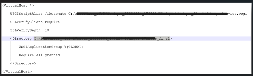

  1. Check for Existence of the file iUnique.conf at location <Apache_Root_Folder_Path>/conf.
  2. At the bottom of iUnique.conf file you will find the path to the python files as highlighted in the below figure.
    Figure 1. HCL.iAutomate.iUnique(cont.)

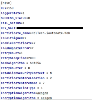

  3. Open the file iUnique.cfg from the location <highlighted_path_in_fig_000>/config and search for any duplicate keys present in the file. You can refer below keys for reference:
    Figure 2. HCL.iAutomate.iUnique(cont.)
  4. Remove the last entry that is duplicate for each key. In the above case delete the second entry of VALUE = 20000, VALUES = 200000, EncryptionAlgorithm = aesgcm. Similarly check for any other duplicate keys and remove the last entry and save the file.
