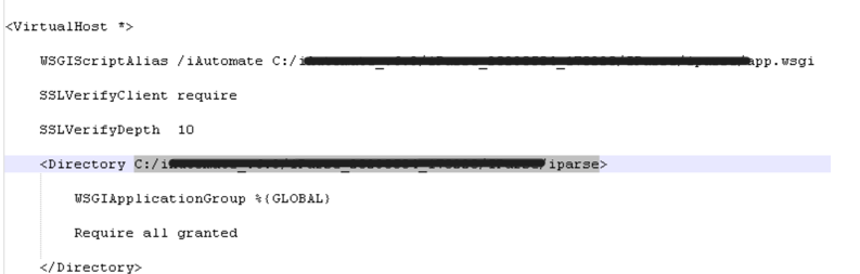

  1. Check for existence of the file iParse.conf at location <Apache_Root_Folder_Path>/conf.
  2. At the bottom of iParse.conf file you will find the path to the python files as highlighted in the below figure.
    Figure 1. HCL.iAutomate.iParse(cont.)

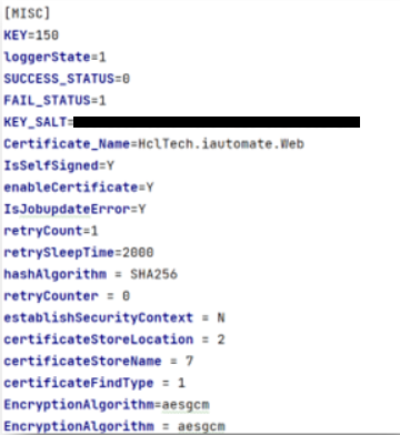

  3. Open the file Parse_data.cfg from the location <highlighted_path_in_fig_000>/config and search for any duplicate keys present in the file. You can refer to the keys below for reference:
    Figure 2. HCL.iAutomate.iParse(cont.)
  4. Remove the last entry that is duplicate for each key. In the above case delete the second entry of EncryptionAlgorithm = aesgcm. Similarly check for any other duplicate keys, remove the last entry, and save the file.

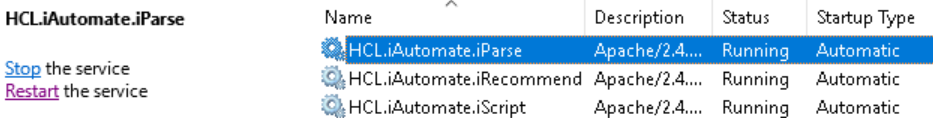

  5. Finally restart the service named HCL.iAutomate.iParse
    Figure 3. HCL.iAutomate.iParse(cont.)
