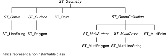

The ST_Geometry data type is an abstract noninstantiable superclass. Its subclasses provide instantiable data types. As such, you can define table columns to be of such types. The following figure shows the class hierarchy for the Informix® spatial data types.
Figure 1. Data types class diagram
The ST_Geometry type has four subclasses: ST_Curve, with a subclass of ST_LineString; ST_Surface, with a subclass of ST_Polygon; ST_Point; ST_GeomCollection with three subclasses. The subclasses of ST_GeomCollection are: ST_MultiSurface, with a subclass of ST_MultiPolygon; ST_MultiCurve, with a subclass of ST_MultiLineString; and ST_MultiPoint. Only classes without subclasses are instantiable.
