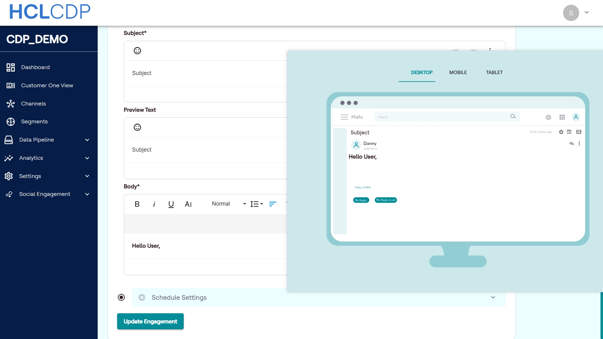

Template Preview
You can preview your email templates by hovering over Show Preview to see how the email will appear on different devices. The preview updates in real-time, and you can switch between Desktop, Mobile, and Tablet views.
If you make changes in the template's code view, click the code view icon again to save the updates.
