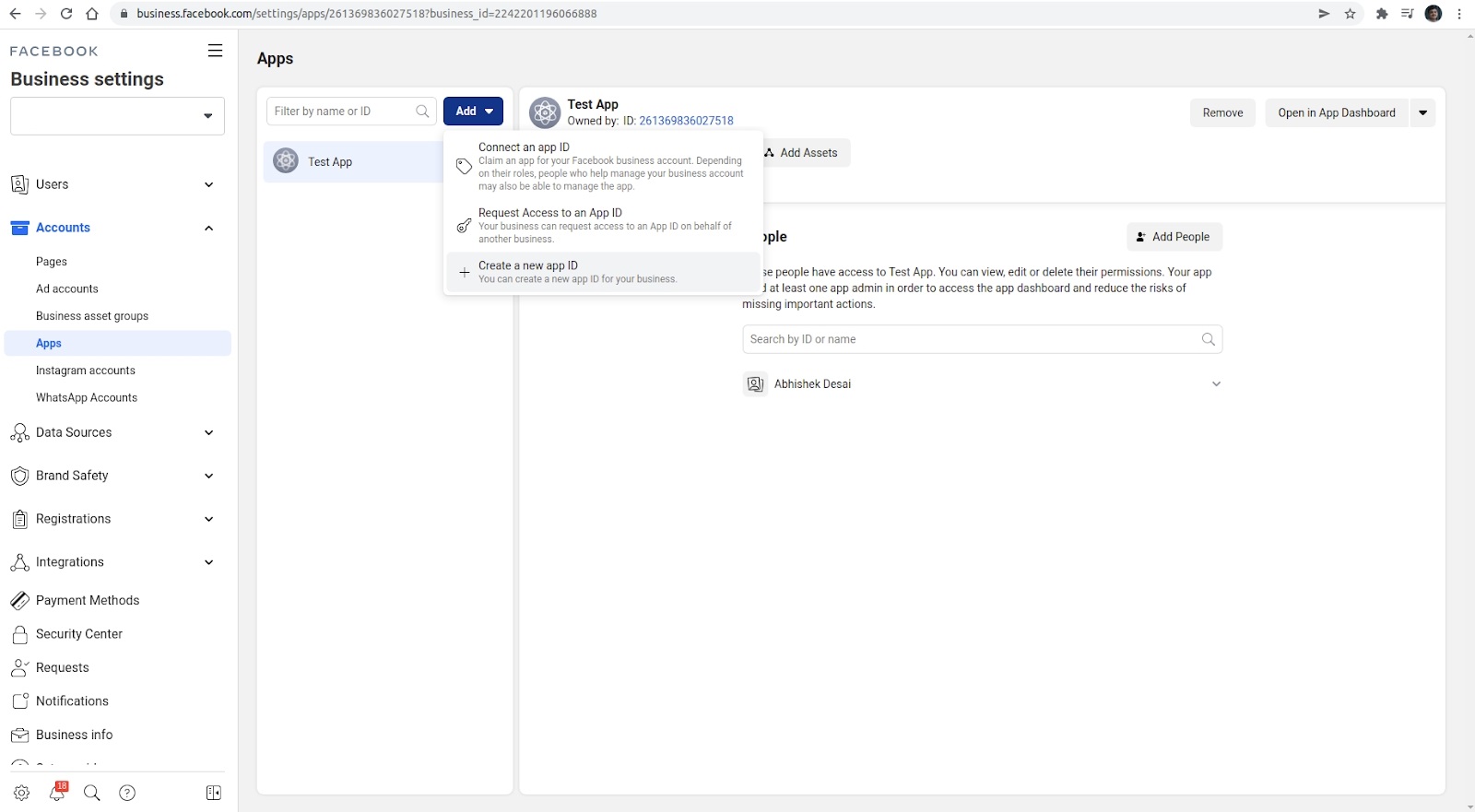

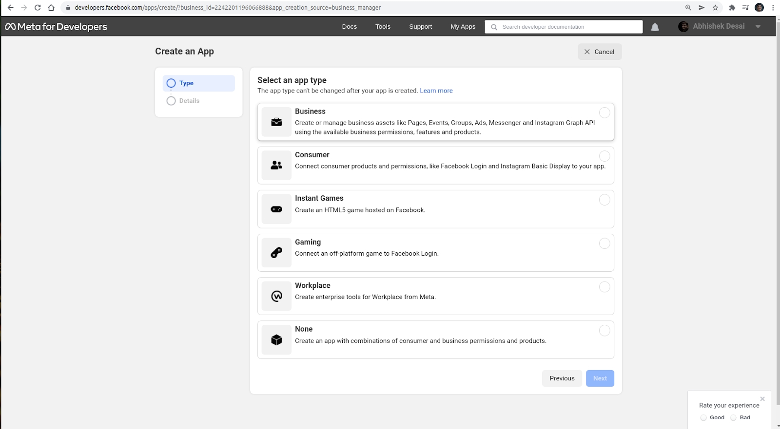

  1. On the Facebook Business Manager, navigate to Apps > AddButton > Create a new App ID.
  2. Select Business as the App Type, and click Next.

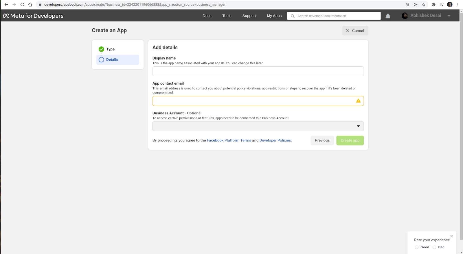

  3. Provide the appropriate DisplayName, and App contact email, and click Create App.
The next step is to create a System User. If you already have one, skip directly to the generate access token.

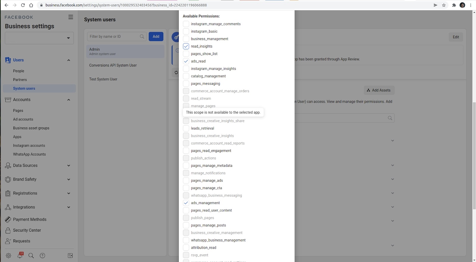

Generate System User’s Access Token:

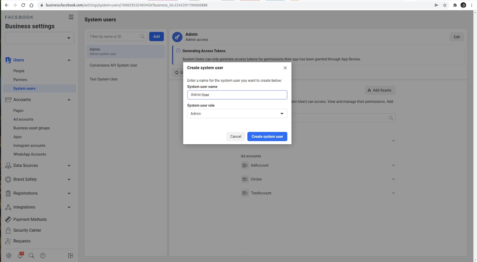

  1. On the Facebook Business Settings page, click Users > System Users > Add, type the appropriate name, and select Admin as the user role.
Generate Access Token

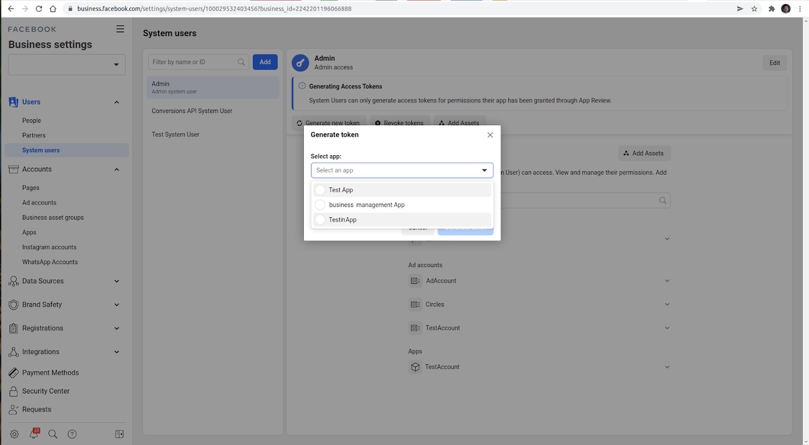

  1. Navigate to System Users tab, click Admin System User > Generate new token, and select Business App from the drop-down list.
  2. Select read_insights, ads_read, and ads_management from the list of Available Permissions, and then click Generate AccessToken.
  3. Copy the Access Token displayed in the dialog box and share it with the HCL CDP team.
    Tip:
    Make sure to save the token after generating it, as it will not be visible in the UI later.

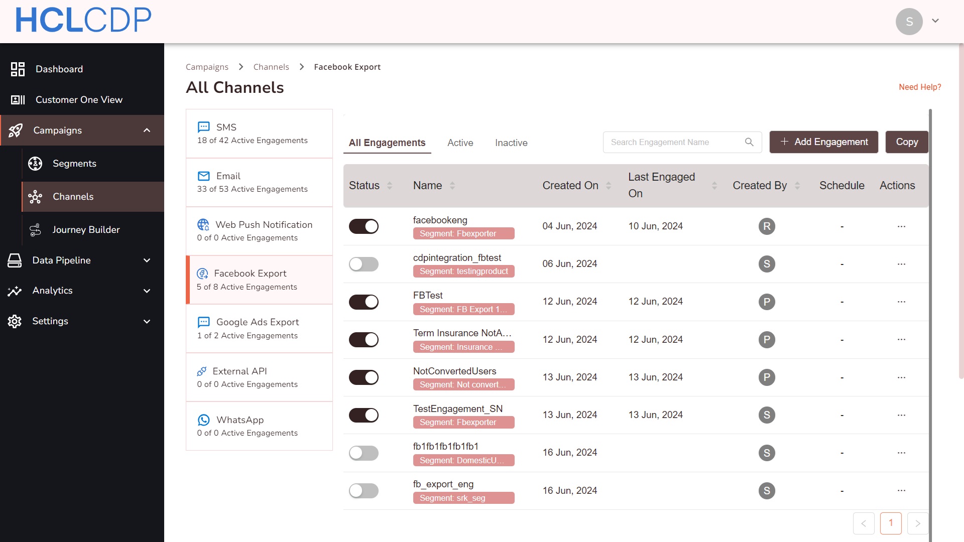

  1. Navigate to HCL CDP > Activate drop-down> Channels. The Channel Summary tab opens by default.
  2. Click Facebook Export tab or click icon in the Facebook Export tab in the dashboard.

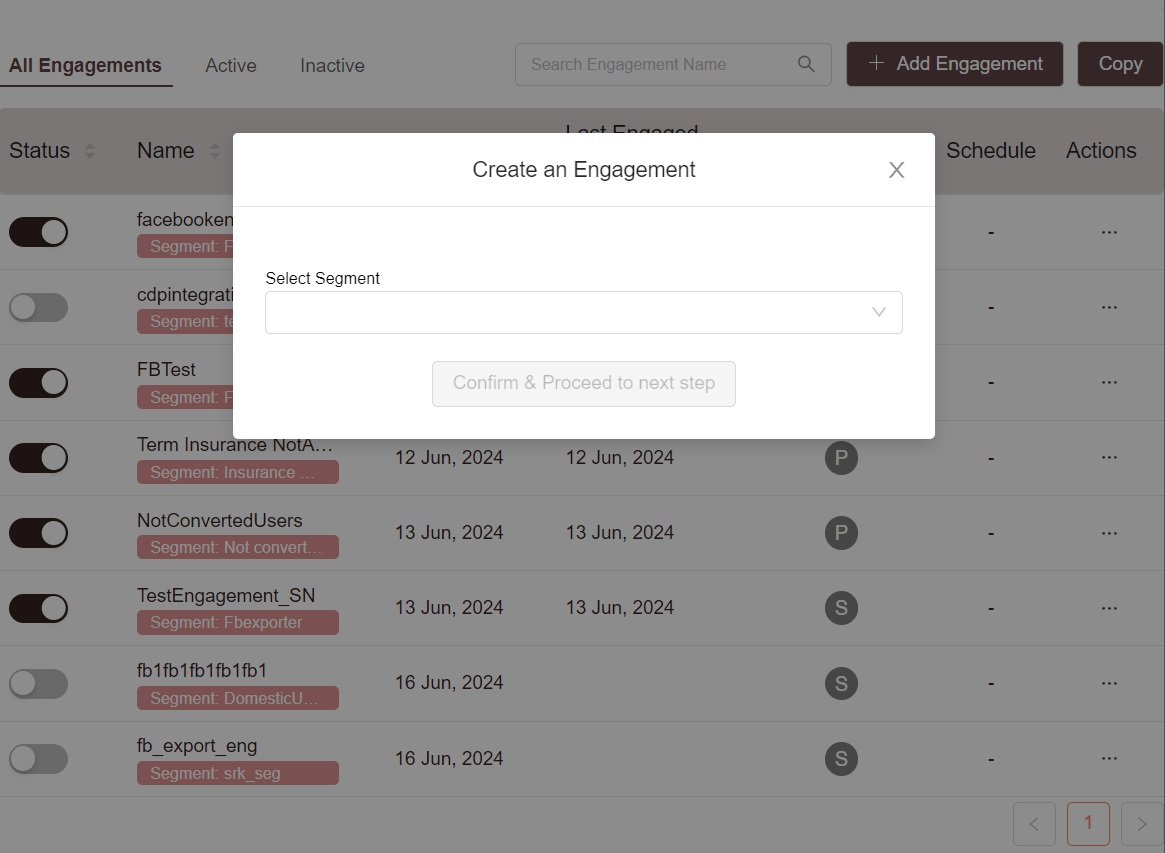

  3. Then, click +Add Engagement. A Create an Engagement pop-up appears.
  4. Now, select a segment from the Select Segment drop-down.
  5. Click Confirm and proceed to the next step.

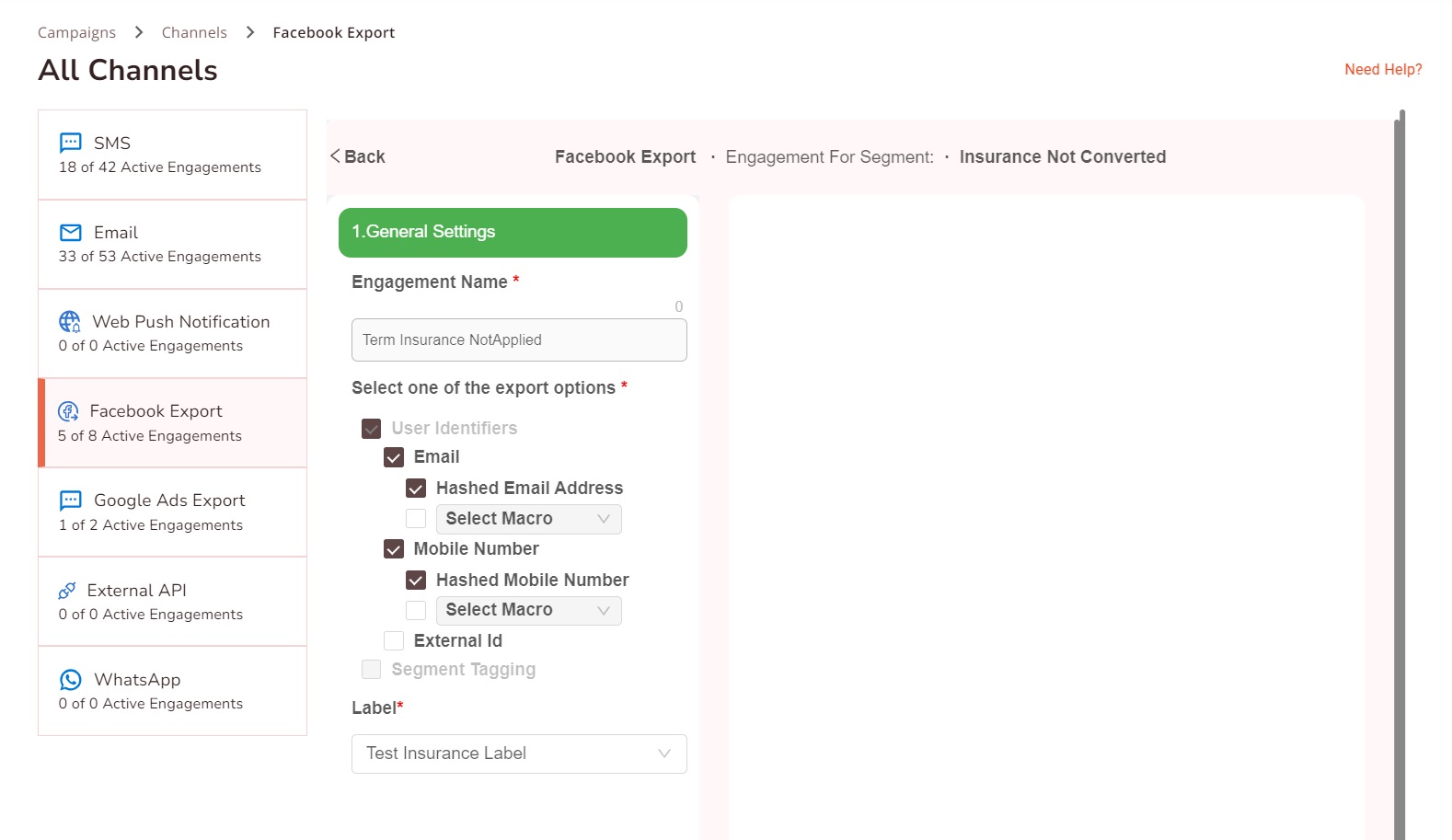

  6. In the General Settings section, enter engagement name in the Engagement Name text box.
  7. Check the box and choose one of the export options to specify your export.
  8. In the Select Label drop-down list, select the desired label.
  9. Click Save to complete your engagement, which will now appear under the Facebook Export tab.
  10. In the Status column, you can activate or deactivate the engagement at any time using the toggle switch.

  1. Under User Identifiers, select the External ID checkbox, when creating a Facebook Export engagement.
  2. Check the HCL CDP User ID checkbox to send the unique user ID to Facebook.
  3. If you want to send your own user ID stored in the user profile, choose the appropriate variable from the Select Macro drop-down.
