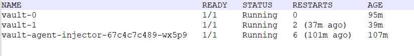

  4. On successful installation of the vault, you can verify the installation using the below command.
    oc get pods --namespace vault
    Note: After installation, make sure to unseal the vault as shown below. Otherwise, the pods will keep restart.
