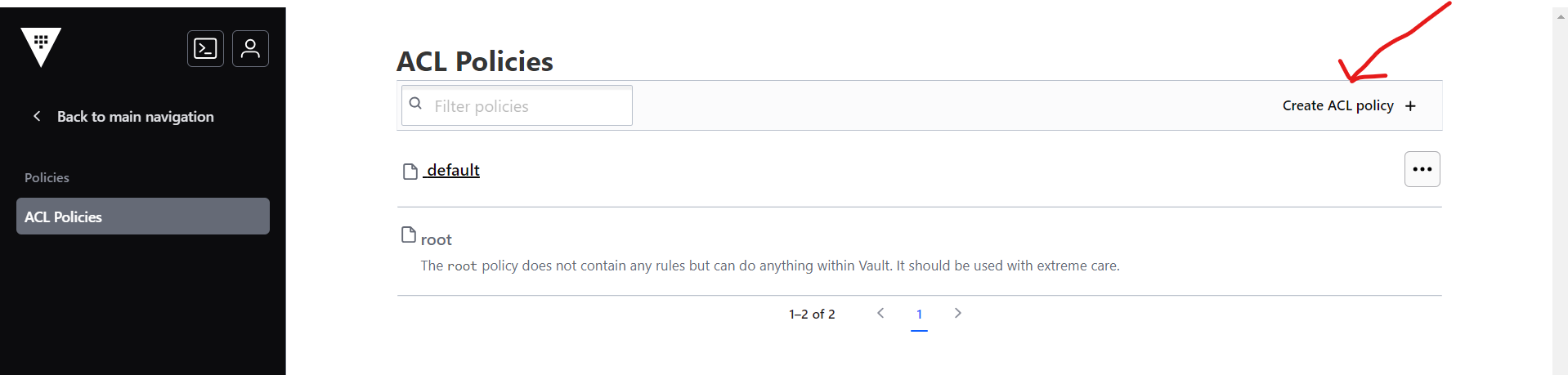

Create User Policy
After creating secret folder, you can create policy to access the secrets from Vault.
- In the Vault UI, click Policies.
- In the ACL Policies section, click Create ACL policy.
- As a result, the Create ACL Policy section will be displayed. In the Create ACL
Policy section, enter policy name and policy as shown below.
path "CDP_Secrets/data/*"{ capabilities = ["read"] }
- Click Create policy to create the policy.
