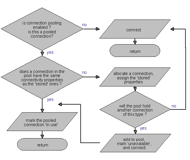

Connection pooling primarily affects the first three steps during which the connection is established. While the presentation material contains material pertaining to each step, the diagram that follows details the connection pooling process.
One goal of connection pooling is to minimize any adverse impact on performance. For this reason, all code which utilizes a connection handle, must determine quickly if pooling is enabled and if a given connection handle refers to a traditional connection or a pooled connection.
The connection pool is subdivided based on connectors. There is a portion of the overall pool for each connector type used. The pool is configurable on a per connector basis. The default pool maintains 20 connections for any given connector. Connections are not established until requested by the users program. Additionally, new connections are not created unless no applicable connection is available in the pool. The pool may be configured to limit the total number of connections for an individual connector as well as limit the number of identical connections. A connection's individuality is based on its connectivity parameters or credentials. Connections are considered to be identical when they are for the same connector and all of the connectivity properties match. The matching criteria is also used to determine if a connection in the pool satisfies a user request for a connection.
Connection pooling flow diagram bmp
When a connection is first allocated, the connection pool is checked to verify that pooling is enabled and the pool has as least one connection of the requested type: DB2®, Oracle, SAP, and so on.
  • The pooling code creates a facsimile of a connection and returns its handle in place of a real connection handle. The purpose of this facsimile is to emulate a connection while the user assigns the connectivity properties. The properties must be kept separate from a real connection until the request to establish a connection to the external system.
  • When connect request occurs, the properties held in the facsimile are used to locate a matching connection in the pool. Assuming one is found, it is returned. Otherwise, a new connection is created returned.
  • If the pool is full, the newly created connection is not pooled. The LC API can quickly differentiate between pooled and non-pooled connection permitting them to be mixed freely. The user is unaware that a request for a pooled connection was actually served by an unpooled connection. The only evidence would be the absence of any performance gains associated with pooling.
