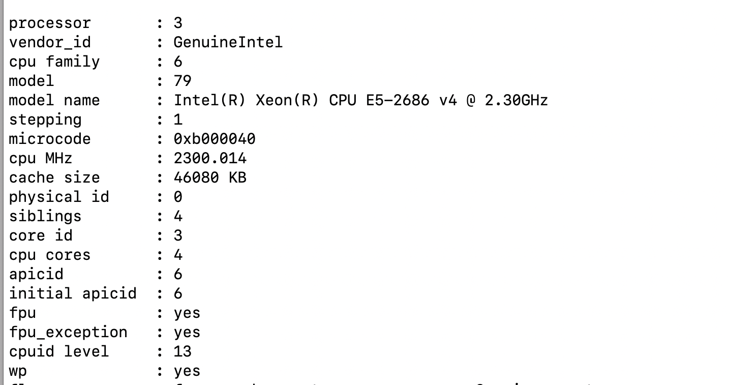

Processor details

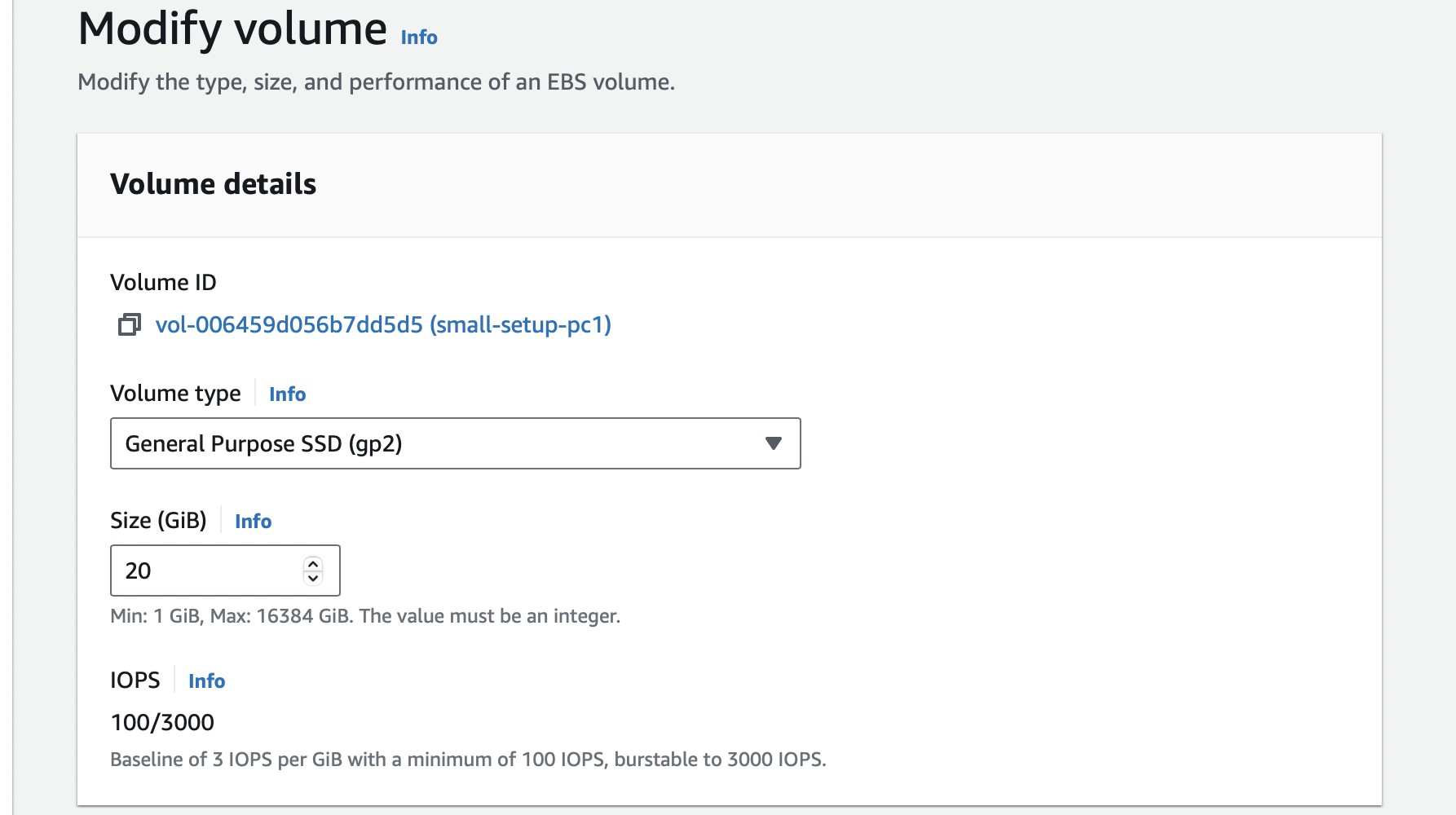

Volume details

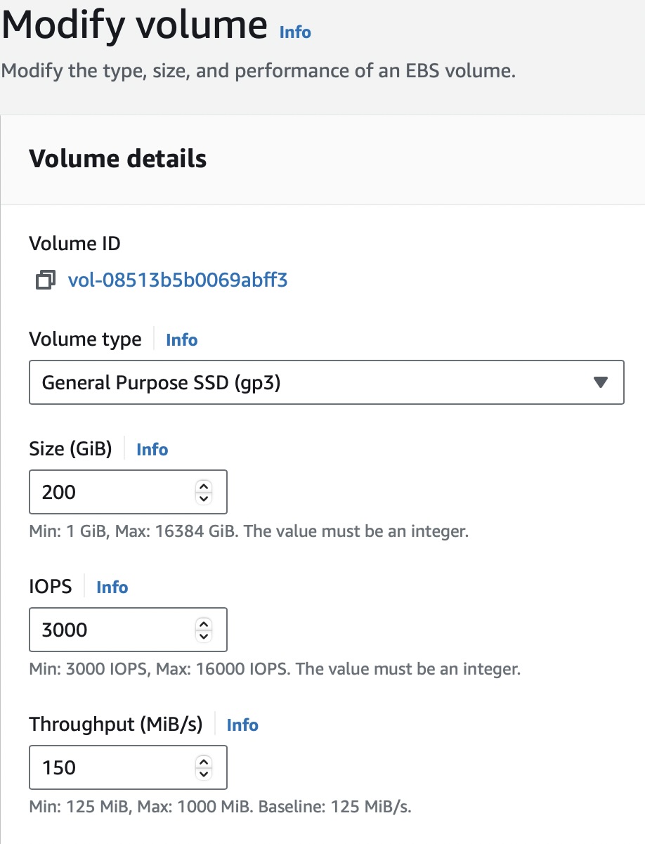

Volume details

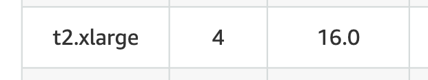

Instance details
Processor details

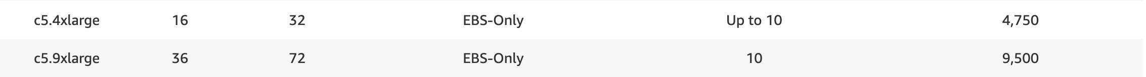

The Kubernetes platform ran on an Amazon EC2 instance with the DX images installed and configured. In AWS/Native Kubernetes, the tests were executed in EC2 instances with one c5.xlarge master node instance. The test started with a c5.2xlarge node and moved to a c5.4xlarge node. After analyzing test results and further observations, the test moved and settled with a c5.9xlarge node. Refer to the following node setup details:

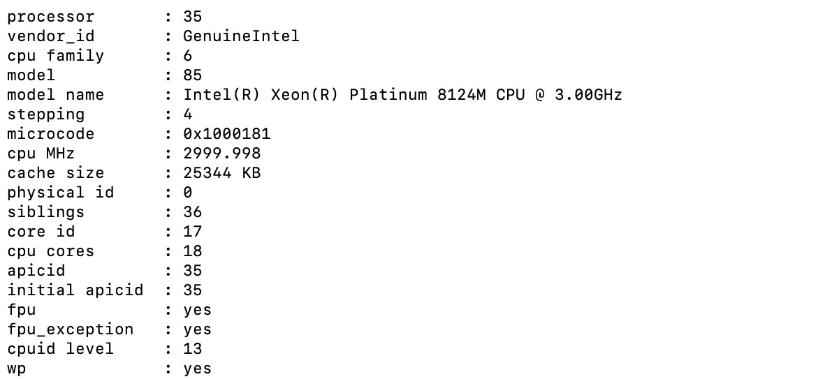

c5.9xlarge node
Node details
Processor details
Volume details
