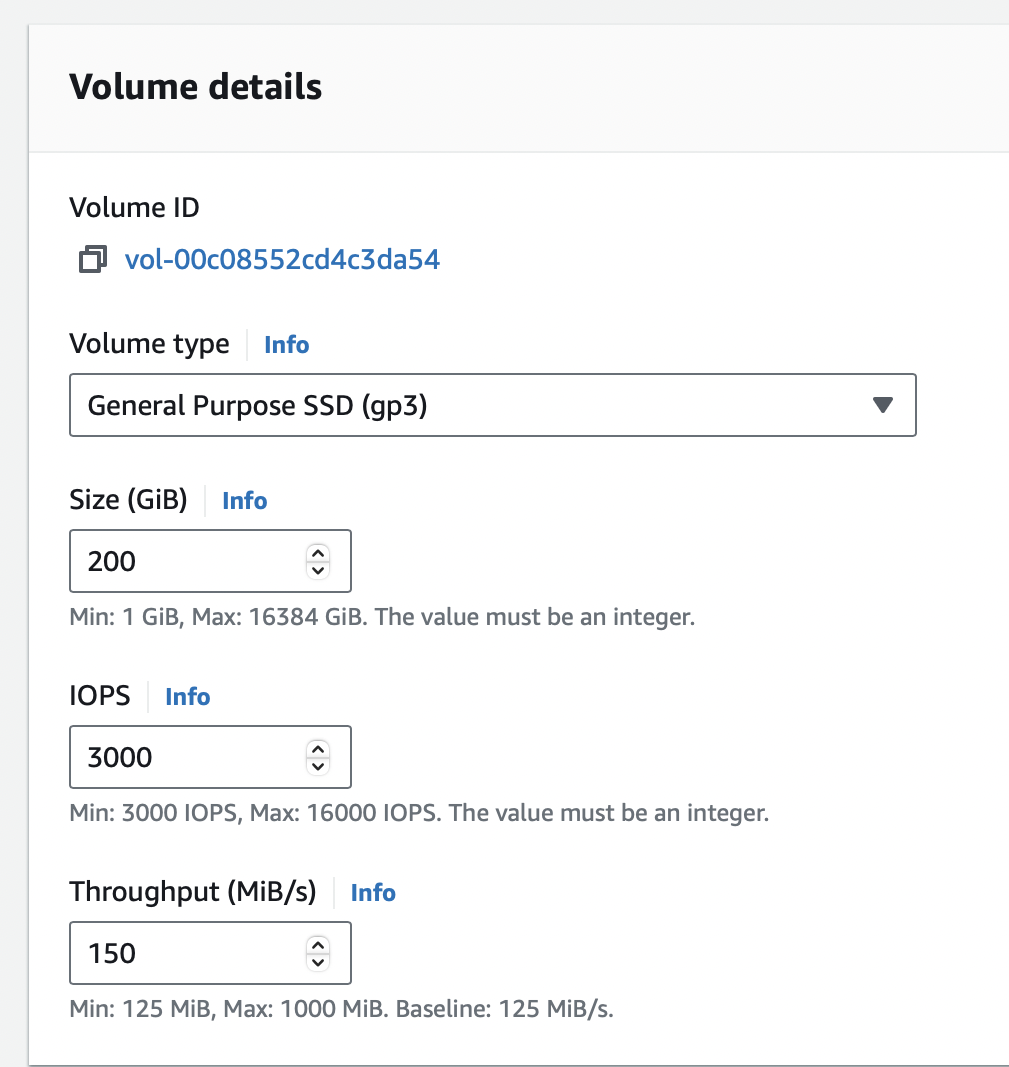

- Volume details

- Volume details

Volume details

Volume details

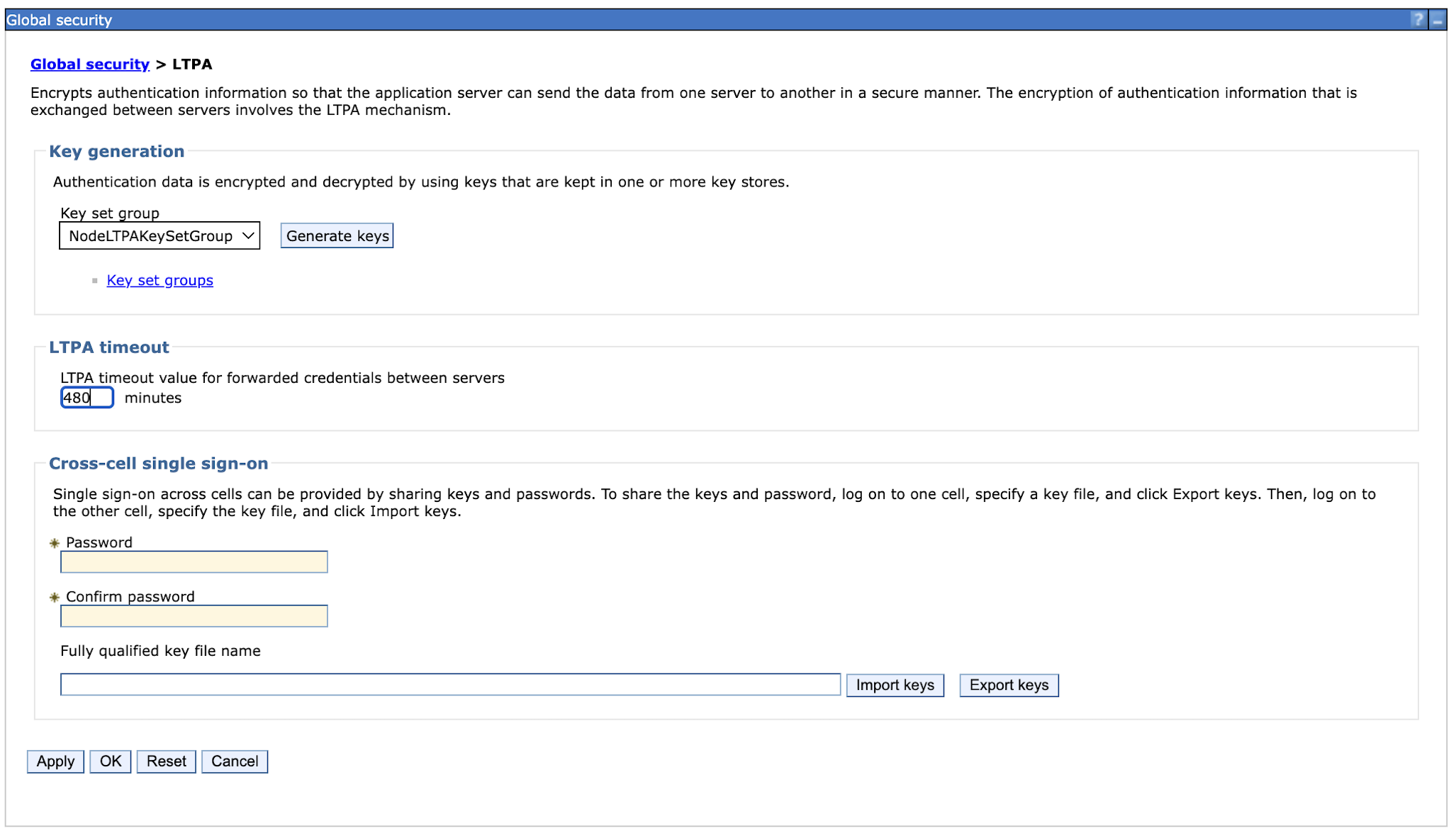

Increased the LTPA token timeout from 120 minutes to 480 minutes for the rendering tests.

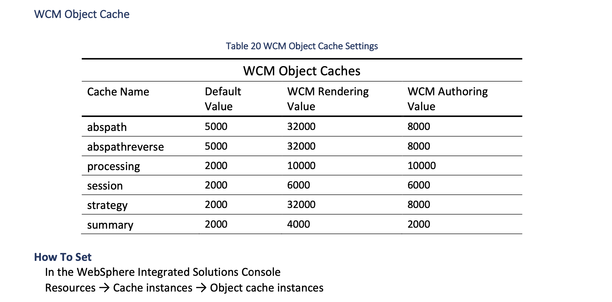

Updated the WCM object cache for rendering. Refer to the Performance Tuning Guide for Traditional Deployments for more information.

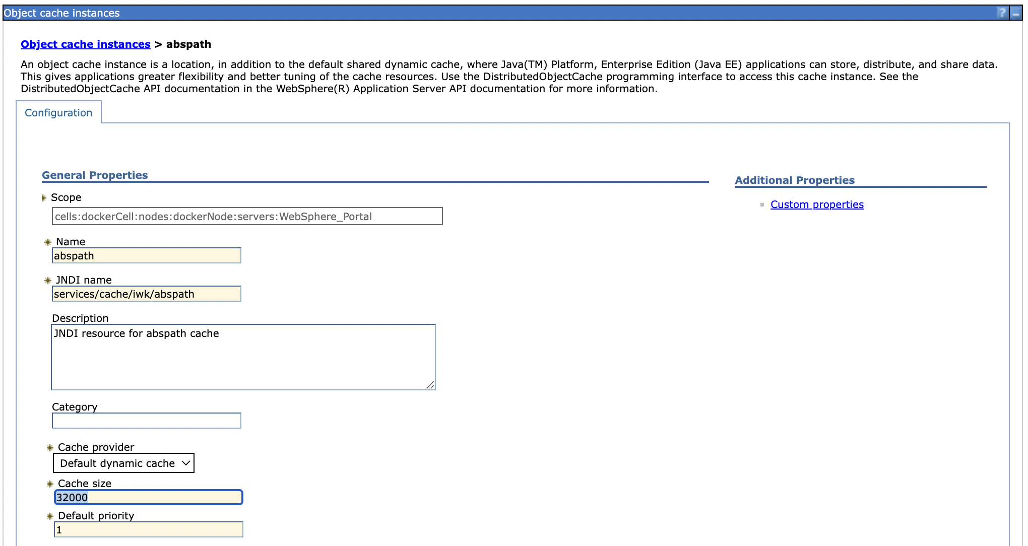

Updated abspath, abspathreverse, processing, session, strategy, summary values, and WCM rendering values as per Performance Tuning Guide for Traditional Deployments.

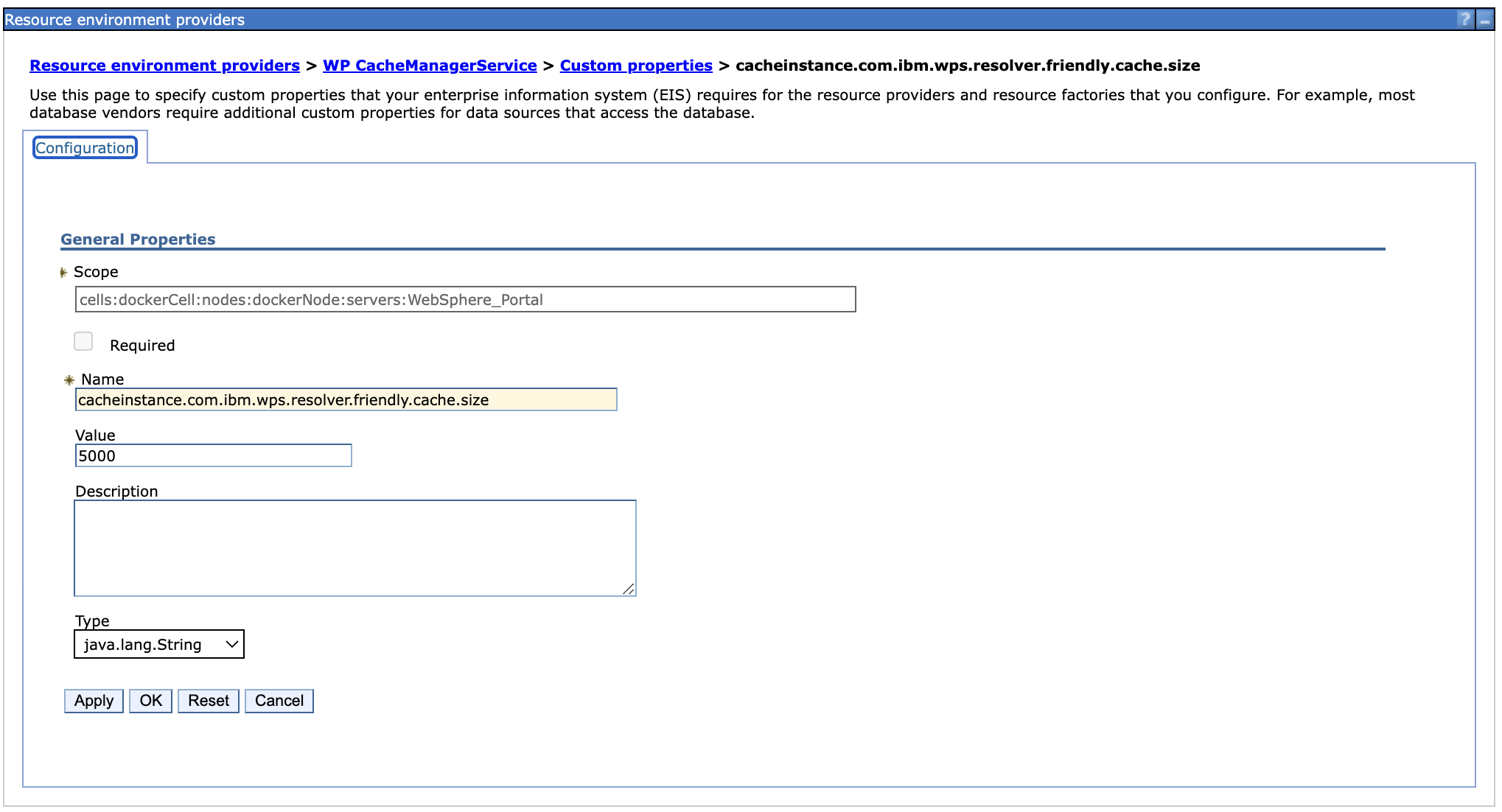

Added a new custom property under Resource environment providers > WP CacheManagerService > Custom properties > cacheinstance.com.ibm.wps.resolver.friendly.cache.size.

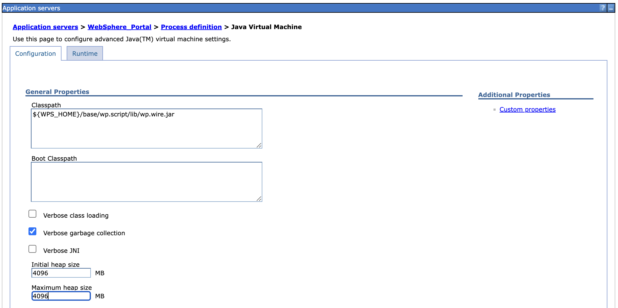

Adjusted JVM Heap size from 3584 to 4096 under Application servers > WebSphere_Portal > Process_definition > Java Virtual Machine.

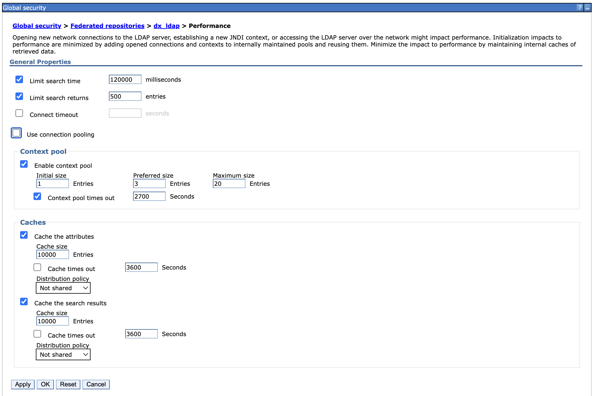

Set the LDAP user cache attributes and search to 10,000.

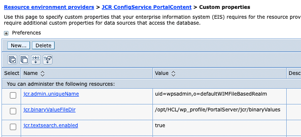

Disabled jcr.text.search under Resource environment providers > JCR ConfigService Portal Content > Custom properties because there is currently no authoring search functionality in these tests.

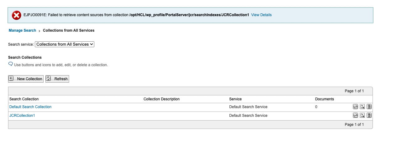

Deleted JCRCollection1 and Default Search Collection in Portal > Administration > Search > Search collections.

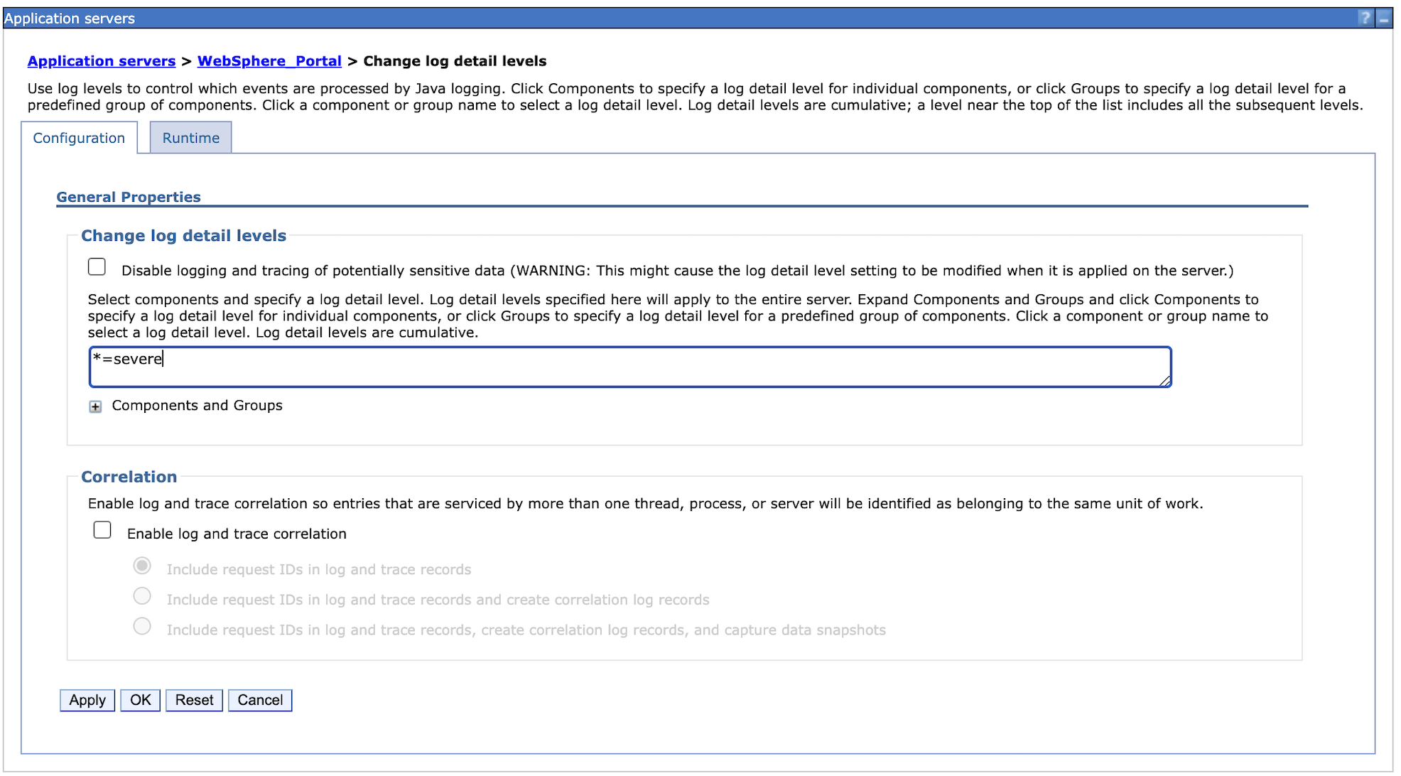

Logged level changes from info to severe in the WebSphere Application Server (WAS) for both configuration and run time.
