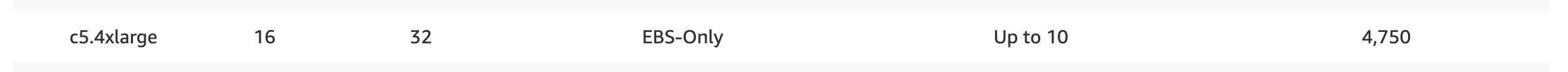

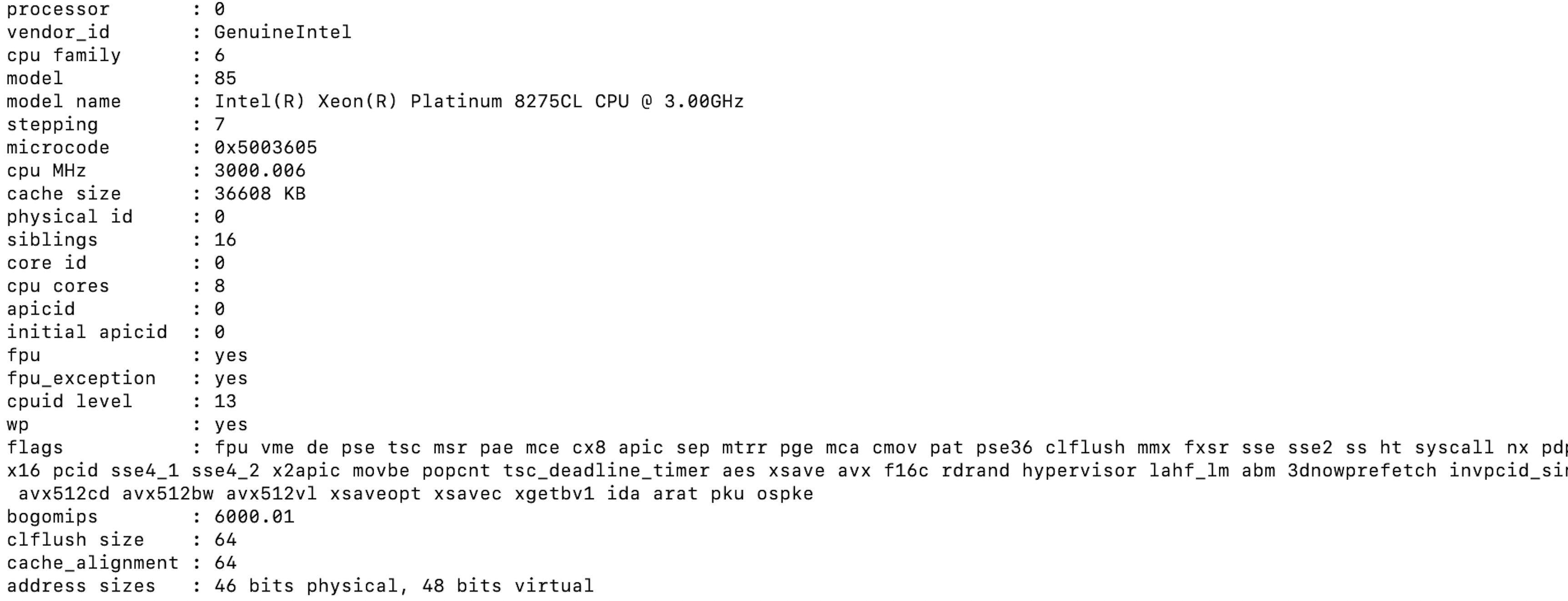

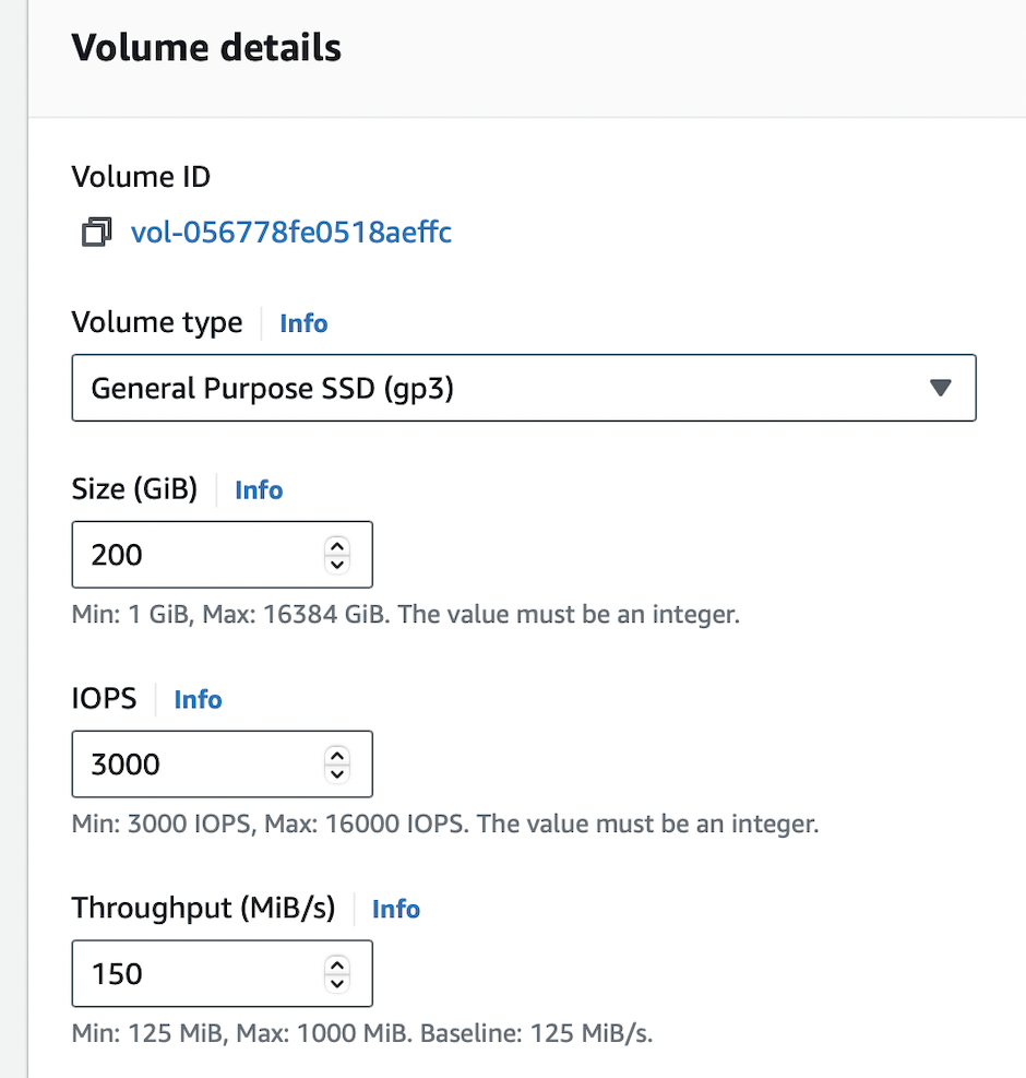

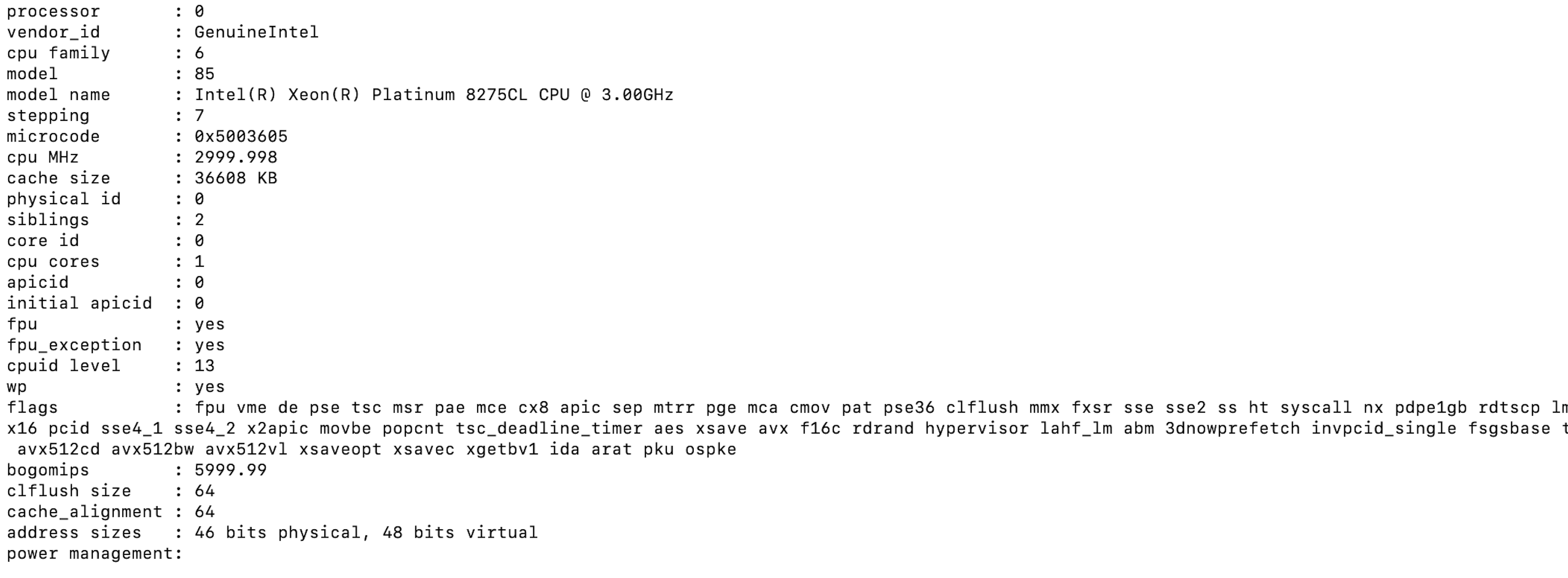

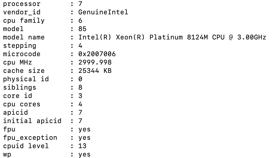

The Kubernetes platform ran on an Amazon EC2 instance with the DX images installed and configured. In AWS/Native Kubernetes, the tests were executed in EC2 instances with 1 c5.2xlarge master node and 12 c5.4xlarge worker nodes. Refer to the following node setup details:
- Node details
- Processor details
- Volume details
- Node details
- Processor details
- Volume details
