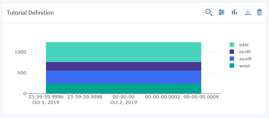

  1. On the Tutorial dashboard, click Add, , for the Tutorial Definition chart.
    The chart is added to the dashboard display area, as shown in the following illustration.
    Figure 1. Tutorial Definition chart
    Note: If you do not see your data, make sure that the dashboard's GroupBy option includes the record's execution date.
    The data values and labels reflect the value object in the record that you created in the last lesson. In the metric definition that you created in Lesson 2, you specified a bar-type chart in stacked mode. In stacked mode, the scale of the Y-axis is the sum of values.

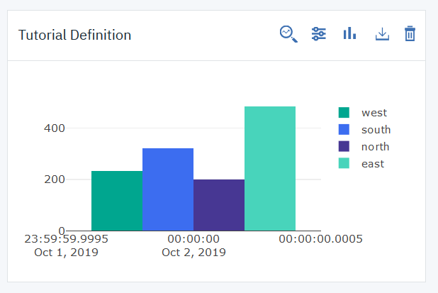

  2. Optional: In the Tutorial Definition chart, click Chart type, , and then select Grouped bar.
    The chart's Y-axis reflects the record's maximum value, as shown in the following graphic.
    Figure 2. Grouped-style chart
    Grouped-style chart
    You can also select line-type for the chart, but, unless you upload additional records, that style is not very meaningful for the tutorial's single record. All charts can use the three types.
  3. Optional: In the Tutorial Definition chart, click Filter, , and then select several values.
    The chart displays graph elements for the selected values. Not all charts provide data filters, but when they do, as here, the chart filters work in tandem with the dashboard filters. Experiment with the filters and see how they affect the chart.

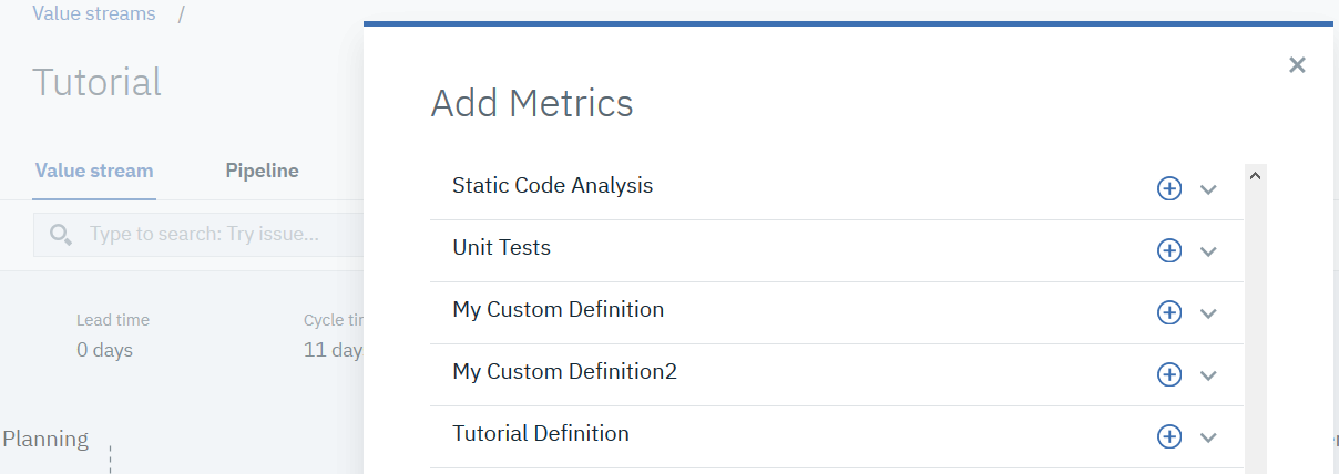

In addition to dashboards, metric data can be added to value streams. To see how this works, open a value stream and make sure that the Metric bar is displayed. Next, click Add a metric, , and then select the Tutorial Definition chart. The chart is displayed on the value stream's metric bar. If you want to see meaningful data in the metric bar chart, add the tutorial metric definition to the value stream JSON file.
