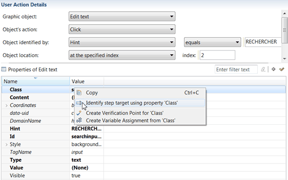

  3. Drag the property to the Object Identified byfield in the test editor. Or, right-click the property in the table and select Copy, then Paste in the Object Identified by field. Another method is to right click a property in the table, and select Identify step target using property.
    A menu item is available for each candidate property in the context menu of the SmartShot view (see Figure 2). If the newly selected property is inappropriate, a message warns you that object recognition may be broken. The property name and its value are replaced in the Object identified by fields.

    Figure 1. Modifying the object property and value from the Properties context menu
    Here you modify an object property and value with the context menu 'Identify step target using property class'
    Figure 2. Modifying the property and value of an object captured during the test recording with a candidate property from the SmartShot context menuModifying the property generated for the object captured during recording with a candidate property from the SmartShot context menu
