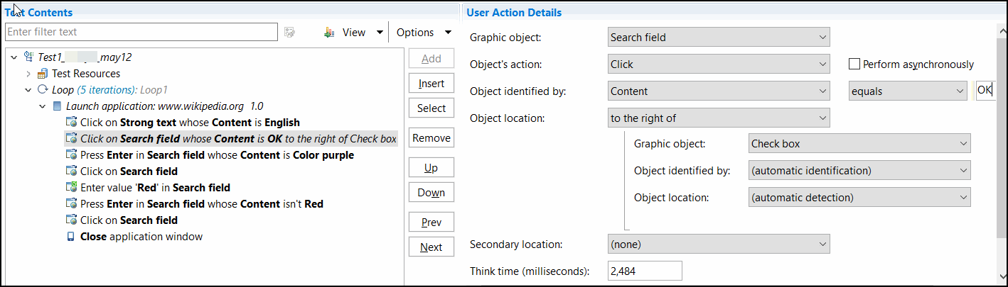

The following screen capture displays fields related to object location in the test editor:
Object locator and secondary location fields with the list of secondary location operators open
