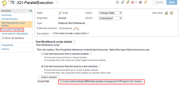

To run a test from Engineering Test Management you first define a test in RQM that includes the path to the Web UI test. You then configure and run the Engineering Test Management adapter that is installed by default when you install HCL DevOps Test UI (Test UI).
Using the Test Workbench script details page of a Engineering Test Management test script,
associate a Web UI test script with the Engineering Test Management script as shown
below:
Be sure to specify the value in the Script Path field to be the path to the Web UI test script. For additional details, see Creating a reference to an automated test script on a local test machine.

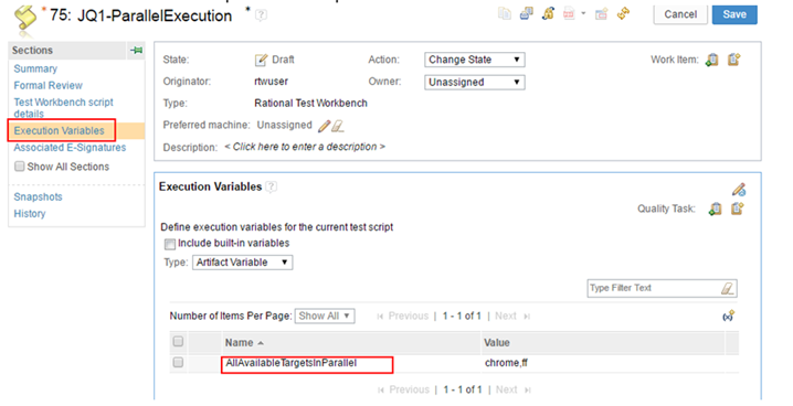

To run the test on a set of browsers or on all browsers and connected mobile
devices, go to the Execution Variables page of the Engineering Test Management test script and
specify the execution variable to pass to the script.
- Save the test and run it using the Engineering Test Management adapter.
